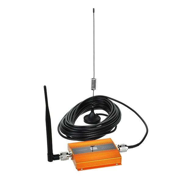

So will the new wave of boat upgrades include cell phone boosting antennae on the tops of our masts? :biggrin:

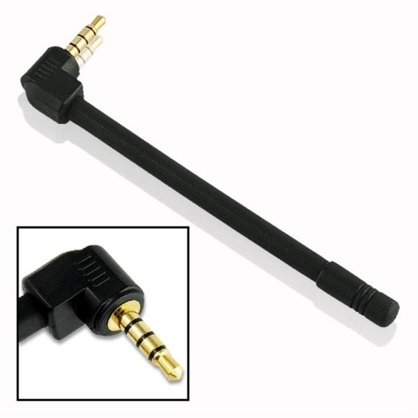

I think that tablet has a traditional phono jack so a simple antennae like this would work for that..... very simple and no extra installation needed.

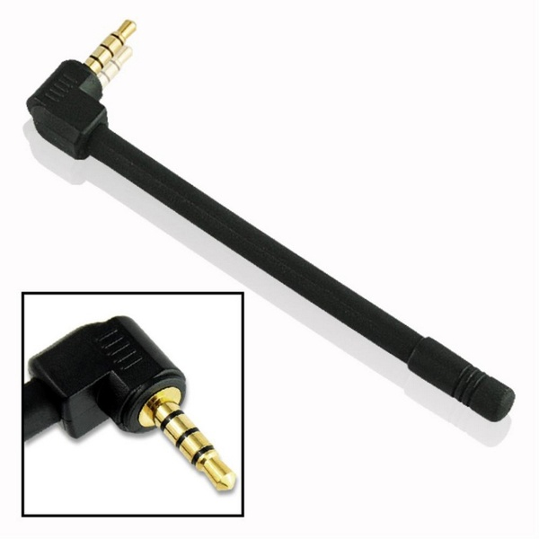

My friend’s comments: Cell phone boosters can work, but they are much better in a fixed location where you have rf shielding that is causing the loss of coverage. The booster is a bidirectional rf amplifier. It works by amplifying the cell phone tower signal picked up on the "outside" (mast top) antenna and retransmitting it on the small "inside" (cabin) antenna near your phone. When your cell phone transmits, another amplifier goes the opposite direction and sends your signal "outside". This is an inherently unstable situation. If the "inside" and "outside" antennas can "see" each other, the system will go into feedback oscillation. The cell phone companies hate these things. It might work well if you had a steel or aluminum boat. To make it work with your boat would probably require getting the inside antenna so that it cannot transmit in the direction of the outside antenna. Some interesting copper mesh or foil with a good ground might do it. I know this subject because I have used these systems in television equipment rooms where the shielding was pretty much 100%

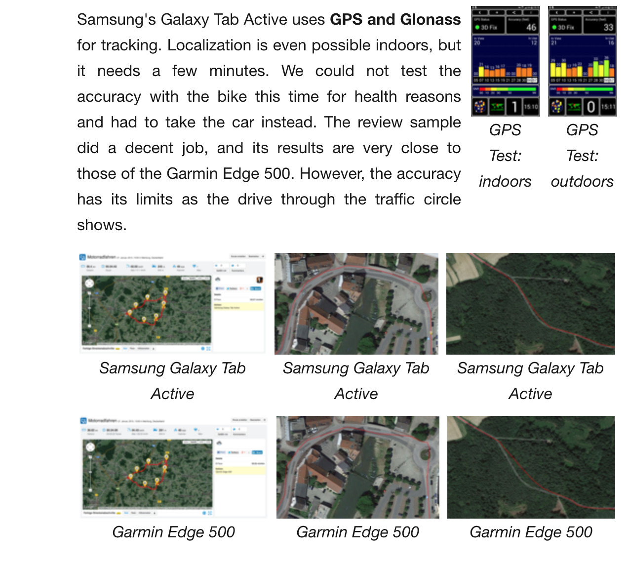

Update: I got my Samsung Galaxy Tab Active Pro and installed Inavx and predict wind. I compared the GPS data to my iPad using only wifi connection. First thing I noticed was my altitude was way off! 500 on ipad 100 on Samsung. Checked compass for calibration as that was off. So I took to another sea level location with no wifi and could not see location in maps or inavx. Read articles including article below and then learned the difference between GPS and Glonass and that almost all devices say they have GPS but they don't actuallyy connect to satellites! They triangulate. Samsung support said GPS won't work without wifi and or cellular--Non-starter. But the article below contradicted it.
So I am returning it...Then I read that the big winner which has GPS that actually talks to satellites in the Nexus 9. Back to drawing board.

I'm surprised about that, I think I'm in good shape with a true GPS chip because I bought a used/refurb 2018 Galaxy Tab A that was originally a Verizon tablet that allowed cell phone data connection. I've used it as a big GPS in my car and it does a good job tracking me on local and interstate roads, just as well as my stand alone GPS and cell phone.
