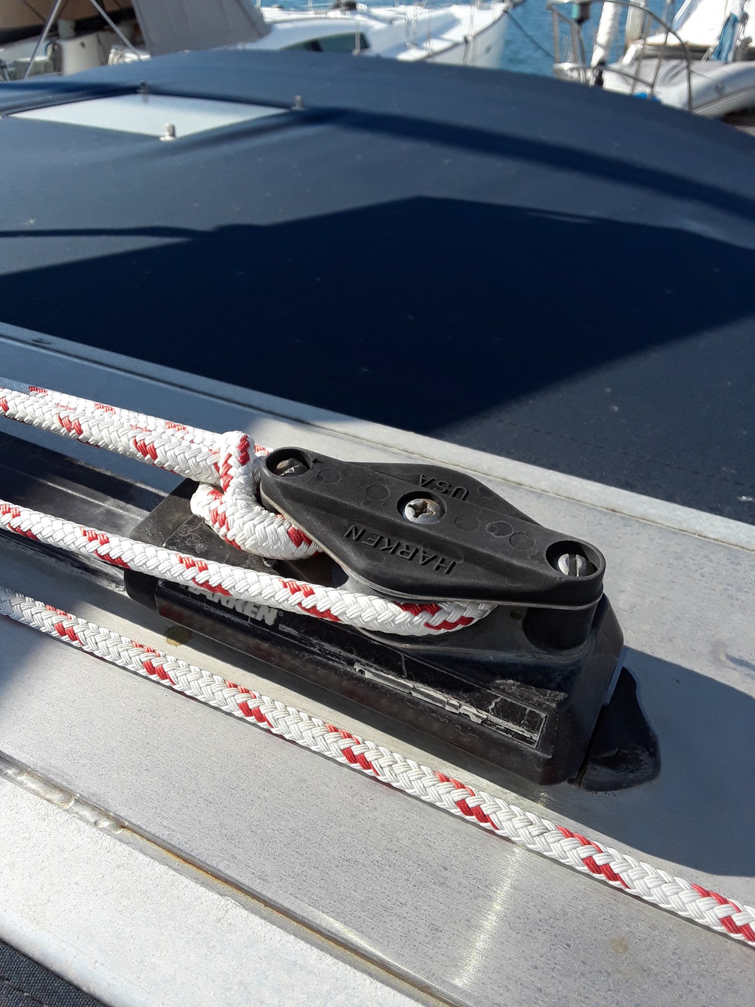

Ditto Joe. Curious what features you are looking for....and why? Reason I ask is I might replace my traveler since the screw on one side seized and cannot unscrew it to properly attach the traveler line. I am considering Garhauermarine, Lewmar and Harken travelers.
Can you post a picture of the issue? Be terrible to spend the money for a new traveler if there is a fix. Or maybe you just want a new and modern traveler. That would be cool.

Attached is a photo of the port side traveler. The seized bolt is the inner one where the traveler line eye would normally be attached. I tried penetrating oil under the bolt head without success. Bolt head softened and is now stripped. I resolved the issue by securing the traveler line as show. Traveler works fine. Since it is on the arch and I cannot see it, it will be out of sight and out of mine until drill the bolt and/or have the rigger in my marina attach it.
