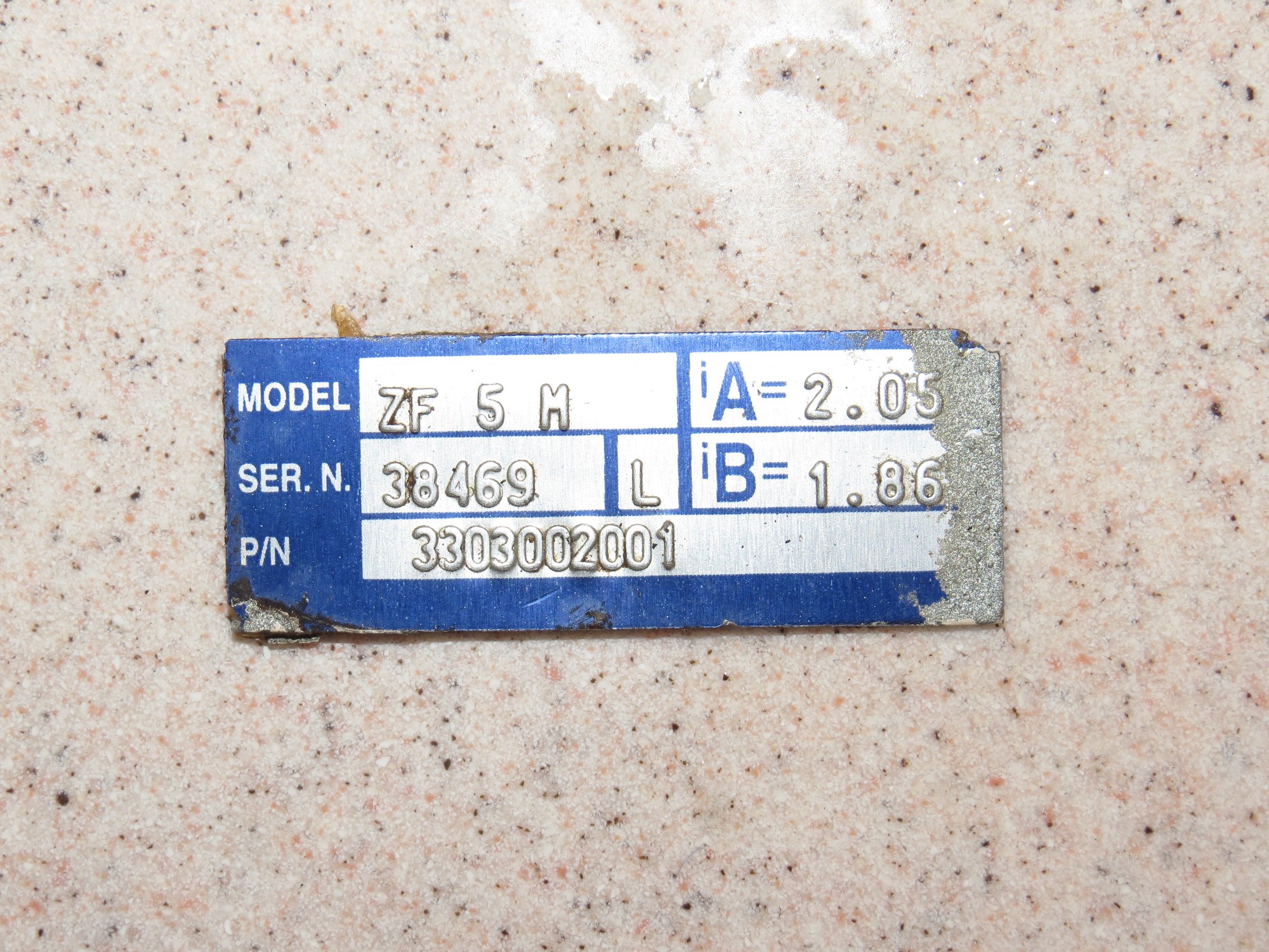

Our boat has the type of transmission oil needed stamped on the bell housing, which was ATF. User manual contradicted the service manual; one said engine oil the other said ATF. The PO used engine oil. I replaced it with ATF. Used a vacuum pump to extract the old oil.
Our dip stick has a small ring mark about one 1/8" above the stick bottom, which is the full mark. Correct amount is determined by placing the dip stick cap on the transmission housing, not screwed in. No filters involved with ours. Very easy to replace.
Here is a picture illustrating your point.
