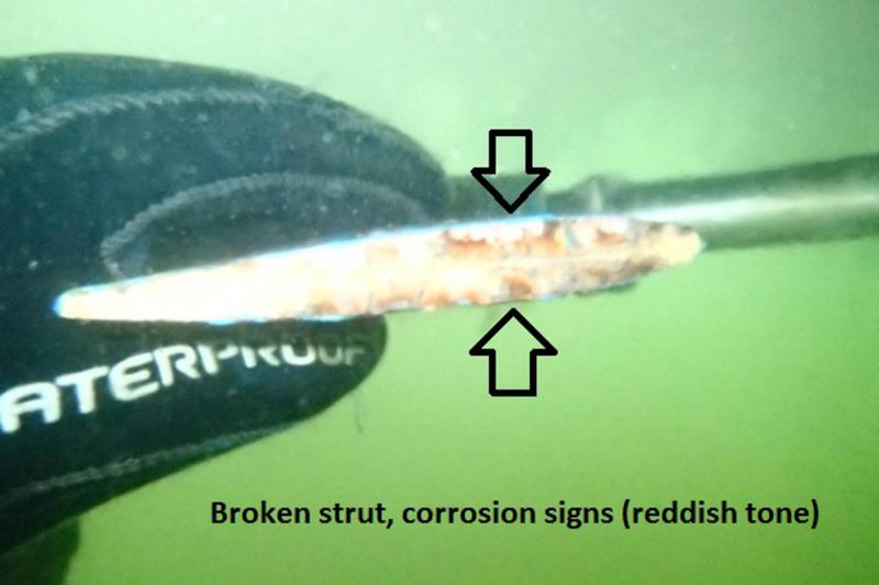

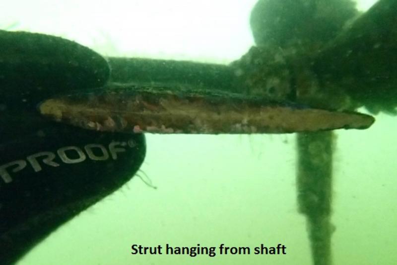

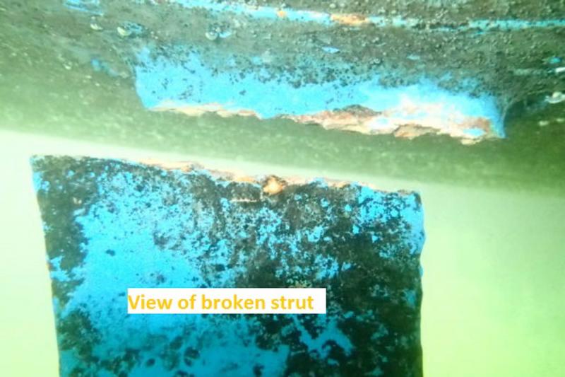

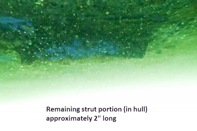

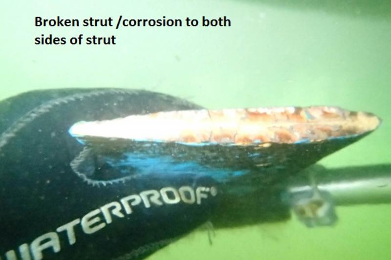

Anyone changed their Strut on a 40.5 or similar. Mine broke in half 2 inches under the hull due to what appears to be corrosion. Strange as some of the zincs had still life on the them. I ordered the strut from hunters owners and plan on doing the work next week in the week or so.
Any advice is welcome.
here are some pics... check your strut too.
