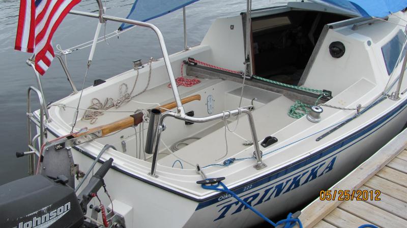

I had that same set up on my 1986 O'Day 222 and I hated it. The reason that your mast didn't fall forward is probably because your side stays are anchored about 12" aft of your mast which is a good thing.
I saw a Santana mast fall over the bow last year when the owner removed the backstay to straighten out a twist at the top of the mast. Nobody expected that to happen and I guess the proper procedure to follow that day would have been to just let the mast back down aft and straighten in out.
Anyway, I went out and bought an el cheapo traveler and mounted it in front of my companionway. I had the guy at Rig-Rite move my open turnbuckle up on my backstay and mount a Johnson Handy-Lock under it to the chainplate.
This adjustable gadget is both a work, and time saver. I'm not sure if this gadget would throw enough slack into an O'Day 23 fore stay so that you can remove it but this is what I mainly use the JHL for.
The advantages are: I never need to mess with my side stay adjustments whenever I need to lower my mast. I can disconnect my roller furler in less than 10 minutes with this gadget. The JHL is pricey but any type of adjustable lever type turnbuckle that can throw enough slack into a forestay may work on the 23. If you can remove your forestay by loosening your backstay turnbuckle, it will work.
The disadvantage of having the traveler mounted in front of your companionway are pretty obvious. It cuts down on seating space and you need to step over it when you go in and out of the cabin.
The advantages are better pointing and sail control. You can move the boom out of the way when the sail is down and covered. This can enable you to get your gear in and out of the cabin like the 50 quart cooler. Also, you can stand at the helm and motor without having to worry about getting conked on the head by the boom.
Myself, I think it's a good trade off on my boat. Last year I bought a Harken Traveler and got rid of my old traveler. If you opt for a traveler, get a good one. You won't be sorry.
