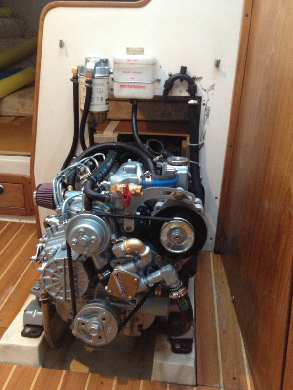

Nov 18, 2010
2,441
Catalina 310 Hingham, MA
Wow! You really have that motor looking great!
Thanks. Took all winter to pull it apart, wire brush it, decrease it, paint it and put it back together. I am going to bleed the fuel and antifreeze this am and hopefully take her for a short trip this afternoon.

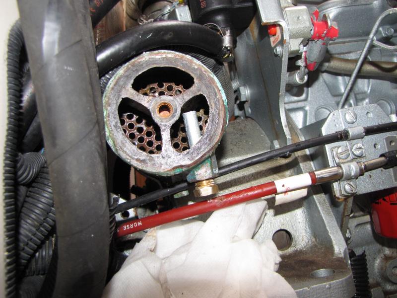

Today I remounted the water pump after checking it to make sure the new impeller had not been damaged or spun on the shaft. Only other thing I did was remove the new zinc and put the old one back in after cleaning it up a bit on the grinder. It is pumping water like a champ. So maybe the new zinc which seemed a bit tight was to long and to much diameter. There is an exit very close to it on my heat exchanger.
I have never taken a heat exchanger apart (maybe the only thing I haven't) so not sure if that's a possibility. We have owned the boat since 2007 and a least back that far we haven't lost any impeller blades into the system. My wife says to leave it alone!

Heat Exchanger no big deal
... I have never taken a heat exchanger apart (maybe the only thing I haven't) so not sure if that's a possibility. We have owned the boat since 2007 and a least back that far we haven't lost any impeller blades into the system. My wife says to leave it alone!
On either end there is a bolt. Just unscrew it and the end comes off. On the side where the zinc is you may find pieces of zinc that have broken off. On the other (port side) is where you would find the impeller vanes.

Compass Marine's site has pictures of what you are describing. I see what you mean so I will have to pull the end off and see what it looks like in there.
