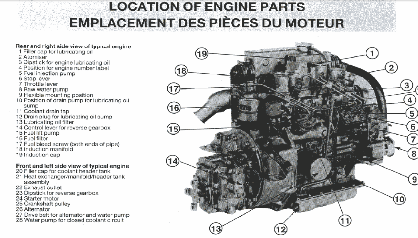

You can pump out most of the oil through the dip stick tube. You may need an extra long suction tube for the vacuum pump. Make sure that you don't try to suck the oil when it is really hot - the suction tube can get stuck in the oil pan.
Btw. the Perama M20 has a special port/tube on the starboard side through which you should be able to suck all the oil. You would need to make sure that your suction tube is well sealed to that port.
On the attached picture, this is the item #10. This is a screen shot from the pdf of the manual.
