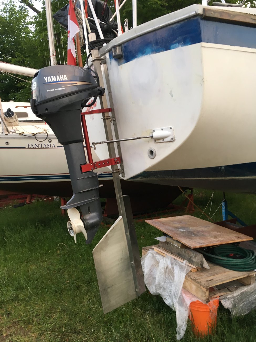

I think I have a good final design now. I will post my progress. The rudder is controlled with a cable and wheel and the motor won't tilt up, it is fixed in the water ( much like my current saildrive).

Well folks, after a winter of tinkering I have finally come out with my rudder mounted outboard motor (see photo). I will piece together a video shortly. I will be launching on Saturday so I'll have some sailing experiences the following week.

Congrats Pete. It will likely work as a motor driven boat, I will be interested in how it works as a sail boat. I wonder about the size of the original rudder compared to your new rudder. I know my 15ft Montgomery had a bigger rudder than what is shown in your picture.
I await the big test with anticipation.

This new rudder has slightly more square inches in the water than the original

Here is my idea - I know you'll have to think "out of the box" but it is worth considering.
The first is my current configuration with the sail drive; the second is how I envision the new rudder. The shaft going to the top of the transom is for an emergency tiller, otherwise the steering is with a cable.
(I think you'll have to rotate them 90* left)
That's an awful lot of stress for a transom hung rudder. All of the weight and force from an outboard will be focused on just a few square inches where the gudgeon attaches to the transom and the attachment of those gudgeons to the rudder itself. If it's a foam cored rudder that's going to be a lot of time to reinforce it. I think it'd be ok for a backup trolling motor but not a 9.9 four stroke weighing in at over 100lbs.
Another thing to consider would be to build an adapter plate and mount a 4 stroke vert shaft engine in the same location. It would be air cooled so would need a ventilation plan and the issue of the hot exhaust would have to be worked, maybe using the foot mounted water pump to cool it? Still would be gasoline, but wouldn’t smoke and would burn much less fuel. Harbor Freight has one for about $750.
My neighbor at the marina is in the process of doing this to his O'Day 28 now. He machined a massive mount and bought a shaft adapter to couple an air cooled harbor freight 4hp engine to the old lower end unit. The engine ran about $120. His plan is to use it as a backup.
I'm in the process of servicing my own saildrive right now and have found that most parts are available and working on the motor is pretty easy once you know it's quirks. This thing runs like a champ. Feel free to message me if you're interested in working on yours. If not, I may be interested in your old one
It is a lot of weight 87 lbs for the OB and there will be force applied to the transom. It looks like the SS Bar runs the full height of the transom and if the transom has a large backing plate inside, I suspect it will be ok. Only the owner will be able to decide if it is working or tearing the back of the boat apart.

I've made a whole new gudgeon plate with a backing plate on the inside. The transom is plywood. Also I have the old motor and do it for sale.

I think Davidasailor is correct. Mounting an outboard on the rudder does not seem practical, but using a connecting rod between the rudder and the outboard would give you the maneuverability you are looking for.
I did that on a previous boat. Connecting rod from motor to rudder, and another connection point on the transom. So I could lock the motor to the transom when sailing or to the rudder when I needed the maneuverability under power. The rod was made for fishing boats to connect the small trolling motor to the main motor or outdrive. I think I got it at WM but that was 30 something years ago. Wouldn't be hard to make your own though.

Interesting project. Im curious to hear how it works out. Seems like a very small rudder area, and a huge amount of unbalanced weight on the steering when healed over. I think under sail the steering feel will be seriously diminished. But really nice under power. Also, looks like awfully small bolts holding the entire assembly on when you go full reverse (or, run aground, or ding when loading on trailer).
(edit) The red bracket looks really well thought out. I was wondering how you would attach the motor to the rudder. How is the throttle and shifter controlled?
