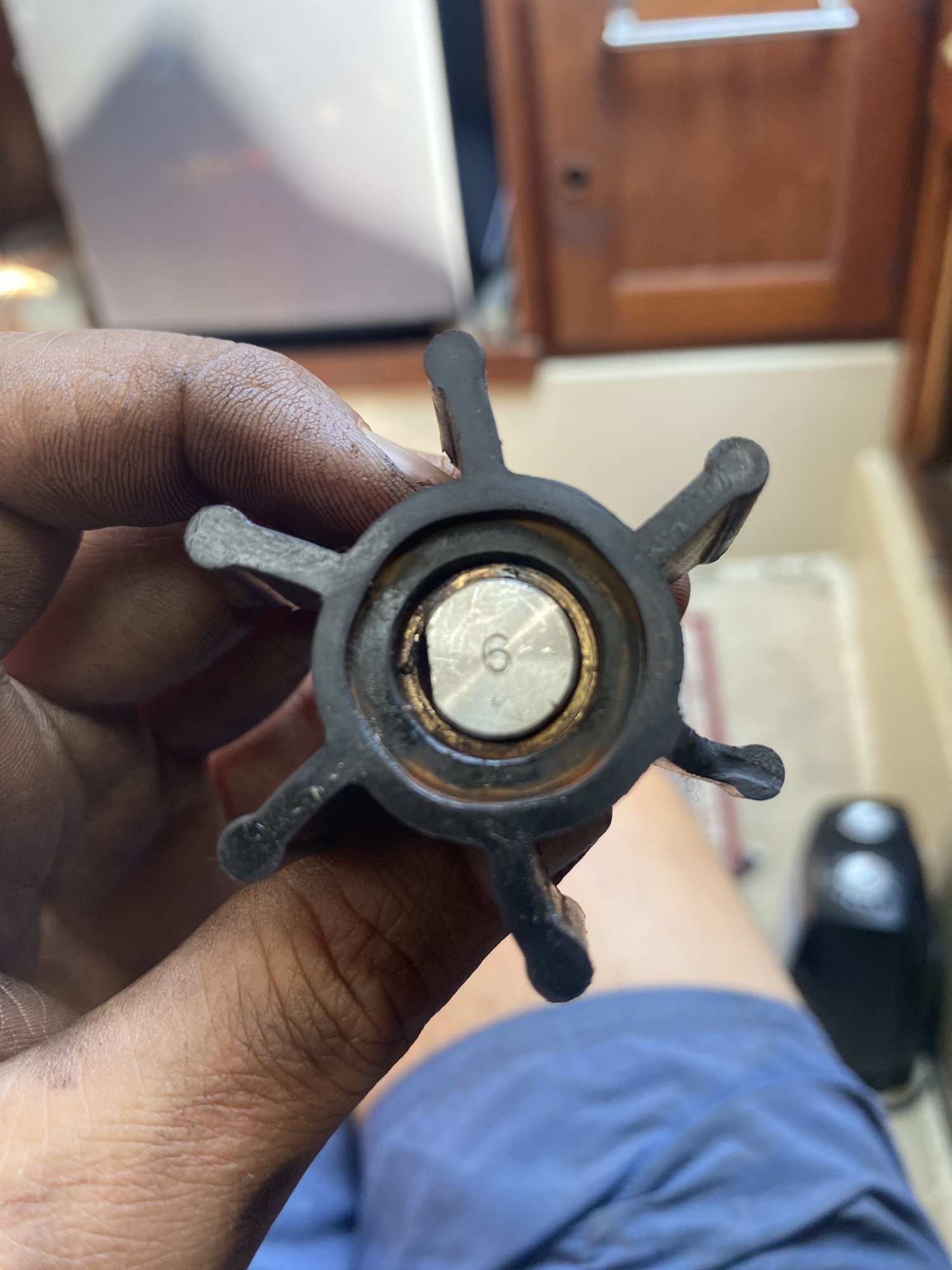

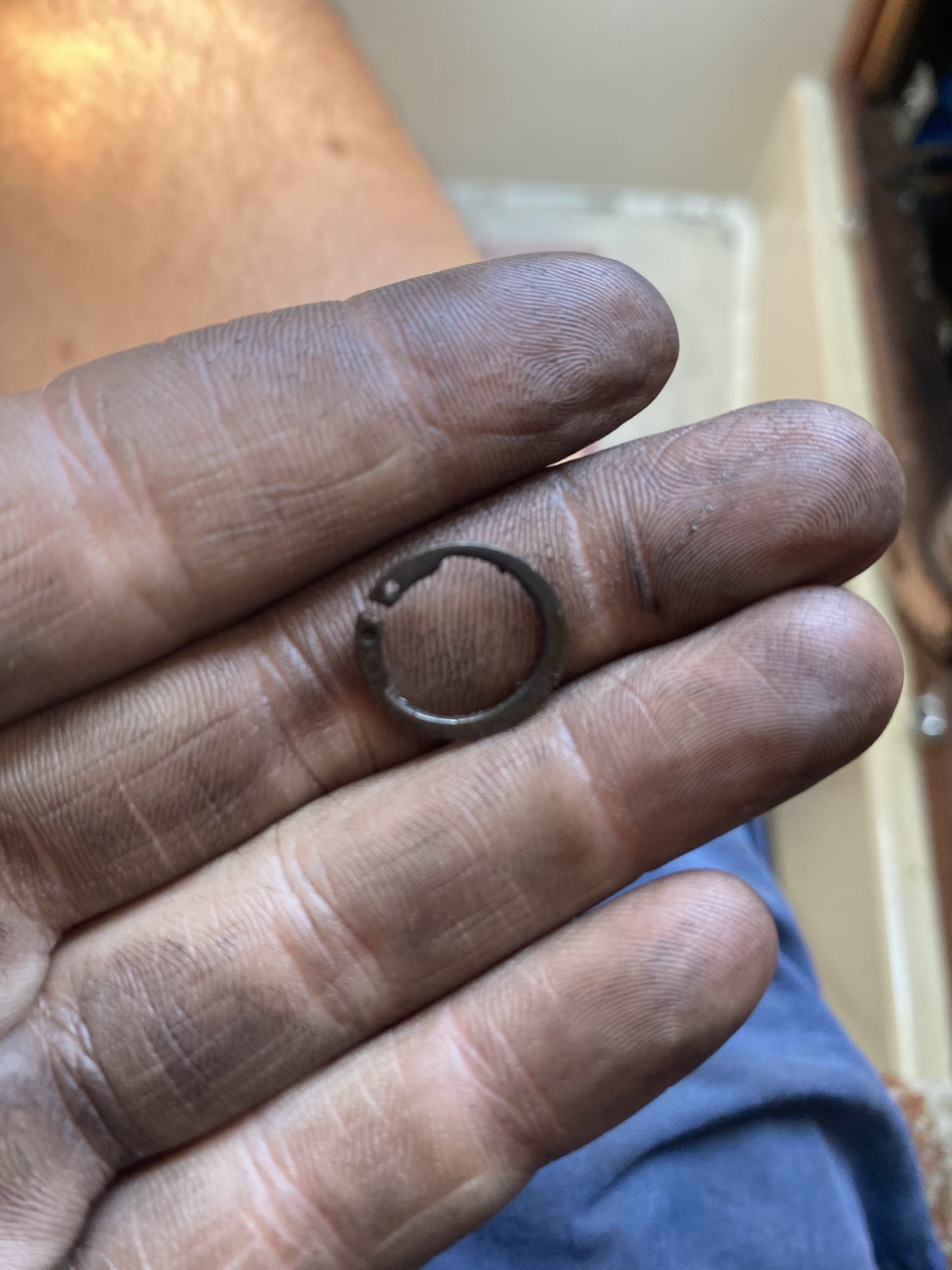

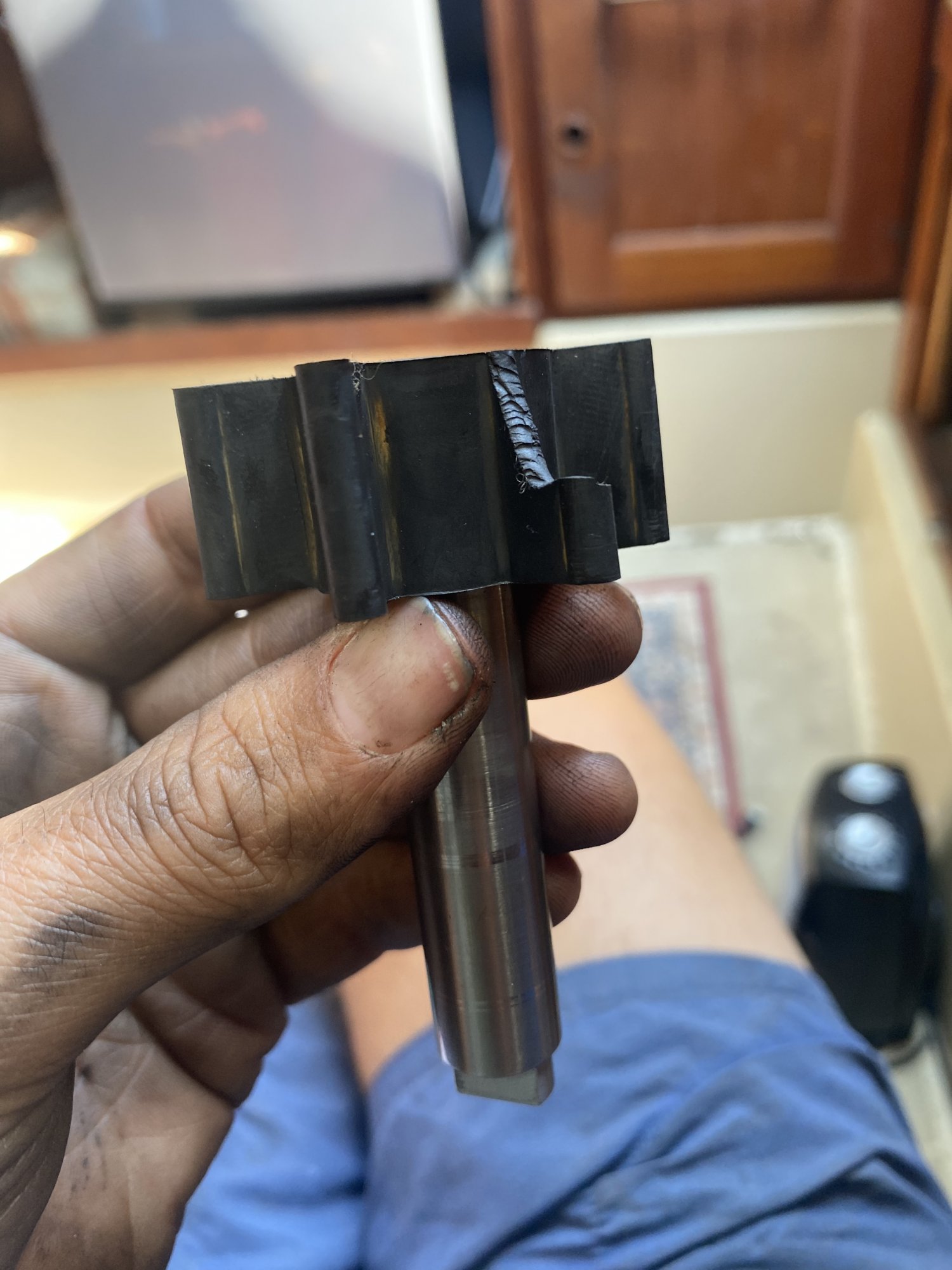

Hey all - I’m trying to replace the impeller on my Oberdorfer (the late one with the male shaft end). I’ve removed that little caliper but the impeller still won’t come off. It moves around on there just fine so it does not seem like a corrosion issue, just stuck on the end. Any ideas?
