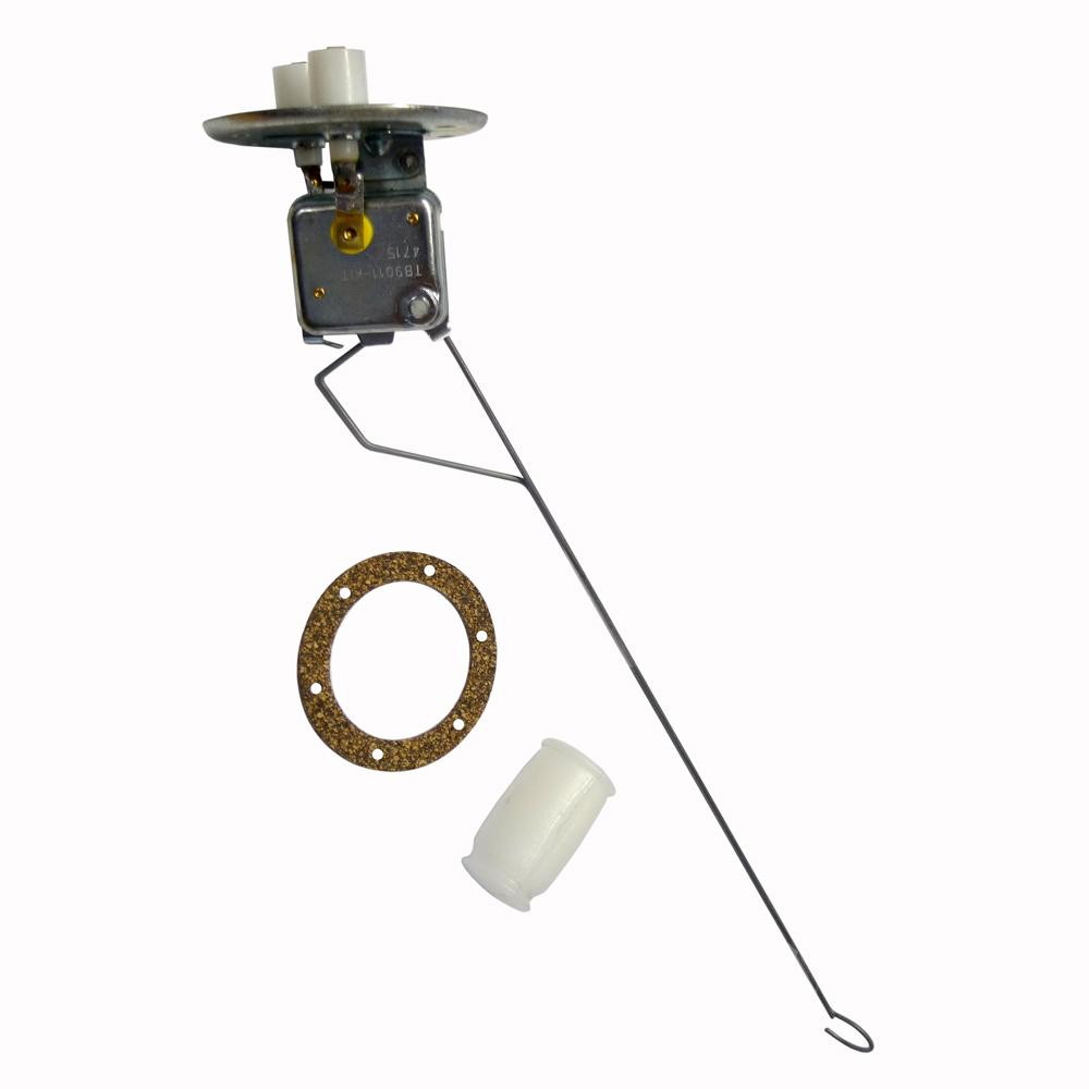

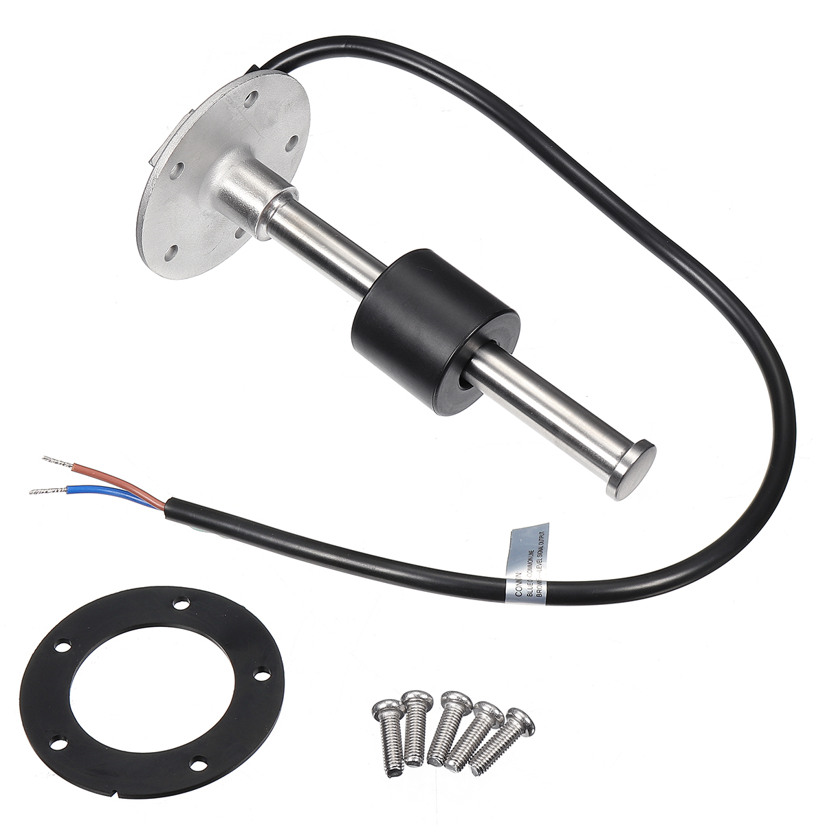

Once removed I tossed and replaced with one that looks like this.
Important to get hole pattern on the tank to match with the sensor to properly mount.
Enquiring minds want to know, how does the float get to the bottom of the tank with the rod that short ? My WEMA sensor is about 20" long to get to the bottom of the fuel tank. Fortunately, unlimited overhead to remove the sensor.
