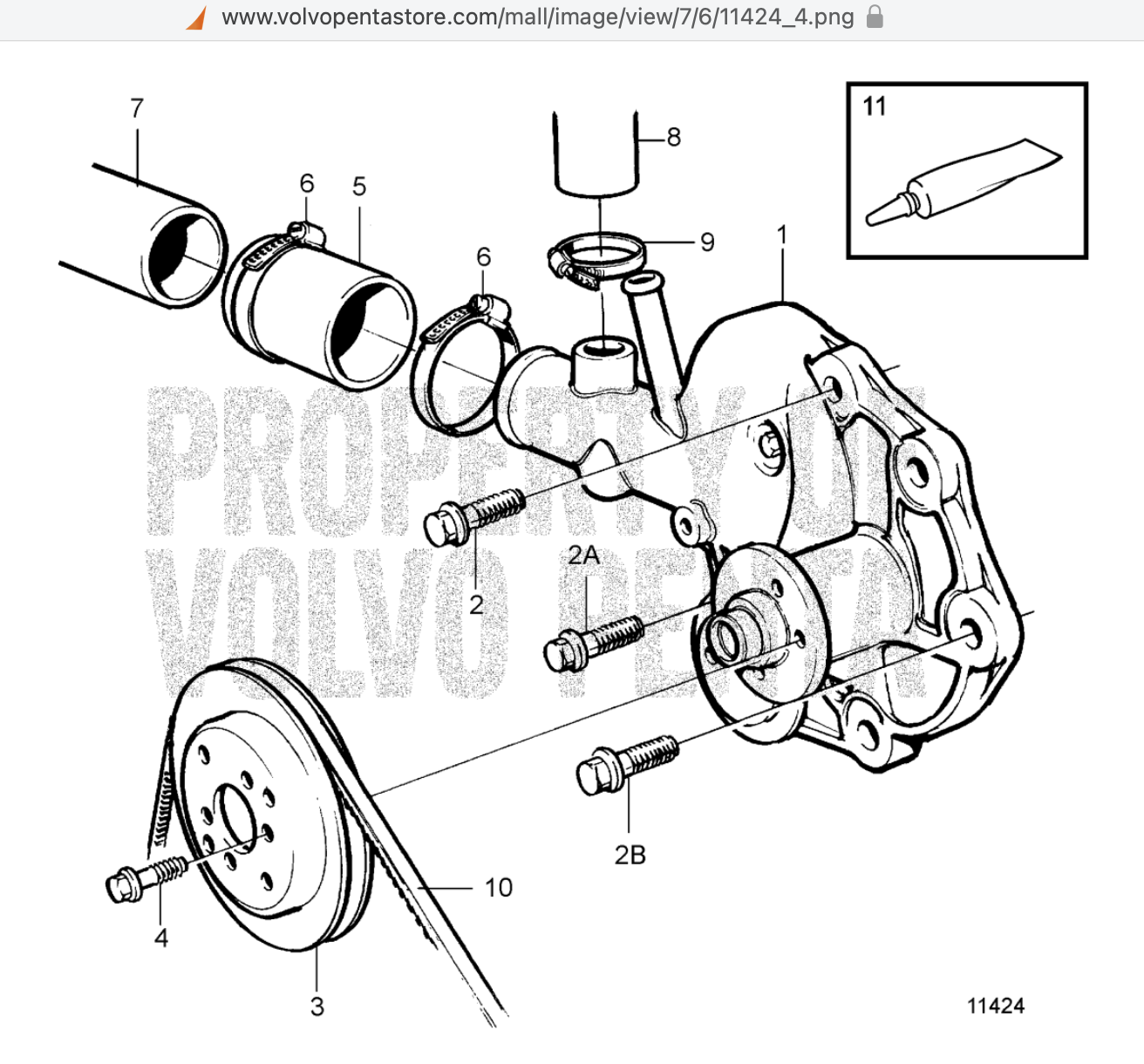

JamesG161
Feb 14, 2014
8,033
Hunter 430 Waveland, MS
Or is this the Pump... I hope not because changing it is a PITA!
