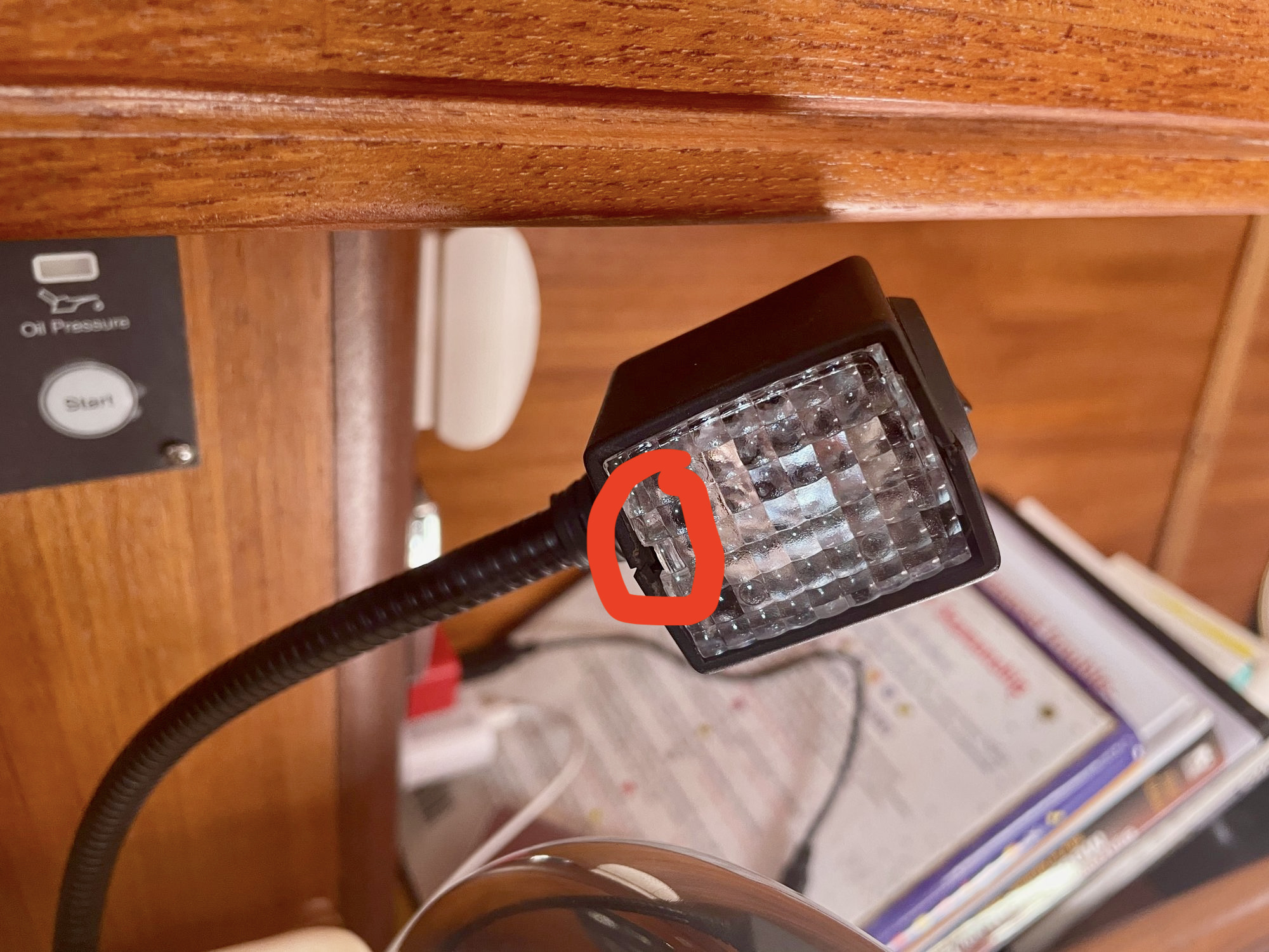

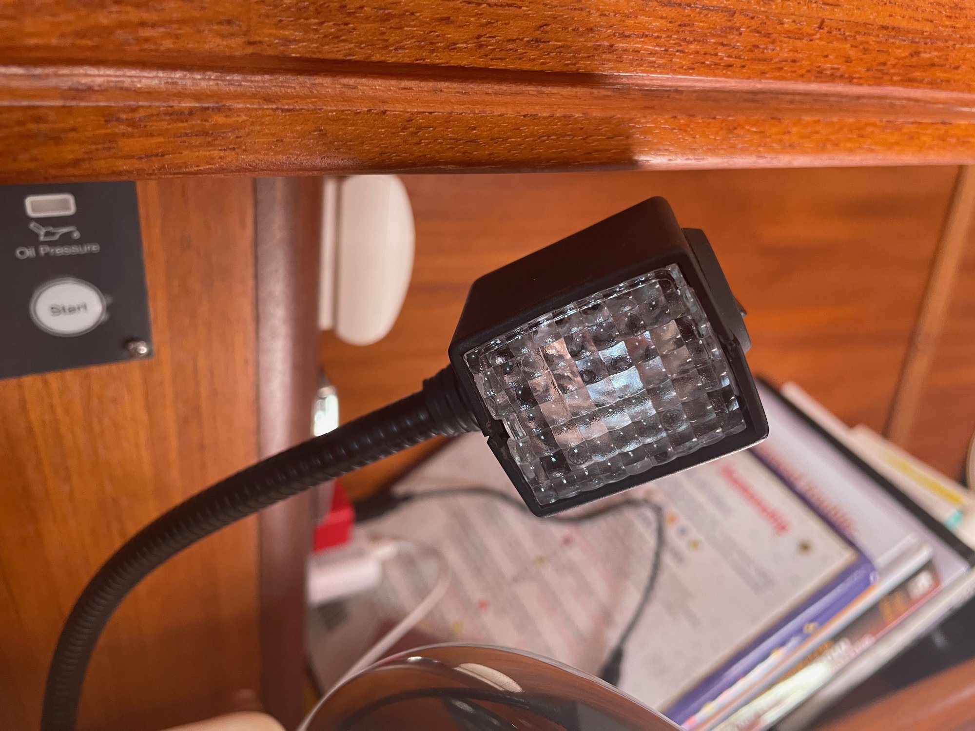

How do I change the bulb on the gooseneck map light on the nav station?
I don't see how to get it open. I'm cautious about prising the lens off in case I break it
Thanks
23,789
so it is just a pry off/pop off lens?
Yes... carefully. I would attempt in the notch shown in your image.
Either the pick or a small straight slot screwdriver
If the plastic is aged it may crumble. Just happens when plastic ages in the sunshine.
