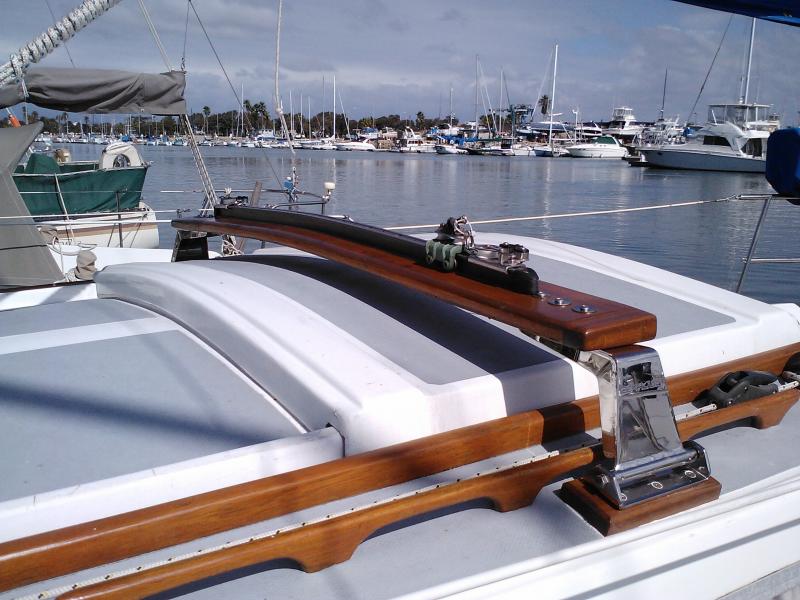

Mid boom traveler
I bought a track system at a boater yard sale for $20, Then bought the risers from garhauer for $160. I thought it was alot until I saw how nice they were, worth every penny, Made a big difference in the cockpit

Buzz - that looks very nice. For now I think I will forgo any purchases of a 27.
