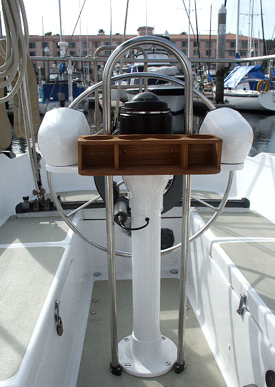

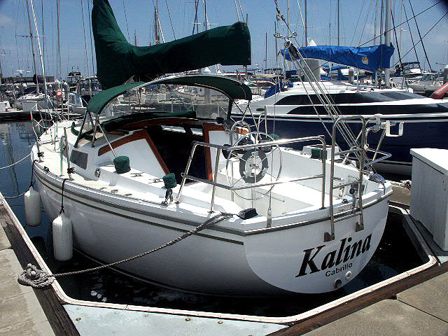

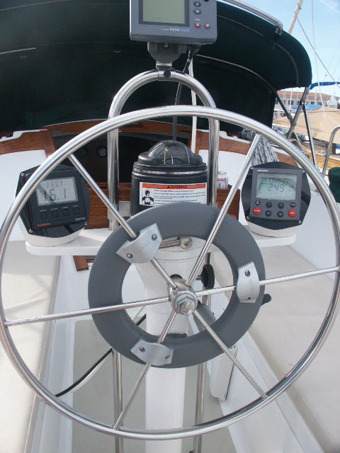

I've done it. I was a steering specialist at Columbia/Coronado Yachts and at Capital Yachts, probably installed around 50 systems all told, well make that 51 if we include my Catalina 30 (originally tiller steered). I've done rack and pinion push/pull systems, quadrant/sheave cable systems and on my C-30, a radial drive/conduit system.
Rather than wax poetic about myself, what would you like to know?
Expense can be anywhere from reasonable to obscene depending on where you source your system. New from Edson expect around $4K and that's just the parts. I bought mine from a salvor. It was originally on a Catalina 30 totaled in hurricane Charley a few years ago. Complete system excluding the autopilot and instruments (but including the instrument pods and compass) = $400.00
Related projects on my conversion were:
  • As Stu said, plan on relocating the engine instrument panel and shift and throttle controls. The old locations will require filling and cosmetic repair.
  • If your traveler is mounted to the cockpit seat as was typical on early tiller steered models you'll be relocating it to the cabintop and reconfiguring the mainsheet.
  • There's a stuffing box that should be installed on the rudder tube where it will be cut under the quadrant or radial drive. This requires at least a partial removal of the rudder. Full removal of the rudder will make things easier including drilling the index pin (bolt) for the quadrant/radial drive.
  • For a professional looking finish you'll have to make a shroud to cover the works in the quarter berth.
I would never consider this conversion if I were buying equipment new and paying professional rates for installation. Such an expense including all the possible side issues could easily approach $10K.
