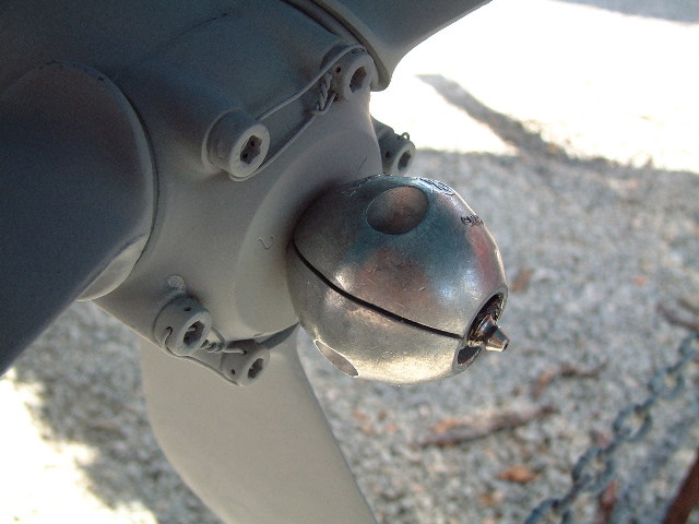

The zincs are not easy to find and are very expensive when you do find them.
My solution was to machine a piece of stainless and fasten it to the existing zinc post on the prop. Then attach a standard 3/4" prop zinc. Cost savings- about $35 per zinc. It might be ugly, but the fish don't care. I've used this for nearly 10 years.

Bob-

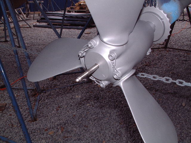

Rich,
What type of paint is that on the prop? I've used all kinds in the past with no success. I have and Autoprop which is similar to yours. Thanks.

Bob-

Rich,
Lee
The coating is Pettit Zinc Barnacle Coating. It comes in a spray can for about $18. You apply 4-5 thin coats and one can will last for two years.
I have tried all kinds of stuff from cheap to outrageous and the zinc spray does as good a job as anything else in my area. And it is very easy to apply.
BTW, last year I bought a can of "Cold Galvanize" at the local Ace hardware store. According to the label it is nearly pure zinc (about 96%) and that content matches the Pettit Zinc Barnacle Coating. So I used it instead of the Pettit figuring that if it didn't work I just wouldn't use it again.
Well, the performance was just as good as the Pettit. So now I'm buying the cold galvanize for $6-7 per can instead of the Pettit at $18.
I just love cheap stuff that works.....
