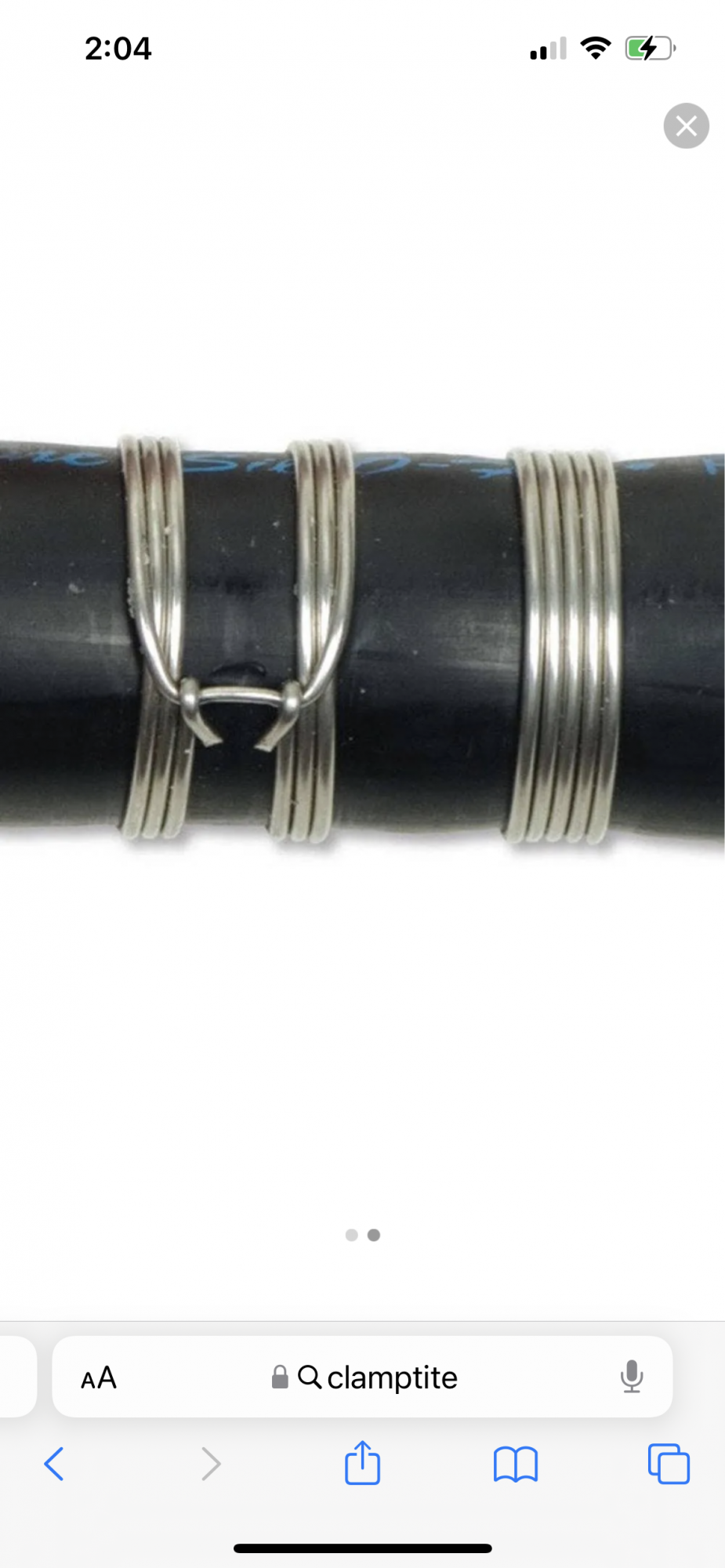

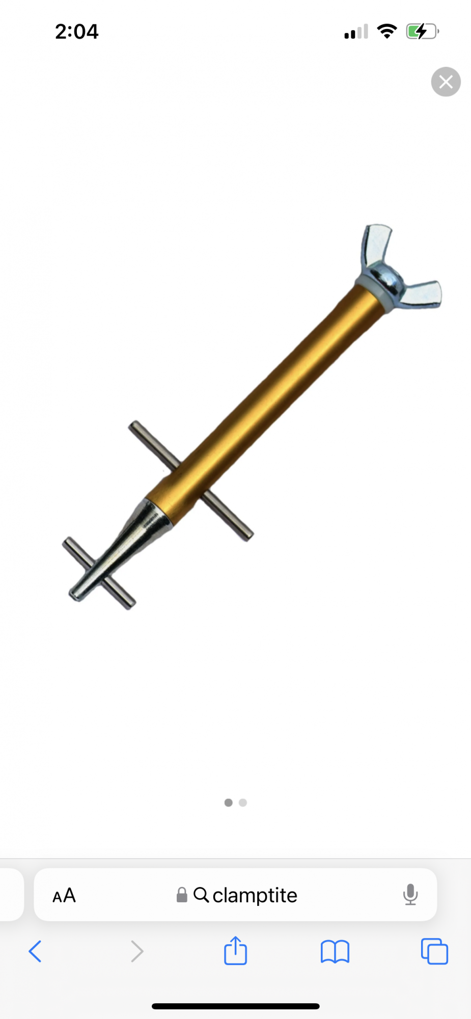

No more….I use a tool called Clamptite
It permits you to make extremely strong hose clamps out of simple stainless wire.
It is super low profile, and will fit right into the hole.
The tool has been on board for many years. It has many purposes; this being an excellent excample

Yes,,, the clamptite worked perfectly.
You want to use a slightly thicker guage wire than what you’d use on a smaller hose.
It will hold at least as well as hose clamps.
Getting off the original clamps was doable with a lot of sweat, cursing, and more cursing.
But, there was no way to get them back on to a level of tightness I’d trust for Sani hose.
With the clamptite tool, the smaller the hose, the lighter guage of wire you want to use.
Like everything else of value in my life, I bought this at a boat show. It’s a great “oops tool” to have aboard, and the cost is very reasonable

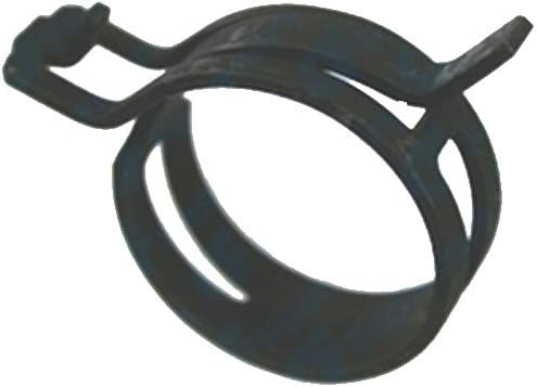

Here is a spring collar hose clamp that may be used. Available in autostores..

Respectfully this won’t work at all.
Spring steel… subject to rapid corrosion and rust.
And, it’s larger than the hole in the deck.
Nice try, but it just won’t work at all
I think the idea with these is that you can loosen the. With a pair of pliers, from underneath. You don’t need to get a long screw driver or nut driver up into the small crack that the hose runs through.
I think that they make hose clamps out of material that may stand up better than spring steel…
Something like this…
Greg
Respectfully,, here’s the issue.
The deck is drilled for the hose OD size. (Plus 1/4”)
There is no way of removing the screws that hold the outlet, and pulling it straight up, if there is anything larger than the hose.
The spring clamps that you are showing won’t fit through the hole.
My situation, like many others, is that the hose was attached to the deck before the interior was finalized.
So, while it was possible to get the clamps off, (as previously noted), there was no way to refit them without cutting a relief in the deck that the clamp nuts could pass down through
This also applies to any spring clamps, etc
This is why I went with the stainless wires & the clamptite tool.

Ah… I got it. The wire is whipped around the hose above the deck. And the wire can go back down through the hole in the deck.
That makes sense …
I still think I could get a spring clamp up inside the coming after the fitting is in place. But I have not had a reason to do that yet. I plan on replacing the water tank fill hose, so that will be my test.
