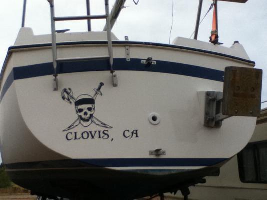

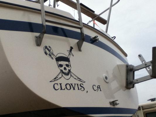

I'm redoing a 25' Oday I just purchased that was not taken care of on the outside and had oxidized quite a bit.
I just finished the stern with 6 coats of poliglow and put decals on first as instructed. It came out looking brand new, you can even see the reflection of the motor mount in the picture and it was a cloudy day. I'm sure it will work on your boat.

You can go over the entire boat. To answer all of your questions go to www.poliglow.net
Looks great!
I would have done Poli Glow but my gelcoat was in such bad shape I had to paint.
