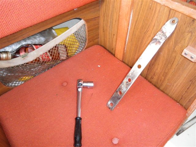

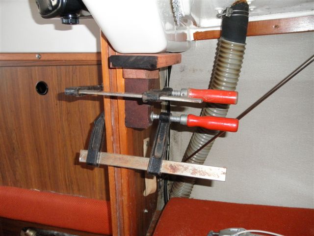

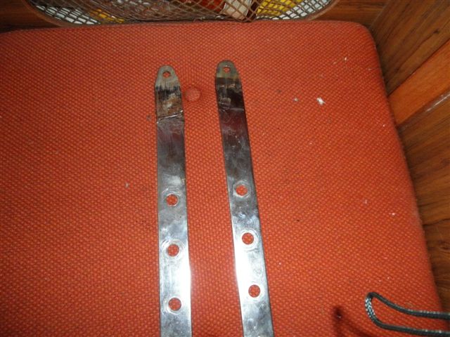

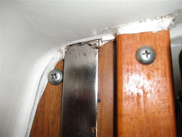

i cut the sylicone around chaine plate,found cracks,supported beam,dismantled chain plates,all is there for you to see!
because others have not reported something similar,here is my two bob worth....
causes: --- chloride stress corrosion cracking combined with weekly club racing(more pleasure then racing!)
---oxygen starvation---embeded in glass,combined with above,or
----because it sits up side down(in comparison with most of the other Yamahas)

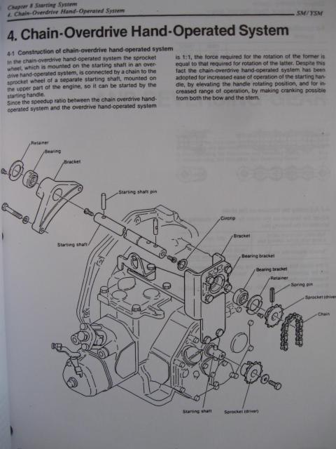

Pic 1, port chain plate, shows the crack on the right filled whith rust which in time oppend the crack more and more,bending the plate towards left,against the pulling of the shroud!!!!
By the way,I too like things "manual".My chain sprocket for manual start,installed on my Yanmar on main shaft together with pulleys for water pump and generator turns freely in both directions.In ten years I have never used it and unfortunately,never oiled it,lately trying to bring it to life ,with oil,too late,wd40 and even with heat and hammer knocking but no succes so far.I suspect it has a one way bearing inside and the balls got stuck in solidified oil.ANY SUGGESTIONS

Took a look at my manual. Sounds like you've got it right. The handshaft over the engine supported by two pillow block bearings-then to the chainsprockets that attach to the actual starting shaft which returns into the engine case. On that shaft is a roller clutch. I'll try and post pics of the manual pages tomorrow. Looks easy enough to get at, just remove the cover. unfortunatly it's on the unfriendly side of the engine compartment - toward the bow

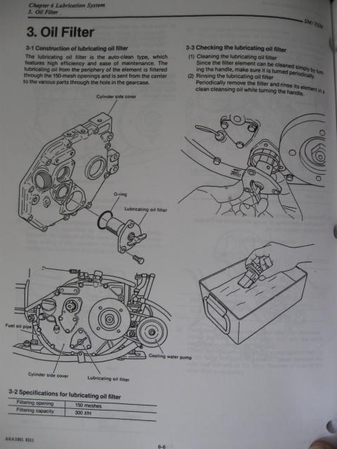

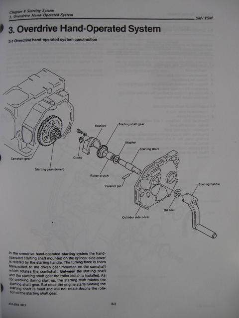

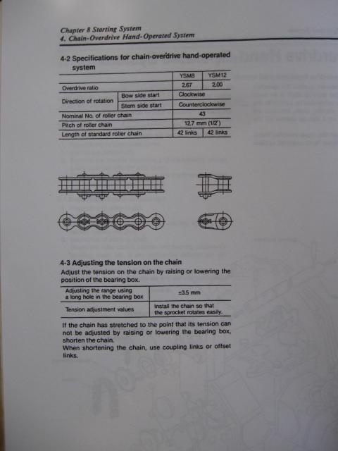

Here ya go - hand crank 101. Also included the "manual" oil filter service page located in the same area. Hope they can be read.
An old school penetrating oil trick --- ATF/ Acetone @ 50/50
Meant no disrespect with the "animal" comment. Just know you Aussies sail hard. Your Cup record speaks for itself.

Acronyms = Yank mis-communication method.
ATF - Automatic Transmission Fluid.
