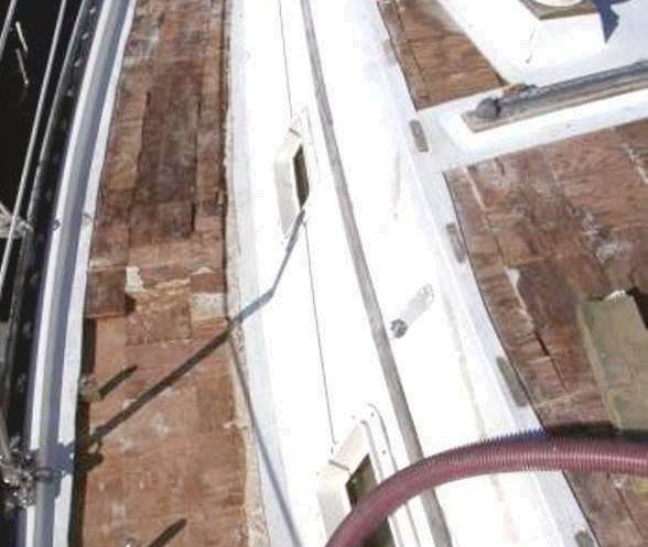

In the picture of an H37C coring project(not mine) you can just make out two of the three chainplates.

The chainplates need to have a bit of space around them, since they tend to flex and move a bit as the boat moves. If you have the deck right up against them, they'd bend and fatigue and then snap at that point.
I would pull the chain plates, one at a time, fill the gap between the laminate layers with thickened epoxy after checking to make sure the core is dry... then replace the chainplates. Leave the opening so that there is about 1/8" of space all around the chainplate. Fill that with butyl rubber and cover the underside of the coverplate with a layer of butyl rubber and then snug it down... and I'm pretty sure your chainplates will stay nice and dry.

That seems like sound advice as far as it goes 'dog. But I still don't see how I get that hole made. Doesn't filling the void also fill the hole? Then how do I make a new hole of the right dimension and angle? Maybe use a piece of wood of the correct dimension and then drill it out?
And as I wrote above, even if I replaced the core in a wide area I would still have to figure out how to make a solid epoxy hole.

I'm saying you should fill the gap, in-between the top and bottom layers of laminate where the core material was, with thickened epoxy and leave the opening OPEN. The thickened epoxy can be injected into the gap between the two layers using a syringe and then faired even with the edges of the hole. Properly thickened epoxy will fill a gap like that and not drip or sag.
Another way to do this is to tape the edges of the hole off with duct tape or something similar, and then drill a few small holes around the perimeter of the chainplate opening and inject epoxy into one until it comes out the others...
