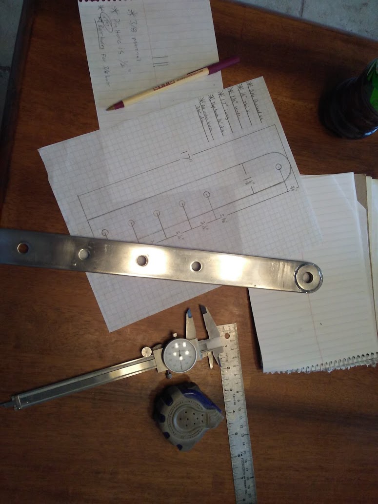

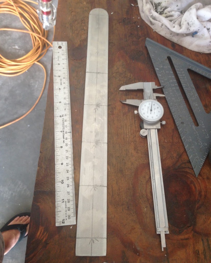

Careful measurements of the old chainplates were taken.
The metal was cut to size and the tops were rounded with a flap disc on a grinder. I was actually surprised how well it worked using a flap disc.
The cut to size pieces were then marked for drilling.

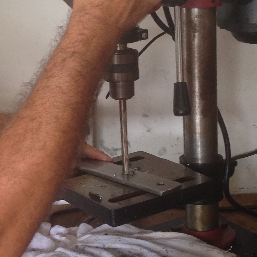

They were drilled (slowly) on a drill press using carbide bits and cutting oil.

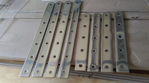

After all the holes were drilled the process of polishing began. I started with 80 grit flap discs on a grinder to remove the mill scale then moved on to a 120 grit flap disc. I couldn't find any flap discs finer than 120 grit so the next step was done with 220 on a random orbital sander then 320 then by hand using progressively finer grits wet sanding through 2200. A final polishing was done using barkeepers friend powder mixed with water to a paste consistency on a microfiber rag. The old backing plates were still serviceable so they were polished and reused.
