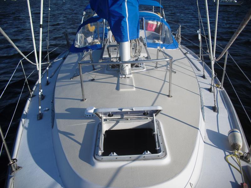

Chainplates and design have and always will be a big topic for us with sailboats, as seen with recent posts, and looking at Ron,s Benny hull chainplate damage, I cannot even imagine how this would make me feel, especially on a new to me boat, good luck to you on your repairs. I never liked the way it seems chainplates have evolved, last year, after completly rebedding mine on deck, I see them as quite a pain in the ass, especially if you are going forward in a hurry, duuh, seems like I am always hung up on them..I was at one time considering moving them like 3 " over and having like, 1/4" thick, 2" wide by approx 18-20" ss straps thru bolted to the hull , with 5/4 Mahogany glued inside hull and SS backers. Look at pics this would really free up deck, I can do this myself for basically the price of 6 straps I would need fabbed. This is the design of the old school, and with my 1977 Jenneau hull I think would be stronger than any deck mount. Anyone see and pros/ cons ?? Red
