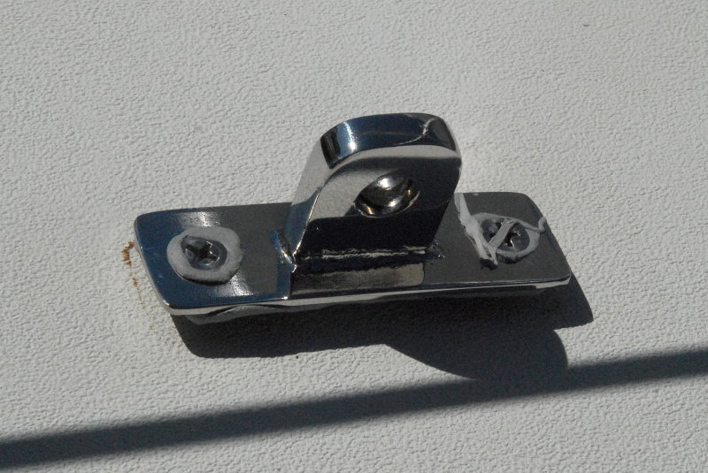

I know that questions about the best type of caulk for sealing the chain plate to deck joint has been covered many times. But I still am not successful at it. I have leaks every year. And in my last case, only a few months later the leak rate at one chain plate is as bad as ever. Just hosing down my boat results in a wet closet floor.
So I thought to pose the question differently: For those that used to have problems and then tried a new caulk, what was the successful caulk?
For my last attempt, in desperation, I dared to go non-marine. Background: 10 years ago, I had new rain gutters put on my roof. The contractor used a special caulk out of a typical caulking tube to seal the joints at the corners and downspouts. A decade of sun and weather and the caulk is still holding and in good shape. So I bought the same type of caulk at a roofers' supply specialty store to try on my chain plates deck joint. But the stuff hasn't stayed adhered to the smooth stainless steel. (On this, I have never used silicone caulk and also before my last application, I cleaned the surface repeatedly with acetone before caulking.)
My previous caulks have been polysufide and lifecaulk.
Ideas welcome!

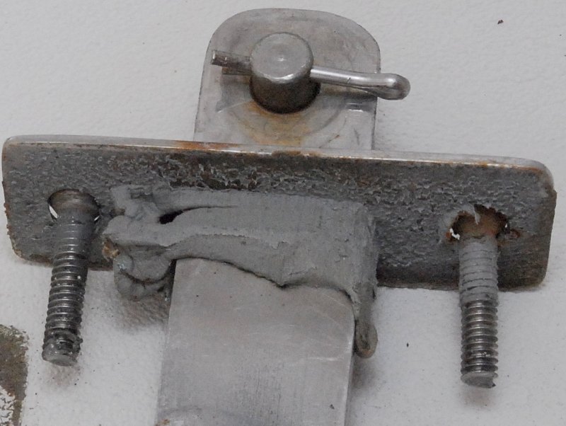

The chain plates on our CS-36 lasted for 32 years with butyl tape and were still dry when I took them apart. The chain plates were tested at a local machine shop who does metallurgical testing and found to be suffering from nothing. In 32 years none of them had ever leaked into the boat.
That being said some chain plates don;t lend well to butyl. You ideally need a through bolted cover plate though, not screwed down. Ours are physically welded to the chain plate and then through bolted to the 7/8" thick deck. CS never chamfered the deck holes, as Rich shows, or counter sunk the bolt holes. I did both after re-bedding them again with butyl tape. So they should last 64 years now.. :D
Butyl works best under compression and if you can't get compression then it won't work any better than anything else. You also need ROOM around the chain plate for the sealant to move and flex. If the slot is tight the chain plates will leak. There is no escaping this fact..
As Rich said clean enough is never clean enough.
This is how they came out at year 32. Not one leak out of six chain plates.
This is showing the 7/8" thick solid glass deck before I chanfered the edges to create compression around the plate as the butyl went back in.
After applying the butyl, around the chain plate where it passes through the deck, butyl cones around the bolts and under the heads and tape under the cover plate, I then press them into the deck.
In order to really compress the butyl I use a block of wood and all my body weight. Once I feel they are fully compressed I then and only then tighten the cover plate nuts while not allowing the bolt to spin.
Clean up is easy. Just make a small ball of butyl and make quick really fast, Jackie Chan like, stabs at the butyl. When you pull the ball away the butyl that squished out comes with it.
Oh yeah and clean up takes all of about 40 seconds..:D

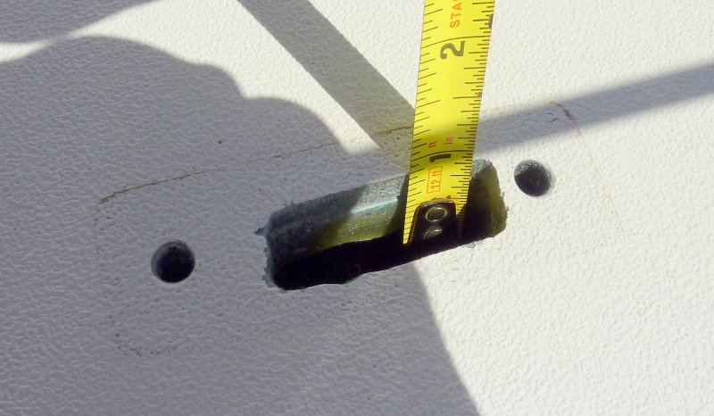

Jun 21, 2007
2,118
Thanks all. Great info and suggestions. I was at the boat today and unscrewed the chain plate deck cover plate off the most offending chain plate. Definitely on the interior side of the chain plate, it is hard up against the deck FRP with no gap/bevel to compress any caulk into. I will rectify this probably with a dremel. Also, I will be definitely placing an order of Butyl from Maine Sail.
