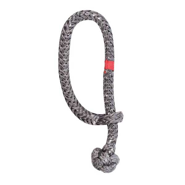

I like the idea of a soft shackle but was curious how you'd deploy it? I was on Animated knots and it might be beyond my fine motor skills to make one. I saw this at West Marine
https://www.westmarine.com/buy/west...shackle-xl--12501938?mrkgcl=481&mrkgadid=3280
It has a breaking strength of 10,000 lbs but how would you attach it to chain and nylon snubber?
24,519
@Bob S when you get the soft shackle in your hand you will find that the loop slides inside of the line. you open the loop and remove the knot from the loop. Then slide the loop through your chain, reinsert the knot through the loop. Tighten the loop so the knot is captured and you are connected. Better than AT&T or Verizon.

SBO also sell soft shackles on this website. I have used various sizes of Marlow Ropes SK78 soft shackles for applications. Not as an anchor chain hook but that is soon to be changed. Marlow dyneema SK78 (a little less creep than the SK75) soft shackles are sold in pairs. You guys below the 48th can make out like bandits here:
Until you undo it.:yikes:
Get out your knife in an emergency!
Jim...
PS: The anchor duty officer on our boat, say No Way! She even has a marlin spike for knots.
[the Admiral wins!]
