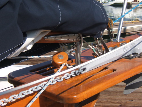

Cetol , I love it . Yes for sure the Sun is not your friend , unless you like painting with peanut butter . Start on a dry morning and try to finish before it get's hot , that leaves the rest of the day to dry so even if it gets wet that night most times it will be OK . The HeadMistress is right if you sand in between coats , it's awesome . However one day I read the can , It said don't sand in between coats . That was all I needed . My jobs don't look as good as the sanding in between coats but no one seems to notice .
010 by mark westi, on Flickr
