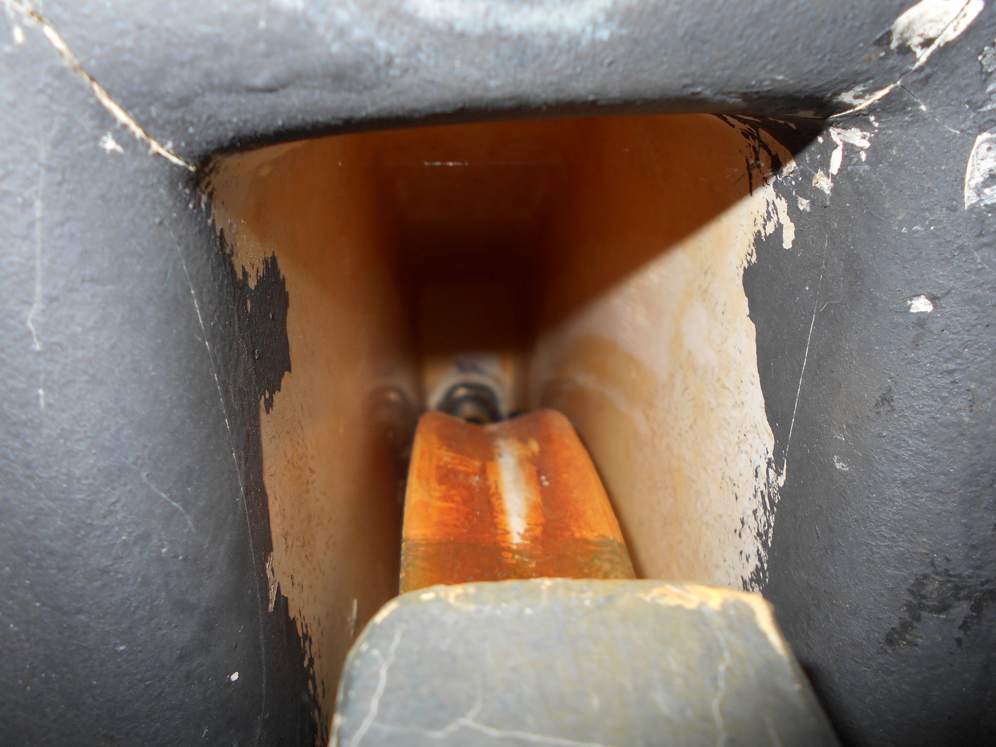

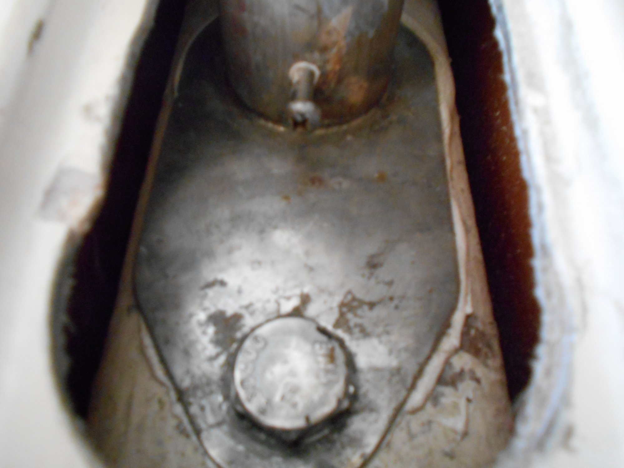

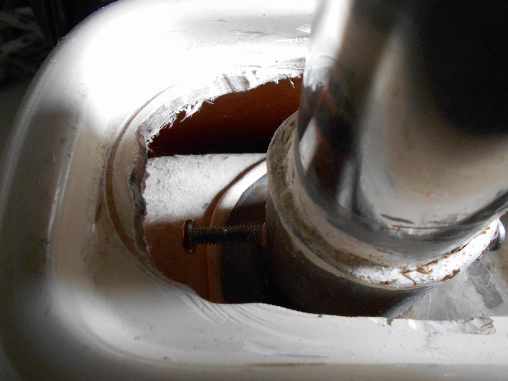

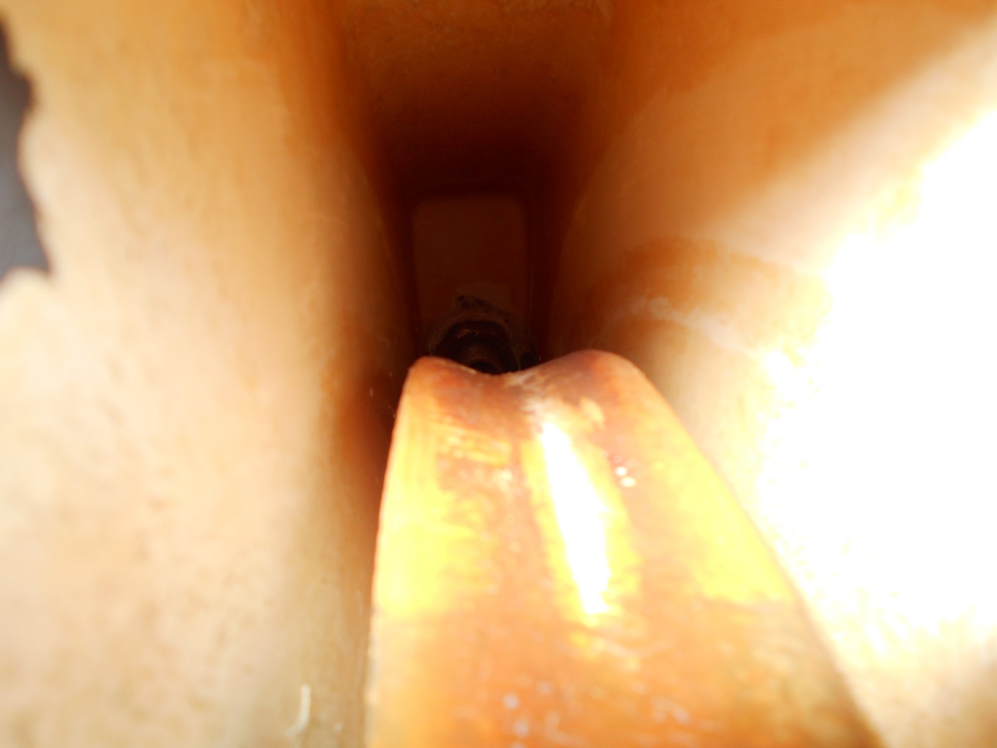

Wish I could be more helpful. Dave helped me replace my lift line and I did a write up. It does not address your concern but it has a lot of pictures of the bracket. Maybe one of the photos will give you some clues (see attached).
