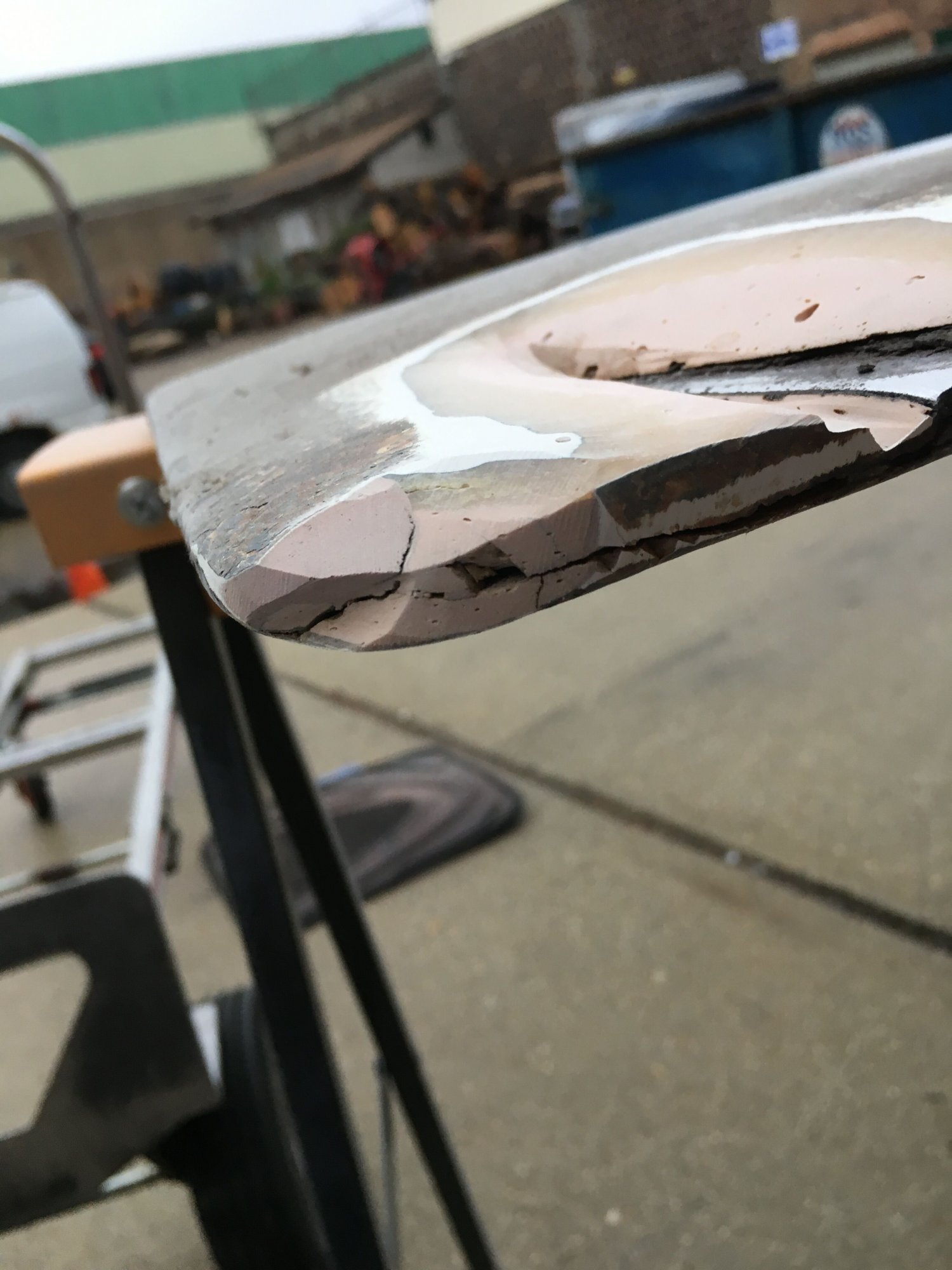

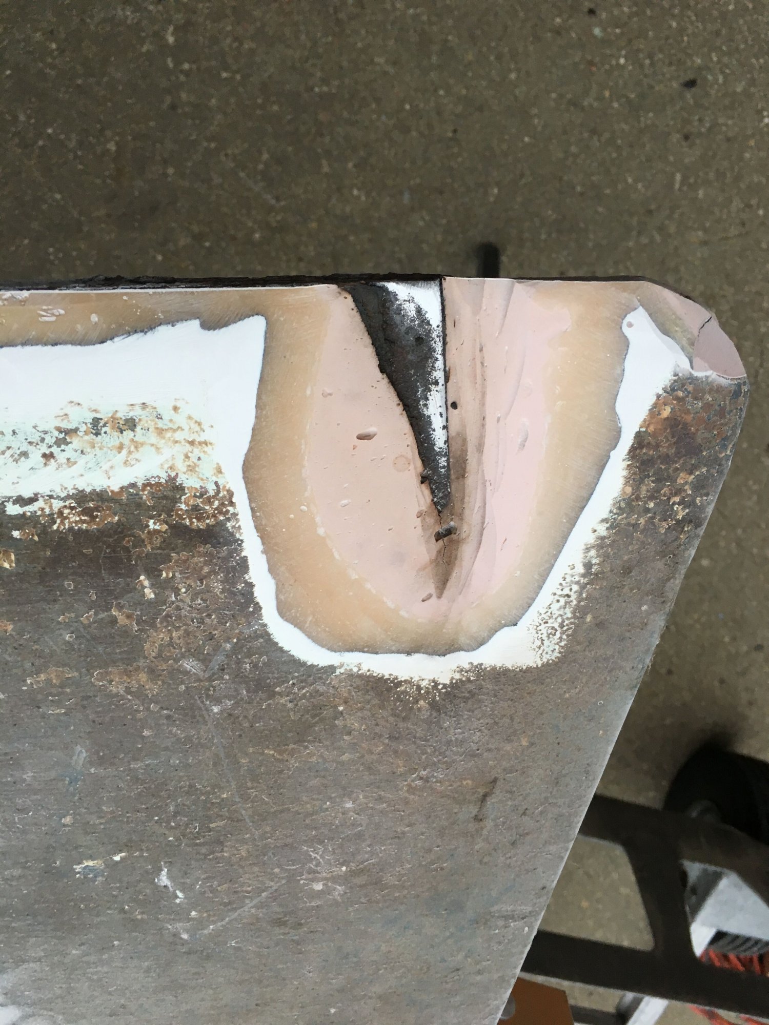

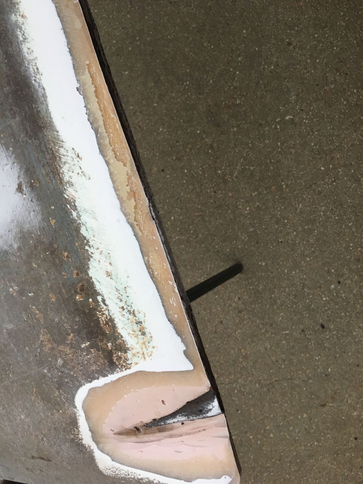

I dont believe the c/b is part of the ballast system on the 23. I think, but don't know for sure, that it uses the same board as the 25. My c/b weighs about 50lbs. I sailed it last year without and have heard of a number of others that have done the same.

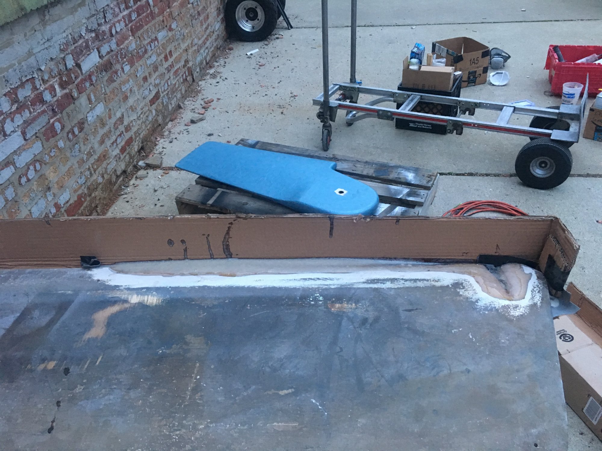

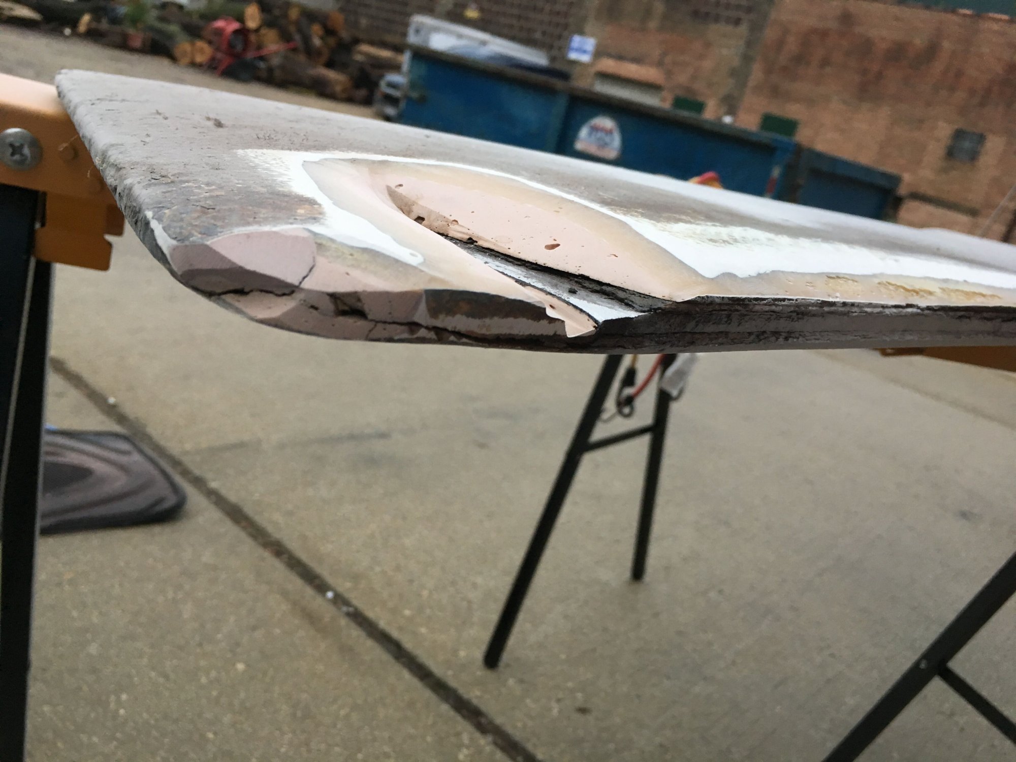

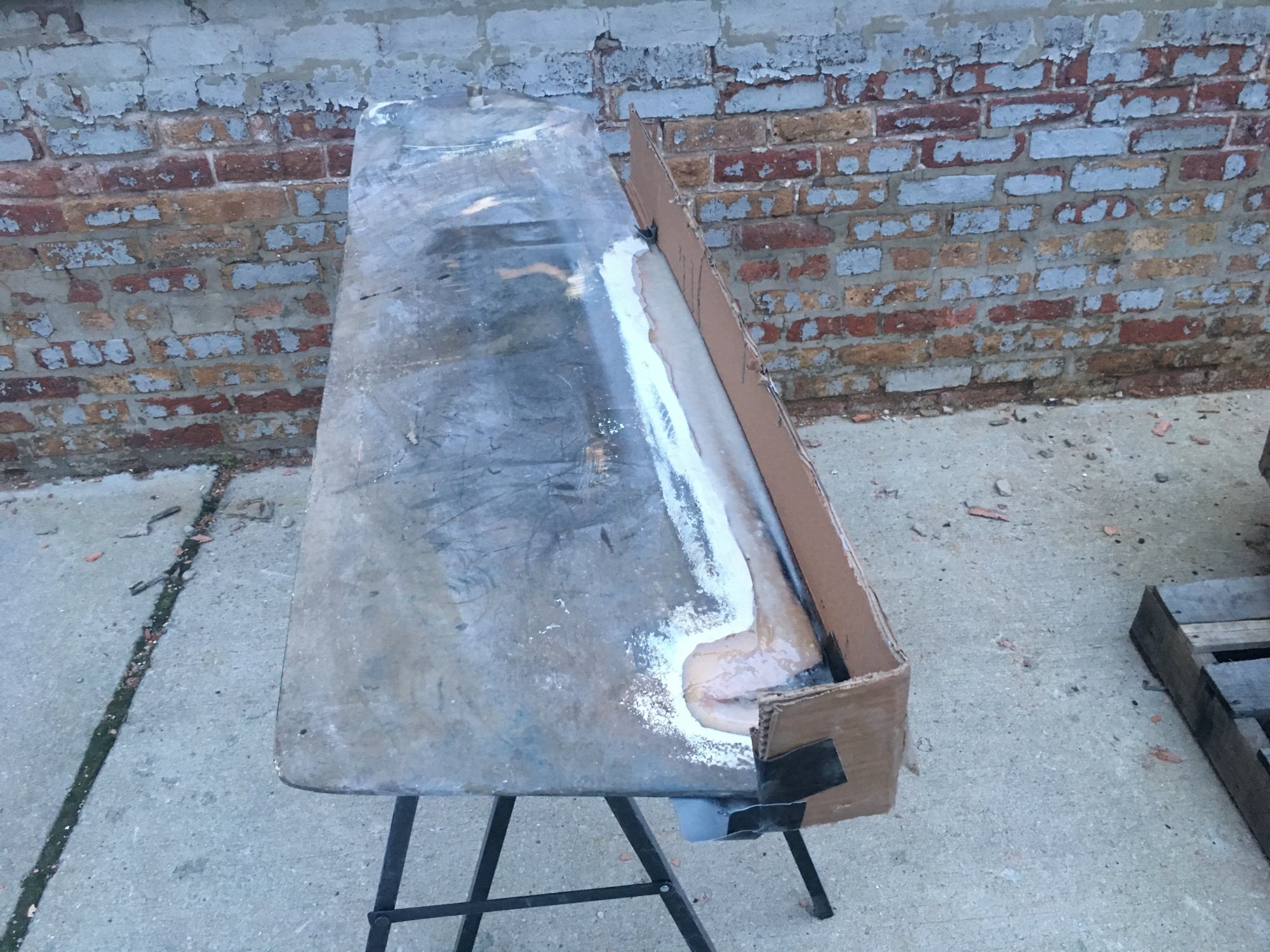

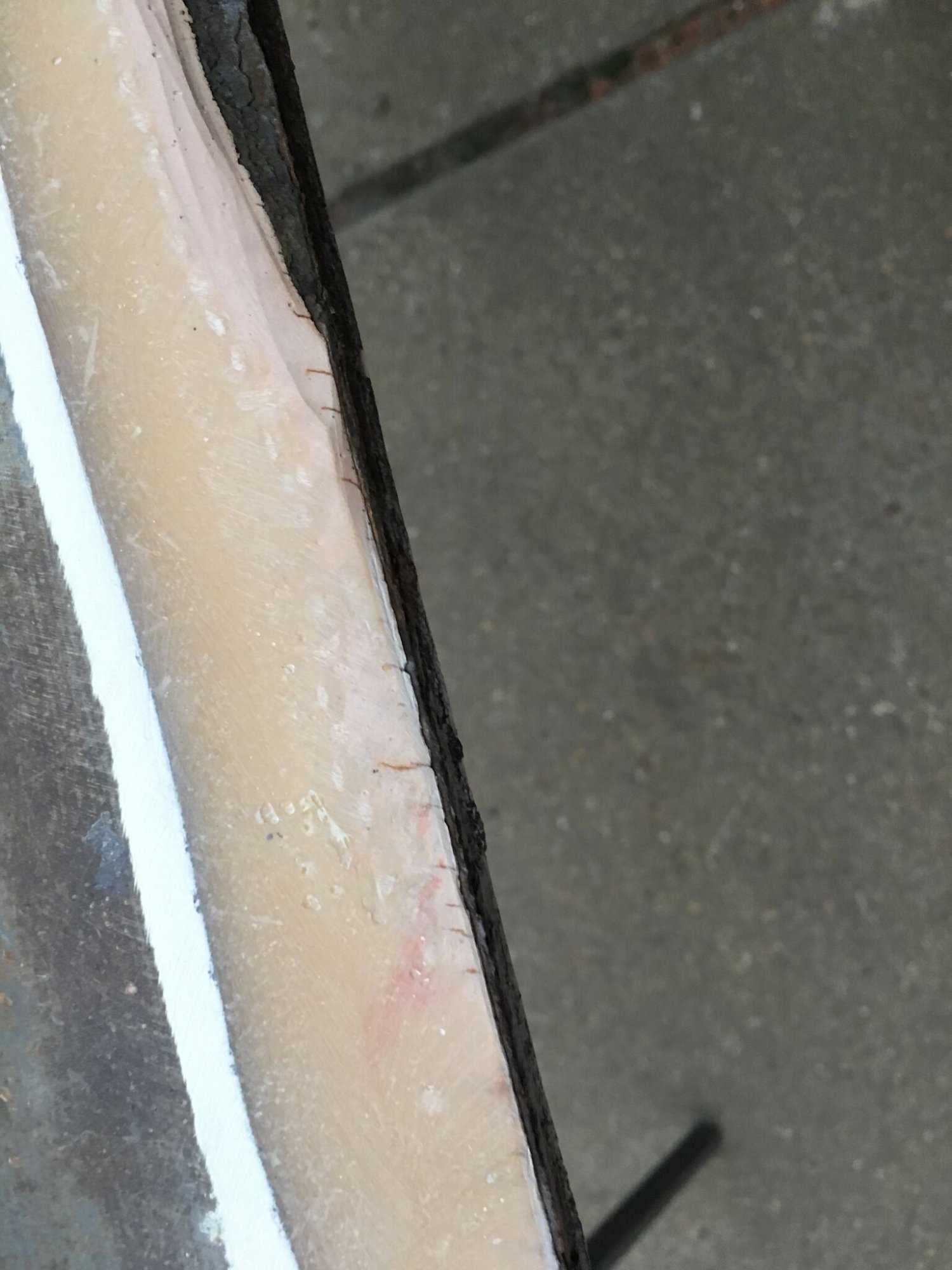

I'm not sure how much these will help you but here are a few pics of my centerboard being rebuilt. The blue rudder in the background is for a different boat

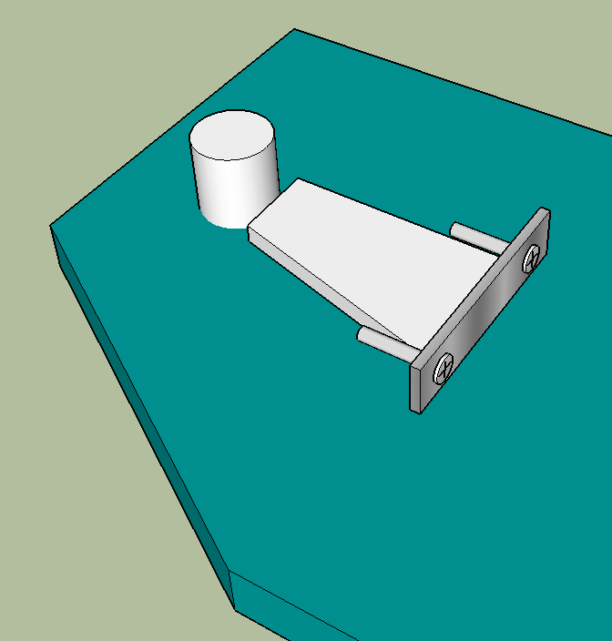

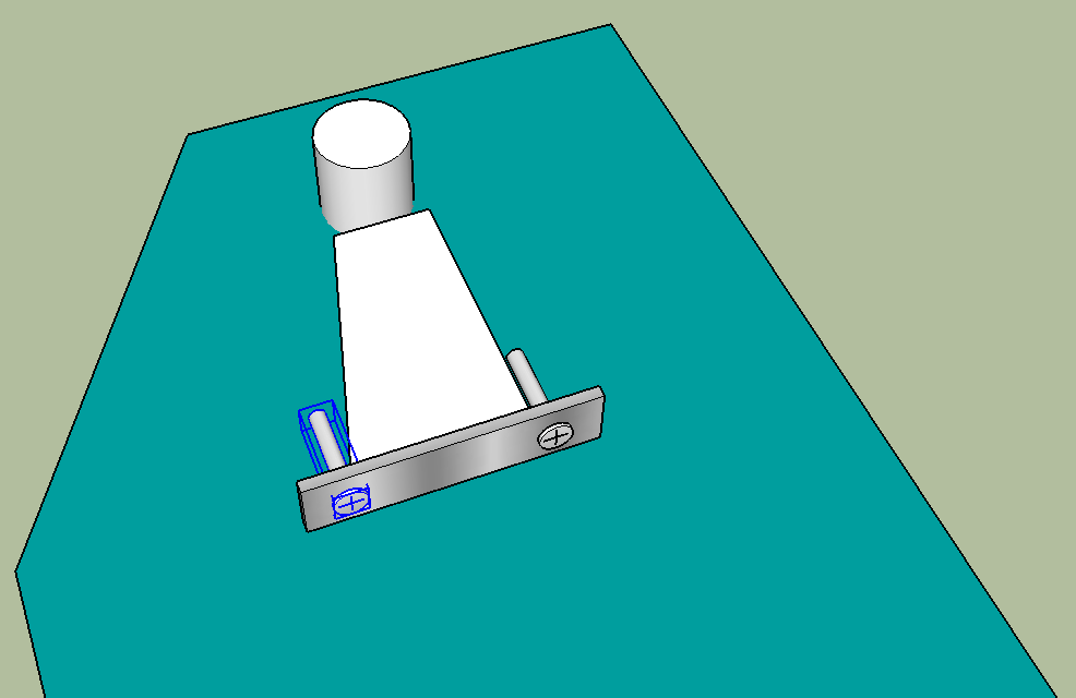

Here's what the setup looks like without the keel trunk surrounding it. Please let us know what other questions you have @Drexel We are here to help.
