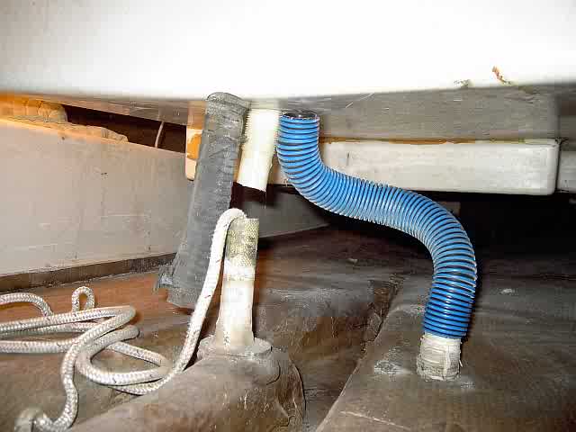

Hey folks, I have a 1976 O'day 20 which I'm working on which has a small tube running between the cockpit sole and the hull that has been rednecked over the years,and it works but is terribly ugly under my main hatchway.My question is this; Does anyone have any pics of how the original system was arranged? What is there is basically a small through deck fitting at the bottom of the hatchway which meets a possibly 5 inch peice of plastic tubing that goes down to another throughull fitting at the aft end of the centerboard trunk,and te penant goes through all this to the board. I really would appriciate any photos from the time period of O'days in this size range.

You should do a search of the archives on this site; many have posted the exact photos you are looking for. That set up is pretty consistent for the Oday trailerables: the pendent line into the cockpit, running through the tube in the cabin and down into the centerboard trunk. What exactly is your question? I don't know what it means that the hull has been "rednecked", and how that impacts the centerboard controls. If you have pictures of your boat and the problem, maybe someone here can give you some suggestions.

The existing centerboard pennant does pass through a white plastic fitting(identical to the one that drains the galley sink through the hu aboe the water line) at the bottom edge of the main hatchway from there it is a black semiflexible tube approx. 3" down to the hardened putty on the top of the cenerboard trunk. My question is what material fitting actually goes through the centerboard trunk(until I break into the putty,I cannot see what is there).I wanted to know what should be there, so I can be as close to original as possibe when I refurbish. When I'm really heeled over and working to windward I get waves that slap the bottom of the boat and shoot a stream of water into an otherwise nice dry cockpit.During these situations I have seen evidence of leaking around the putty,although I never see any during calm sailing,I want to have a watertight seal from the lower end of the tube to the fitting at the top,where the pennant exits. Thanks again for your help.

As for your specific question, I am sorry that I don't know how the flexible tube is attached to the centerboard trunk. Given that the pendent line has to run unimpeded through the tube to the trunk, I don't see how there really could be any sort of through hull or other "fitting" that attaches the tube to the trunk. I guess it really depends on how Oday outfitted the attachment side of the trunk. If it's just a hole, then maybe they fit the tube right into the hole and glopped on enough epoxy to make it watertight. Wouldn't surprise me at all. If Oday bothered to build a nipple onto the trunk, then maybe the attachment to the sleeve is by a neoprene sleeve with hose clamps maybe?
Maybe the simplest way to keep your pendent line from spouting like a whale is to put a bend in the flexible hose. Can you do that without rebuilding the entire setup?

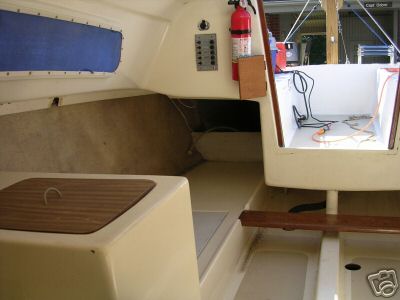

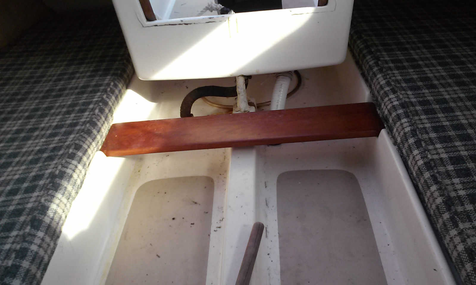

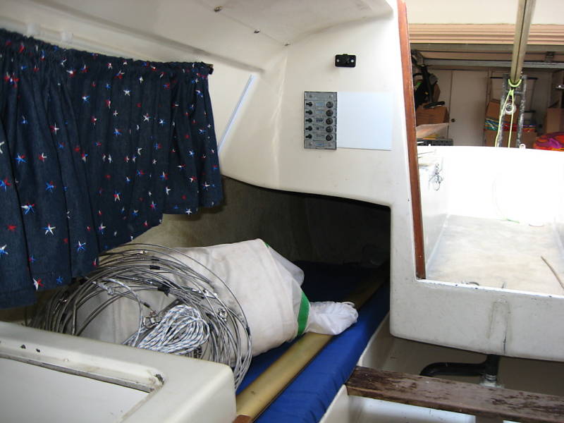

I looked in my library of O'DAY pictures, found a few key pics.... Well, a few are from 1976-7 1976, but maybe the earlier 1974 and 1975 set-ups will still be helpful? The 1976-77 ones may not be detailed enough, but at least show what the area looks like to those that may not have seen a nO'DAY 20.

Hey great info guys,thanks so much.Sunbird,your pics are a wealth of much needed details from inside the cabin.

Is the large hole in the sole just forward of the companionway step just for bilge access? Was something meant to be there, pump, etc?
Also, anyone know the diameter of the hole/opening in the centerboard pendant hole/fitting in the companionway? My centerboard is stuck in the up position and before I dive under the boat I thought I might give it a poke with an aluminum rod of sufficient diameter.

Mine appears to be a fiberglass, molded tube...a small bit of flexible pipe, 2"-3", connecting the fitting in the companionway tk the pipe coming off the centerboard trunk. No bends, straight shot. So if one is careful in threading the steel rod into the pipe itself, a few sharp taps should be fine... I'm thinking.
