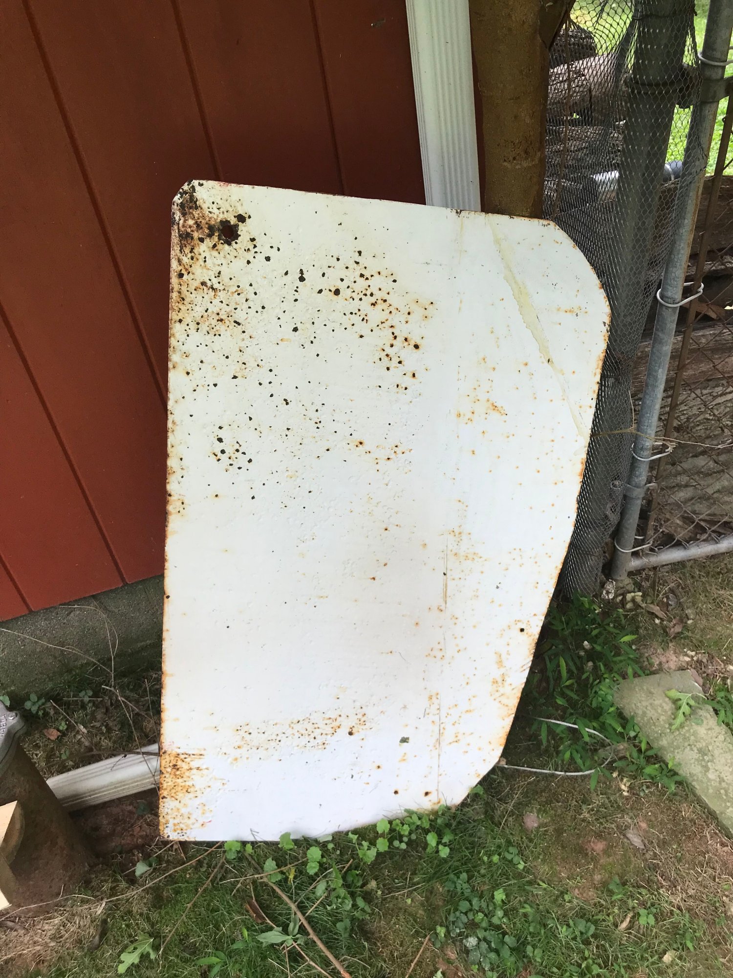

I'm getting a new CB fabricated for a 17' sailboat, so wanted to be sure I understood how it works first. The current CB is in the image. The bow would be to the left. If you look on the lower right corner, it has a pull handle for lifting, with several holes for a cotter pin, which rests atop the trunk and across the slot. My question is... how does it 'stay down' when under sail? I've only ever sailed daggerboard and keel boats. Is it just the weight that will keep it from riding up into the trunk, or just generally being loose? There is no 'pull it down' mechanism.
Thank you!

If I'm to understand the picture correctly ,the left side is the forward edge . There "appear" to be a fair number of rust spots. If this is indeed the
case then the center board is steel . That weight alone may well be enough to keep it down . My centerboard is about fifty or sixty pounds and stays down just fine . The holes may be for holding it up for shallow water or trailering .

Even a fiberglass center board will stay down from weight alone. There isn't much force pushing it backwards until you hit bottom, where you want it to lift up.

Warped, pitted, and the various holes are rusted wide open. The other stuff could be fixable with a sandblaster and the epoxy coat, but the whole thing has a warp to it. Anyway, I have a shop working on a new one, which is exciting.
