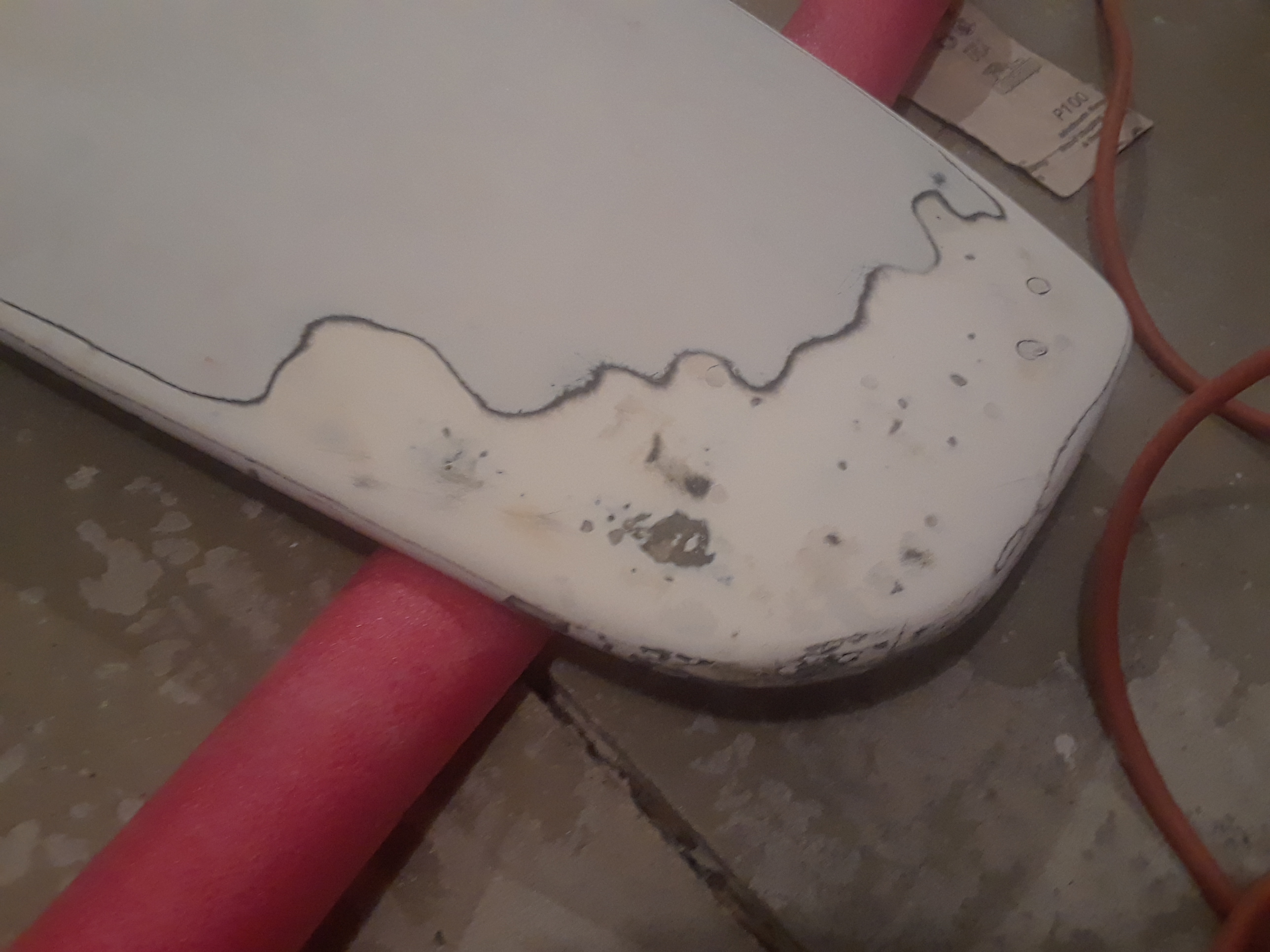

I took the centerboard off last spring and when i went to fair and paint it i found that there was water inside it. This water intrusion was no doubt the reason for the gelcoat blisters.
I drilled about 20 holes all the way through and let it sit in the florida sun for days, changing its orientation often. Eventually, it dried out enough that i didnt hear it swishing around anymore.
It was faired, the wing shape was improved and all remaining damage from use was repaired. The deep repairs were a combo of marinetex and the west system activity kit. The remaing pits were filled with a bondo product for very tiny pinholes. It came out really good and had fun working with the different products to get a feel for what works.
Since i used bondo i thought i would use some black automotive filler primer and then apply marine topcoat.
So far so good. I added about 5 layers of paint, sanded, then polished. The shell was perfect and upwind performance was much better than before.
Been sailing regularly since the repair and admit that we grind on the sandy bottom. The centerboard shows some battle scars on the bottom edge.
Well, last week in my excitement of a great sail and concerns of the new tow vehicle pulling up the ramp i did the unthinkable. I loaded the boat on the trailer with the centerboad down.:stupid:
The sound.... Might as well been my shin.

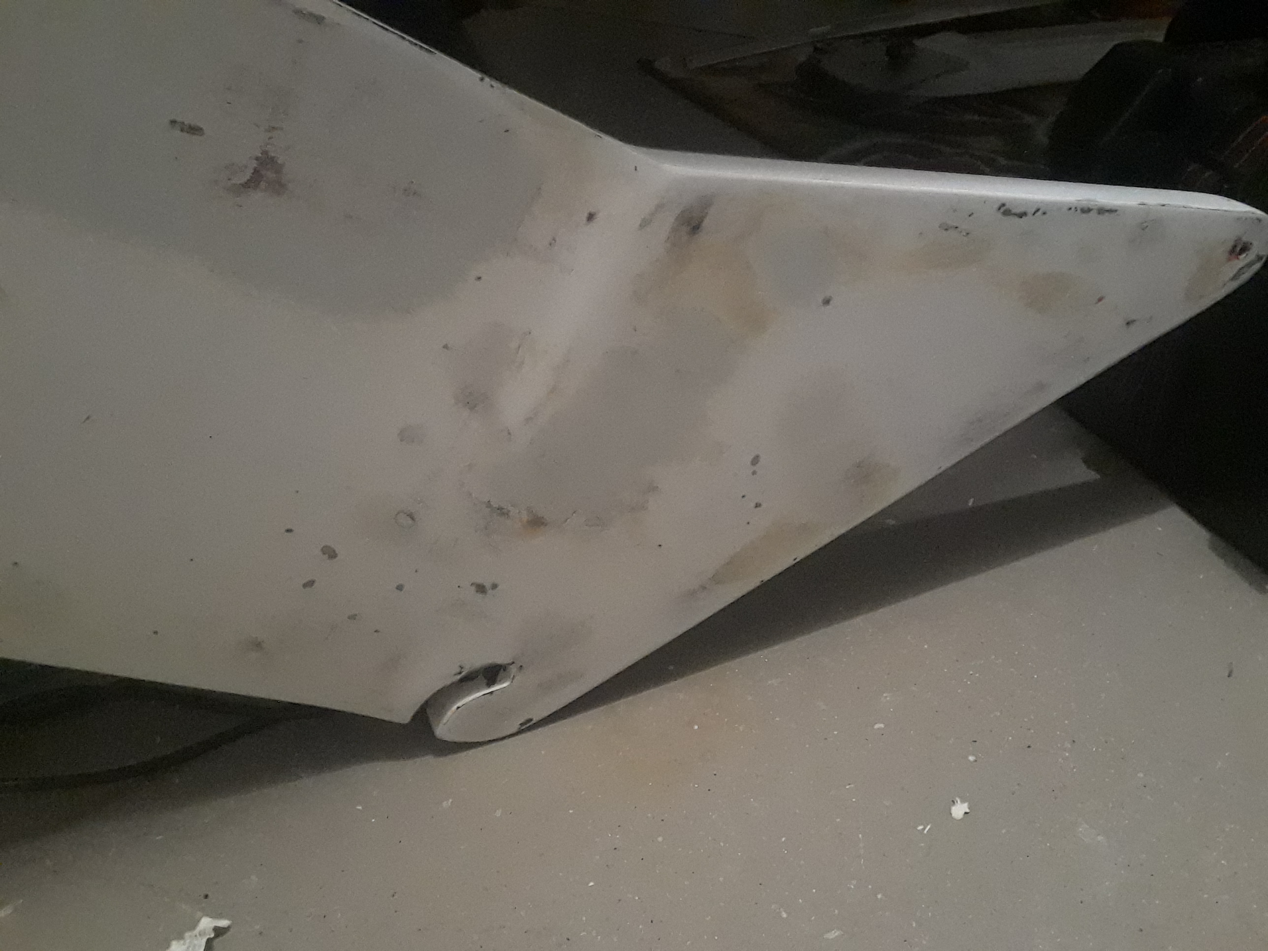

The new suv got us out no prob and i was able to check out the damage. About 18 inches of paint scraped off the leading edge and one good ding. It's a leading edge so i knew i had to lay some new paint there.
I pulled the centerboard out and figured this would be easy. Nope. Every time i went to sand the paint edge it was still loose enough to flick off a piece. I started sanding the whole paint job off but got lazy and tried a chisel. It was so easy my son asked if he could try it. It was almost satisfying watching the chips explode off as he scraped 1 inch wide swaths of destruction from one end of board to another. Even after chiseling the underlying primer coat was flawless. It had a cool carbon fiber look to it. I figured paint failure was due to an incompatible primer so sanded that off. It was very easy and so now were back to a mix of factory gelcoat, west system, layup, marinetex, and bondo. The base is in really good condition, even the deep red bondo.
This time I'm going to gelcoat/flowcoat/hotcoat the whole thing like a surfboard.
As I'm washing with soap i turn the centerboard and i hear it. Water swishing inside. Sounds like 8 oz worth. Unbelievable.
So now im trying to drain it.

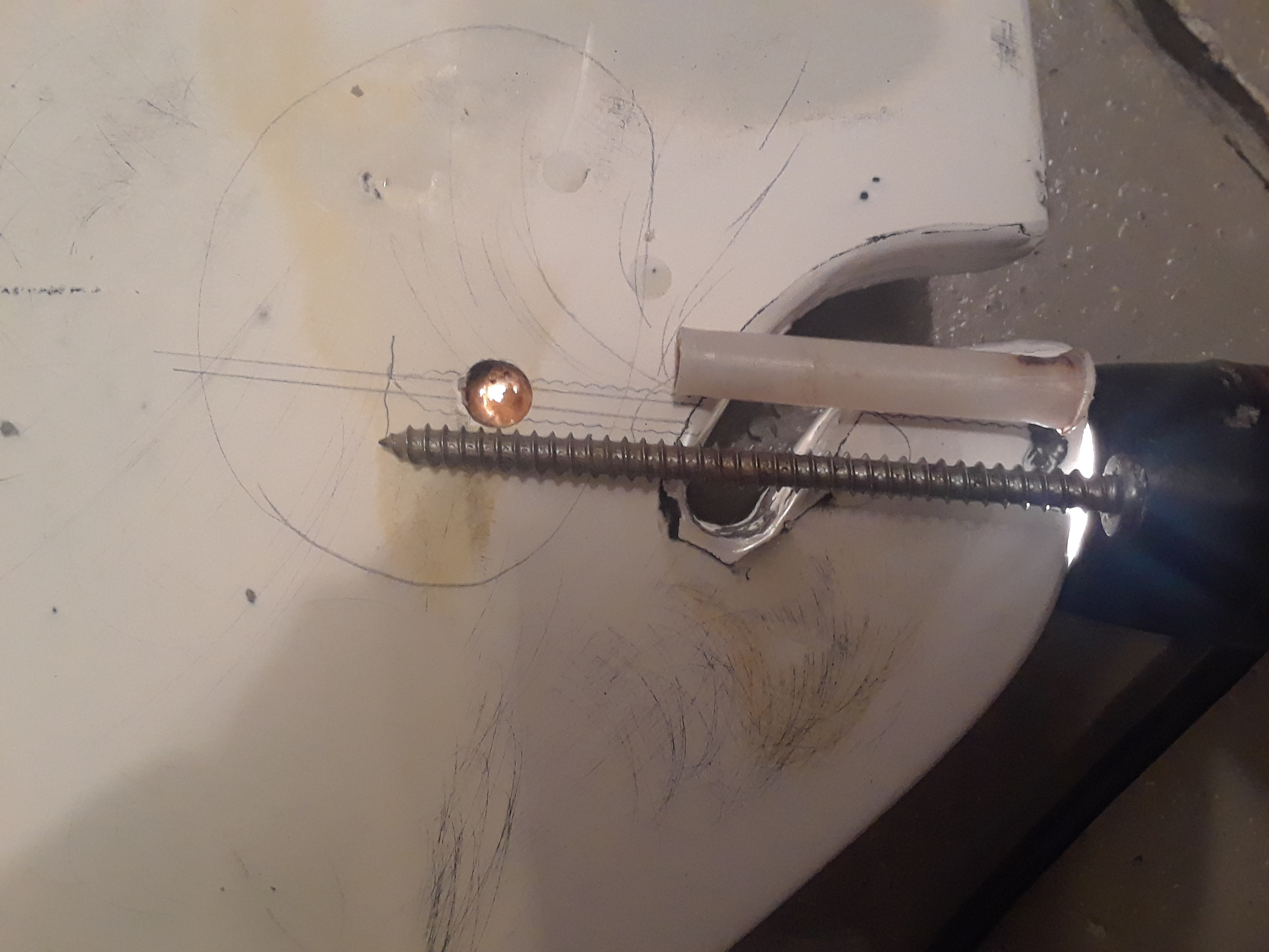

I think the water is coming in at the screw hole that locks the centerboard to the hinge pin. The pin is underwater the whole time the boat is off the trailer.
Trying to think of how to seal the hole for the screw so that i can undo the screw and centerboard for future repairs.
Here are some pictures. On one you can see the sanded topcoat, primer, the fairing. The circular sharpie marks where fairing compound was needed are still visible. At this point in time i was thinking a couple coats of paint and be done.
The bottom of the centerboad shows the notch for hinge pin. A screw goes through the protruding bit then into the core.
Just blast it with 4200 sealant next time?

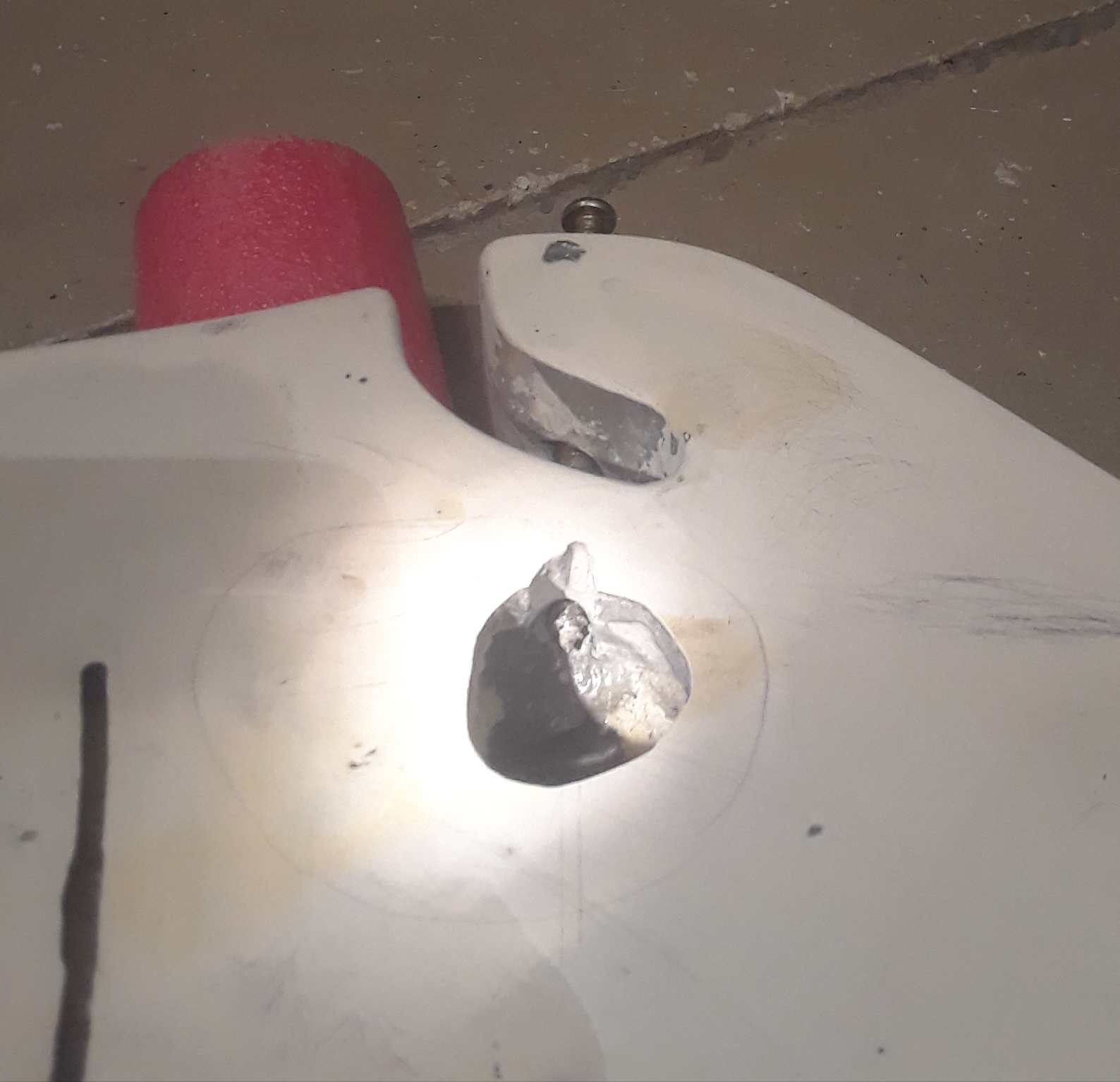

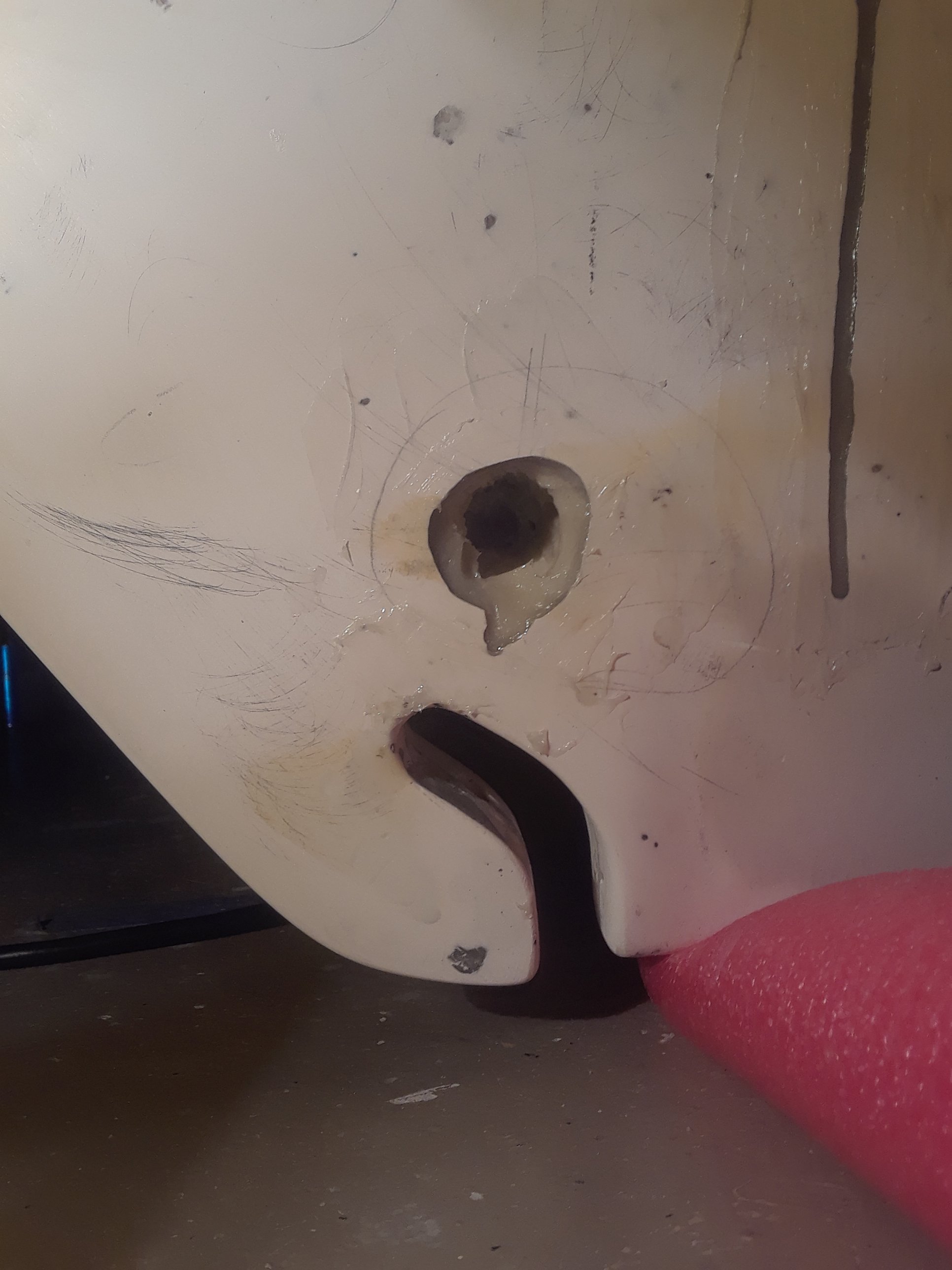

I took a router on the surface along the path of the locking screw and see the issue clearly and have a repair plan.
The screw threads to a solid resin substrate but about 1 inch of the screw penetrates into the foam core. I will correct this by reaming the foam sorrounding the screw hole and pouring resin to the full length of the screw plus a little more. Afterwards, ill foam the remaining void.
I used a router to slit my centerboards throat, it bled water like a pig so it is probably delaminated pretty bad in there.
Im going to fix the hinge screw, repair the cuts then get back to sailing. Its 13 years old. Not bad.
Im going to assume every 170 centerboard has this affliction due to the screw entering the foam.

Last night the area of concern was enlarged and all the foam in tbe cut area was removed.
Id love to see a how its made episode on this. There appears to be a plastic shell encapsulating the foam, then frp layup, then gel. The lower section has a thin lead plate, but the area im working in didnt have lead.
There is only about 3/8 inch of the plastic shell for the hinge screw to grab then its right into the foam core.
I had some left over west system high density so was able to pack in some epoxy through the shell until it noodled out the original screw hole, then covered the foam core. Tonight i will ill the remaing area with more high density epoxy, replace the skin, then lay up some fairing.
I would like to nominate the inventor of the pool noodle for a nobel prize. Can i do that.

The hole has been completely filled with epoxy and then fared with microballoons. I patched up any chisel scratches and any new pin holes exposed by sanding.
Cleaned with dawn, acetone and then alcohol. This should resolve issues with gel over epoxy.

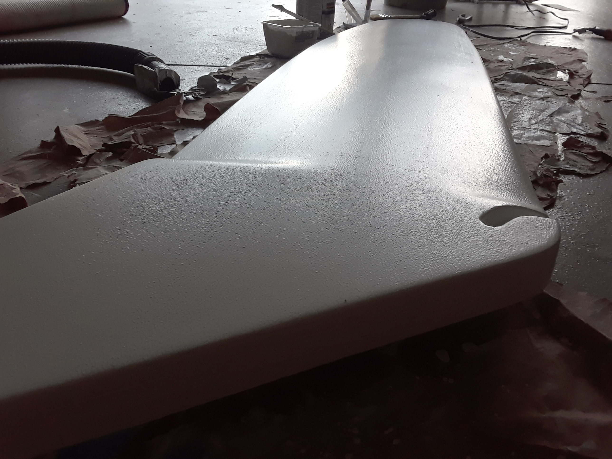

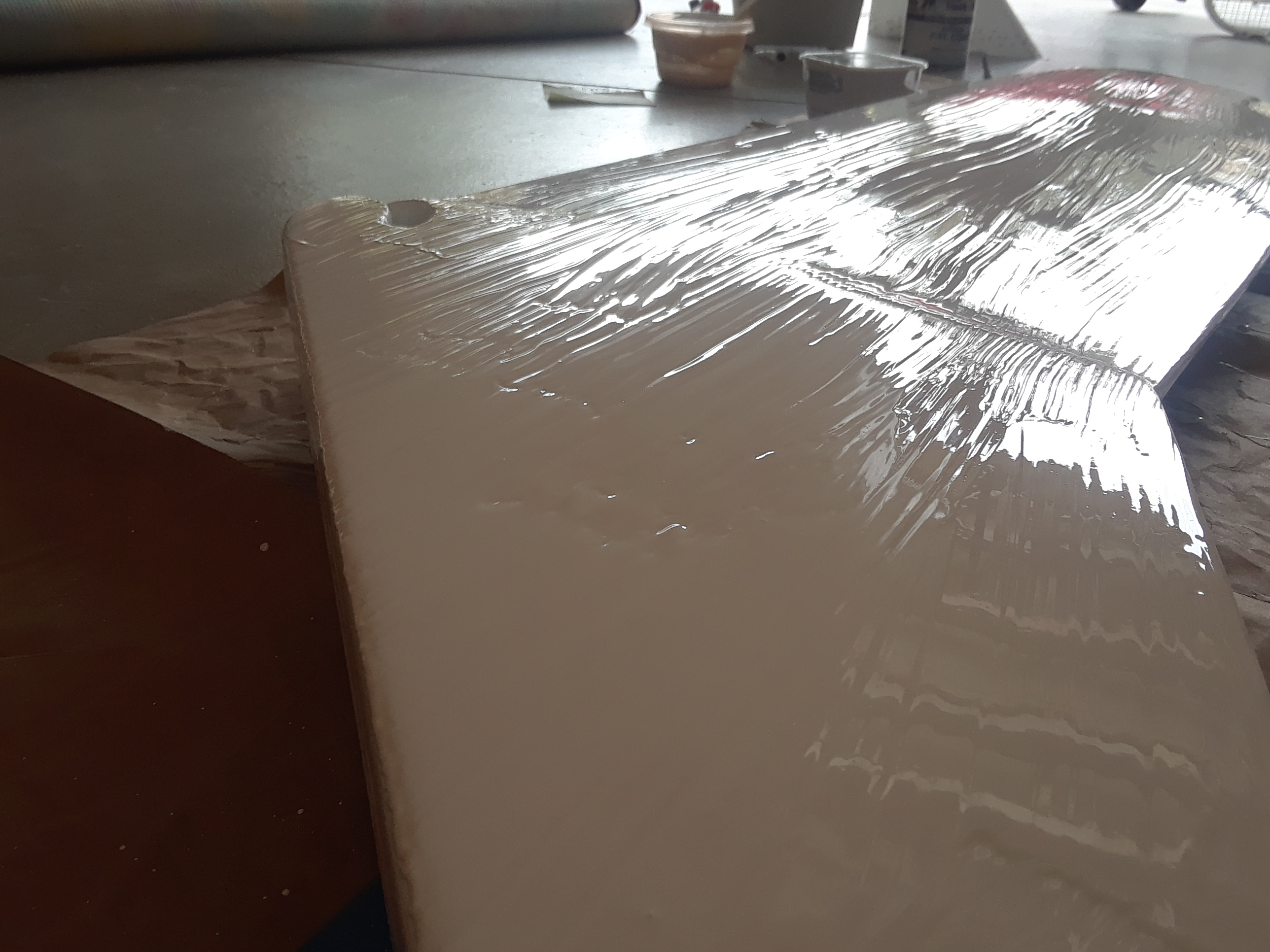

Today the gelcoat was brushed on the second side. Can see why gelcoat is despised for aftermarket surfacing. It doesnt level at all unless poured. Going to have fun disc sanding that smooth.:liar:
I tried to squeege the gelcoat like a surfboard, but it was way to thin. I pre measured the gelcoat based on the coverage rate and after pulling it around I still had 3/4 left, so i ended up just pouring it out then distributing it evenly toward the masked edges.
I brushed as gentle as I could but it has a stickyness that pulls a ridge up at the slightest touch. I've rolled and tipped before, this stuff is a menace. Smells nasty. It was 75 and windy so perfect for garage duty.
Noob tips...use a medicine syringe to measure hardener based on the milliliters of gelcoat. I read too many reviews of people counting drops and the gel never getting hard.
Convert all measurements to milliliters. Makes calculating cc's of hardener easy head math at 2% ratio.
Fill a measuring cup with water, pour into disposable container, make a mark, write hardener amount on line.
Water plants with water, dry container, then pour gel coat to that line, add specified resin using syringe. Pros usually have those cool sqeeze neasuring caps . I didnt have that.
After about an hour the coat was dry to touch. Tomorrow I'll start disk sanding the brush marks out. 20180204_151148.jpg

With gel coat, you have to use a higher temp
hardner which can be bought at the forum store or possibly another marine outlet.
Gelcoat will not dry in air. There is an additive that can be added that will put an outside coating to cut the air off for the gel coat to dry. There is a spray that you can apply also after the gel coat has been applied.
I would if using gel would spray but it would have to be thinned out. Forgot the name of the additive but acetone could be used but not the best choice. I always constantly wiped off the nozzle to prevent buildup at the nozzle.

I used a laminating gelcoat but poured in the wax so it would final cure. I layed it on thick in one coat.
Its already for sanding and then buffing. I need to be careful I dont get too aggressive
