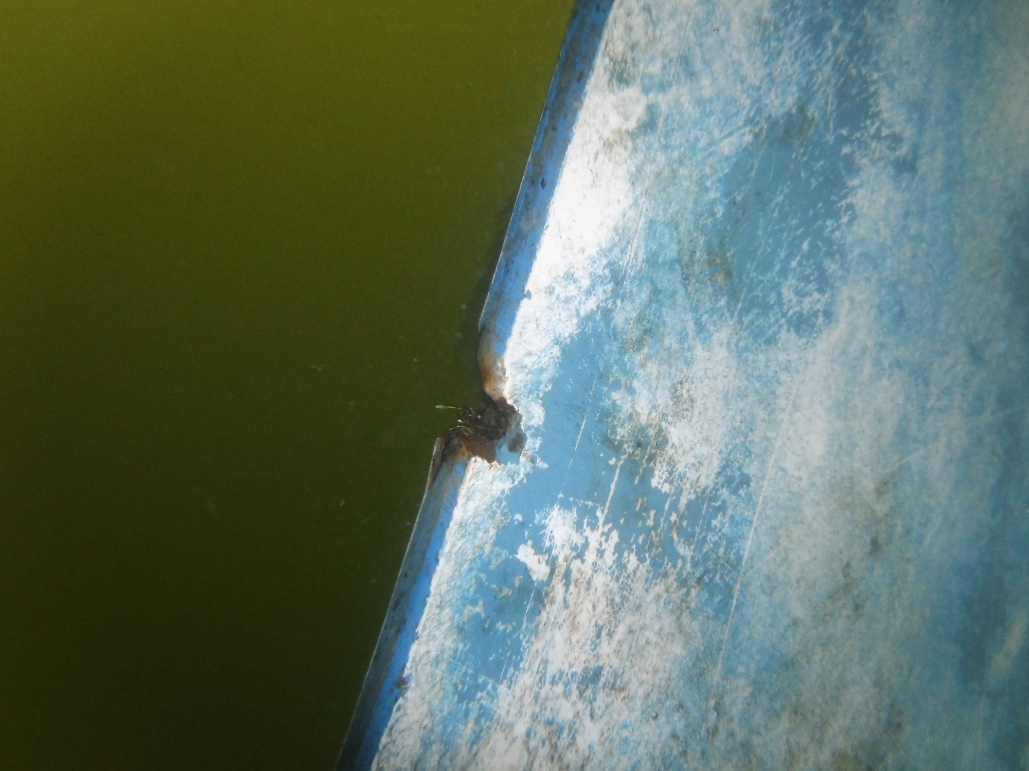

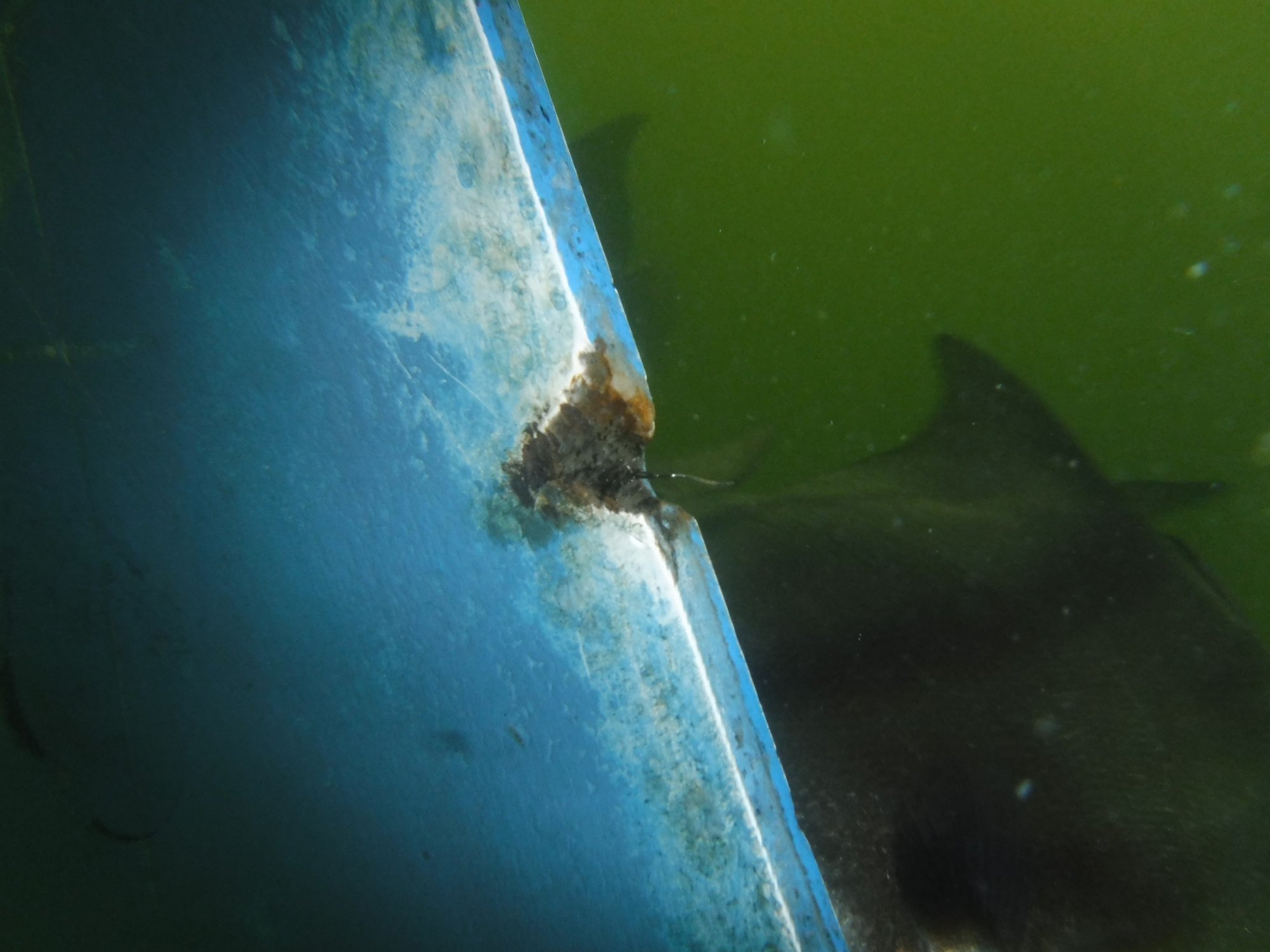

I'm just posting for moral support. Hoping that you find the answers you are looking for. My 32CC (new to me) has a broken cable.

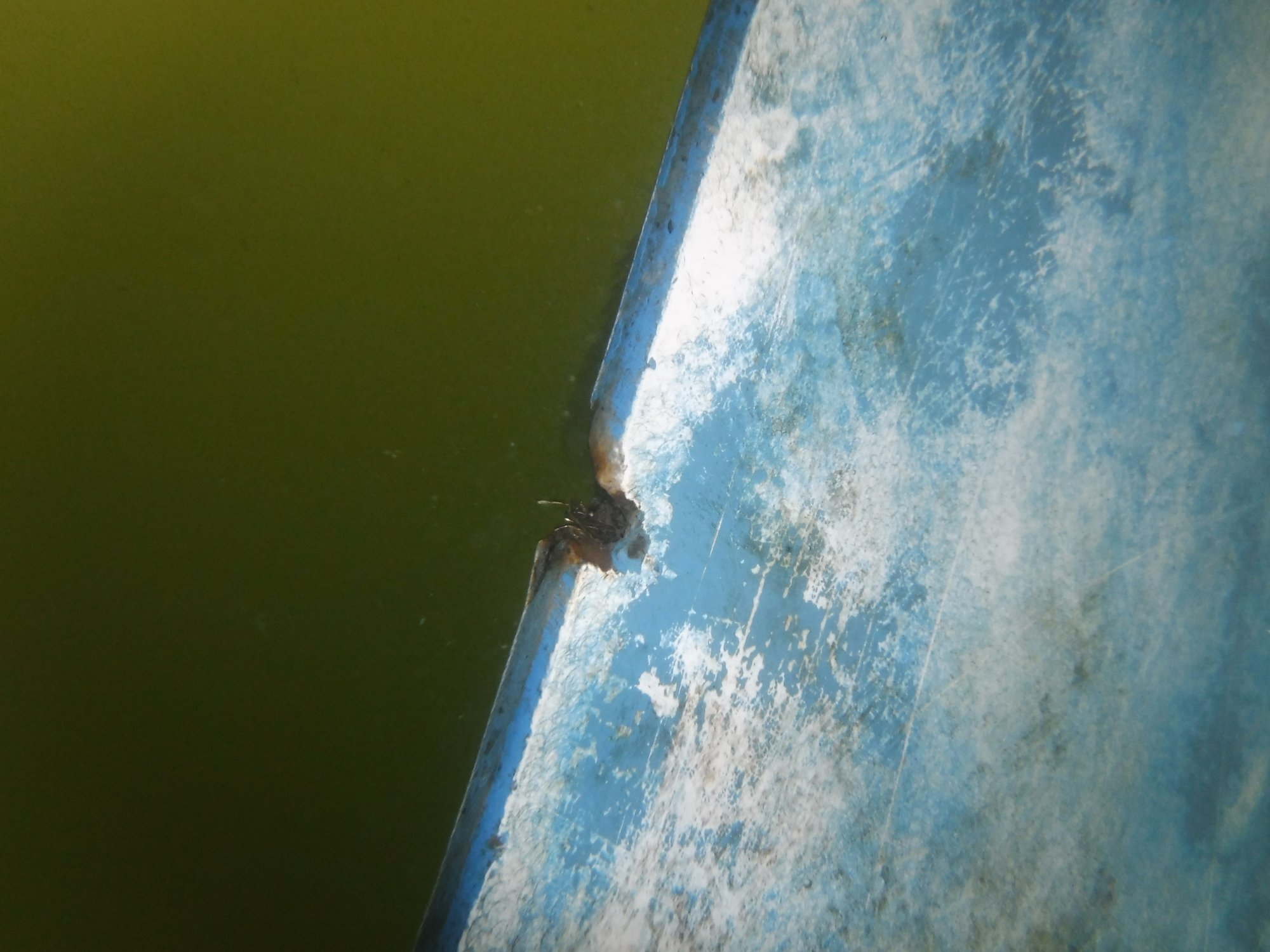

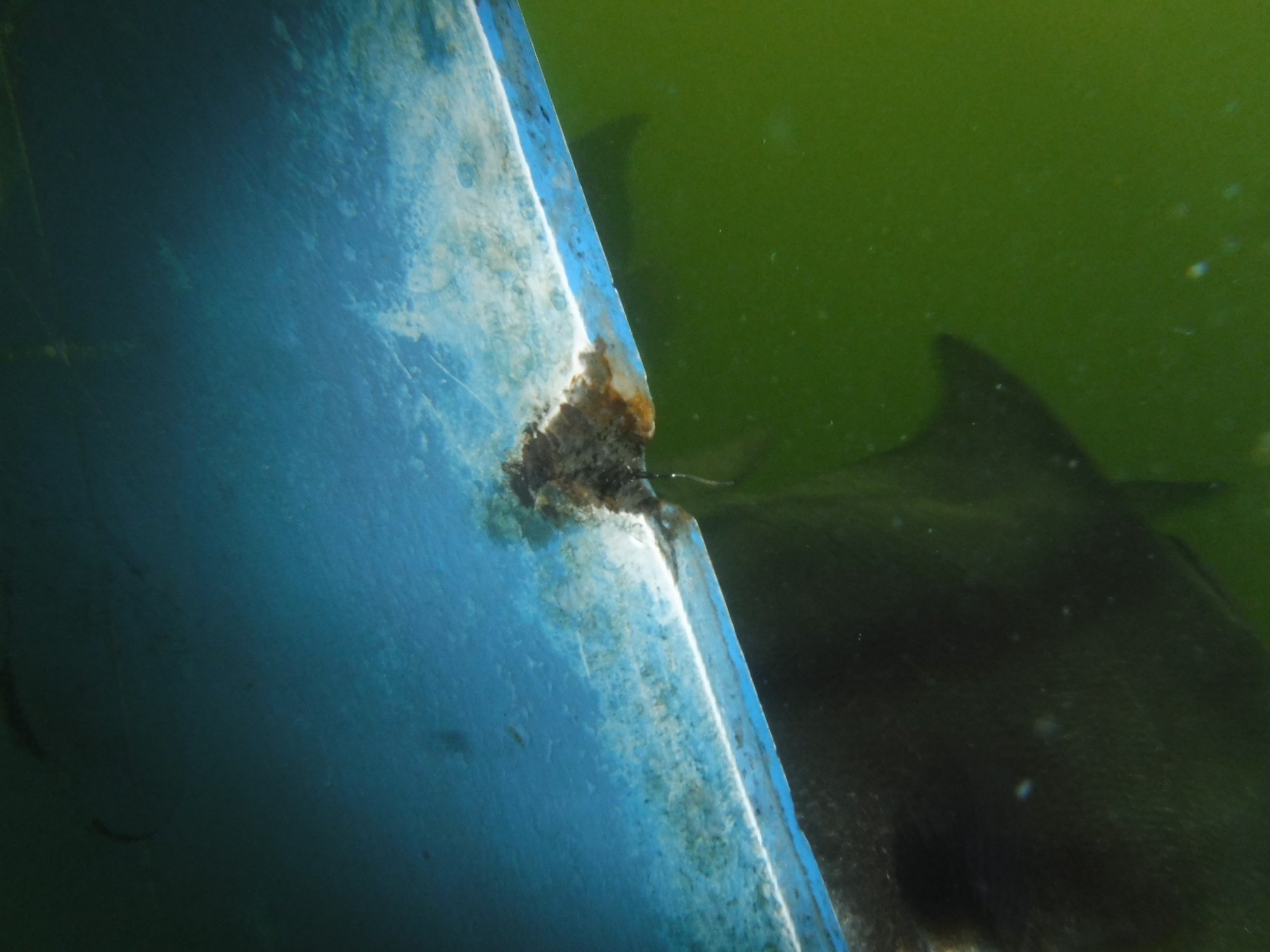

My cable snapped at the board. You can barely see a few steel strands in the photos from the diver. It isn't stuck and pivots freely so it is down. Or "was" actually as we used ratchet straps to hold it up so we can sail it from one slip to another. I was hoping an underwater cable replacement with a shackle or something could be done but it appears to be molded into the board itself, requiring a haul-out.

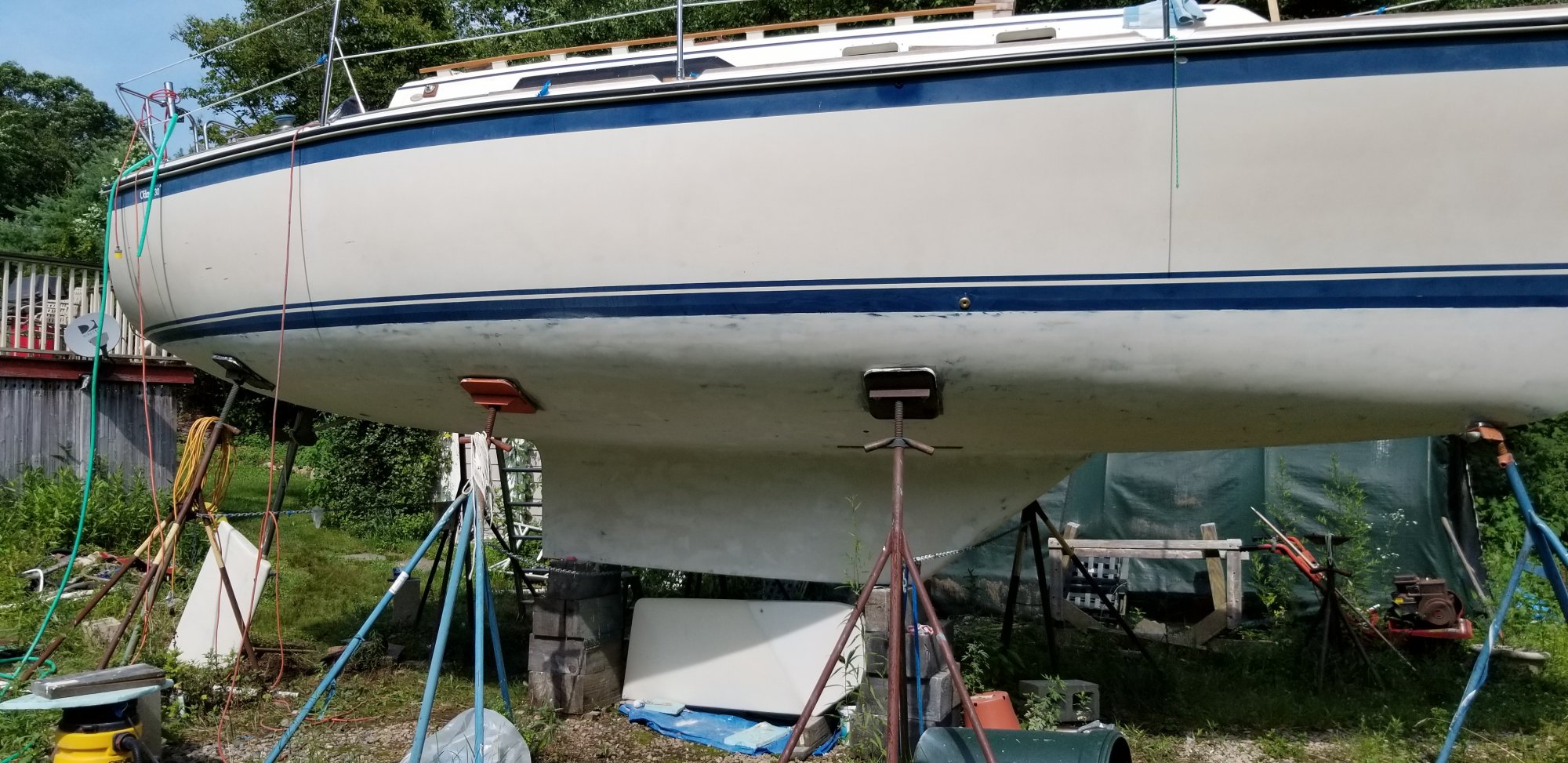

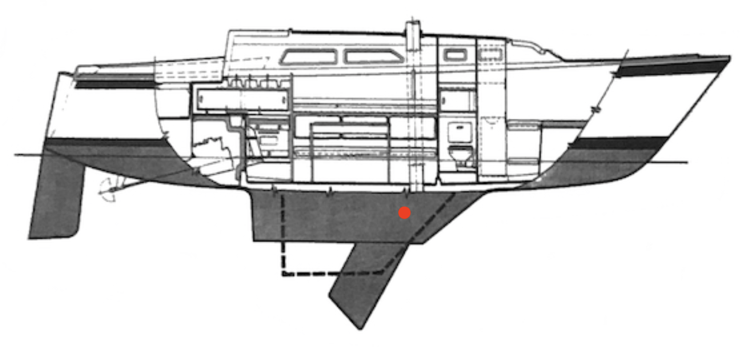

I captured this image of the boat with the CB. It may give you some ideas regarding how long the unit is. Once you get the boat up on the hard, take pictures. I'll be glad to throw my ideas in the mix regarding what the images show. From the image here taken from Sailboat Guide, I am guessing the pivot point is going to be somewhere near where the red dot is.

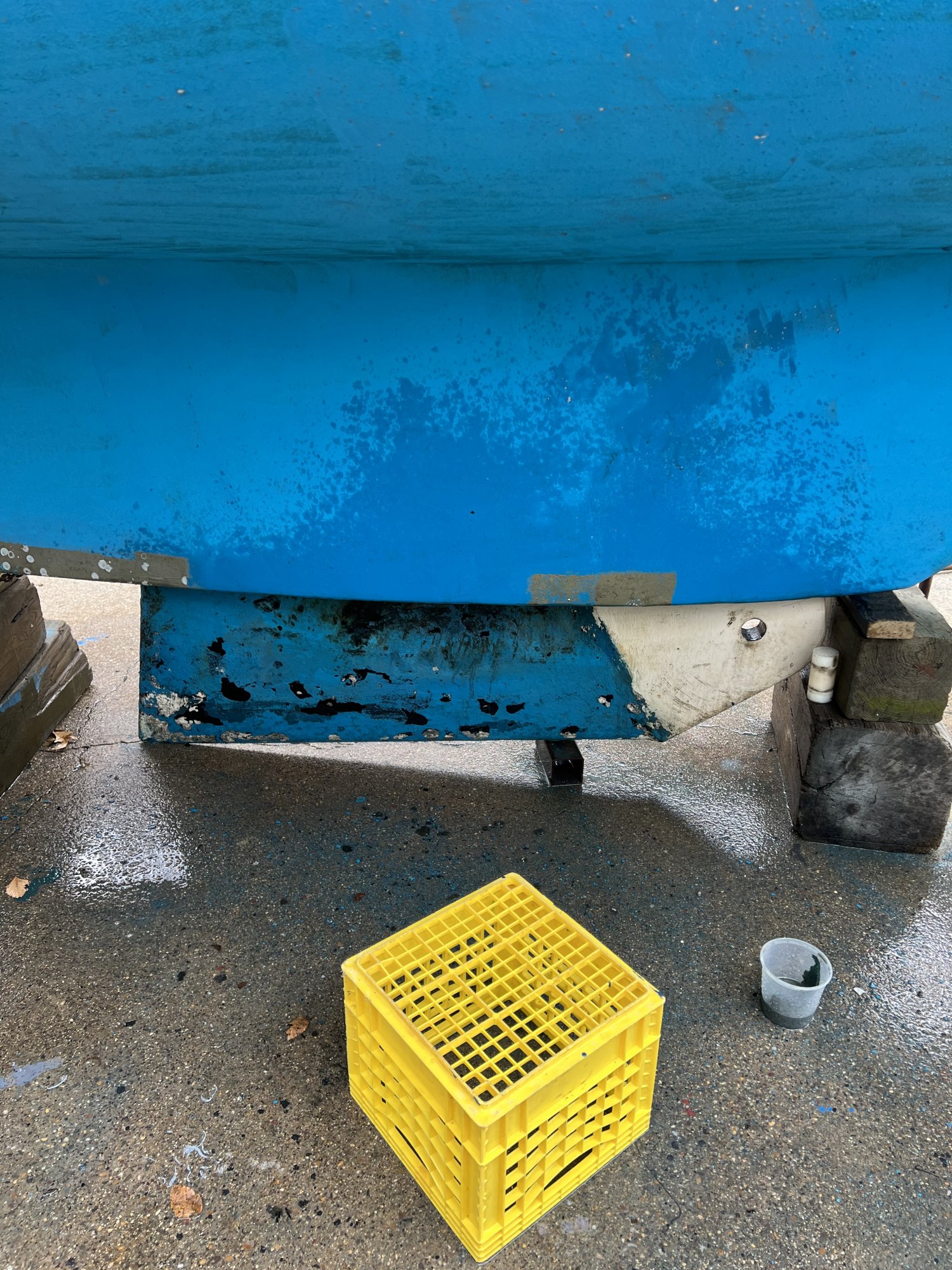

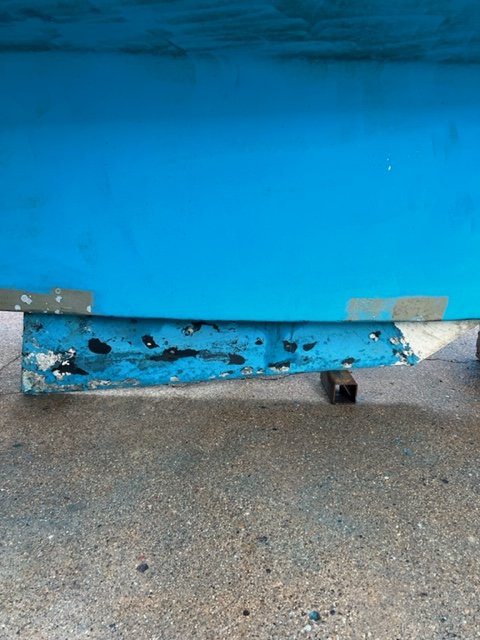

Today we have success. Center board freed but my boat isn't high enough to remove it. Next week the yard is supposed to re block the boat and give me enough space so I can remove it.

O'day 30 313 Georgetown MD

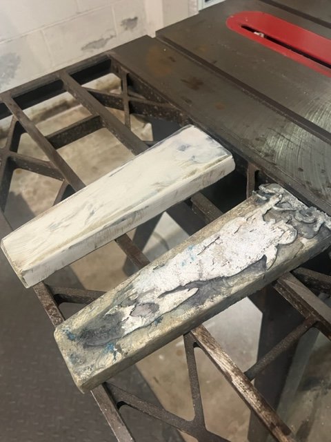

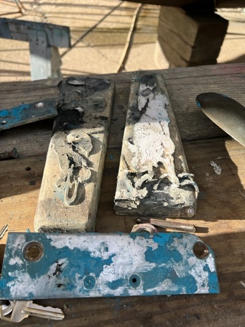

So here is a picture of how the board is at the moment. In addition, I am posting a second picture of the wedges and SS plates that hold the swivel pin in place. My question is, does it really need that much caulk on the wedges? Was this someone's attempt at overkill?
Wedge pic below

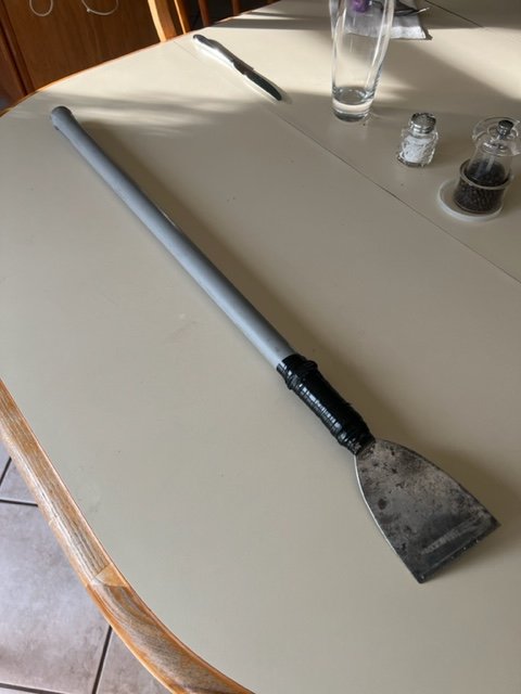

TOOL CREATION: Some folks call it a back scratcher, some even call it ugly! All I know is it is a long handled scraper to use inside the centerboard cavity area to clean the inner walls. Hey its time to get the work done with low cost tools.

I can get it down another 3 inches at the front, but still can't get it out. The Yard's equipment can't lift it any higher and the boat is blocked in with other boats, so the sling lift can't get to it. My plan is to sand, clean and paint the area I can get to, and finish the rest in the spring when the yard can get me into the sling.

I like your plan. When you get the center board lifted back into the boat, and the sling raises you up, I bet you can just lower the CB and the area that needs touch up will be accessible below the boat.

To answer your question about the caulk, I found a similar amount on my 25. The adhesive had failed long ago. Perhaps it helps to keep them in place during installation and to keep things quiet while it's in the water?
Be sure to seal the screws well. From what I can tell, the screw holes lead right inside to keel. If water gets in there it could freeze and crack the keel in the winter
