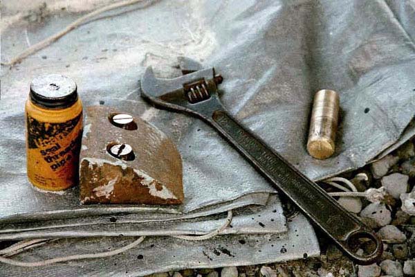

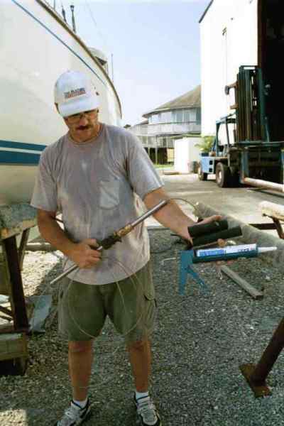

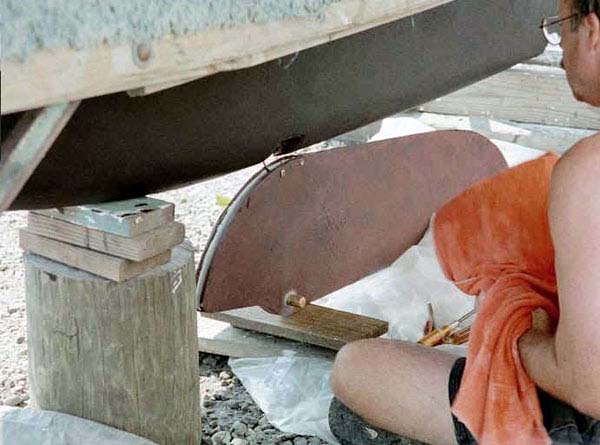

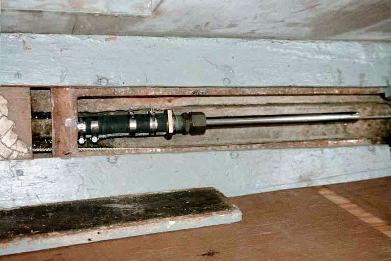

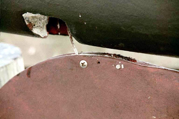

Below are some pics of a 24's equipment I got off the web some time back. Are these the same or close as a 30 Rich?
Pic 1= pivot pin and retaining blocks
Pic 2= top of board showing slot for wire
Pic 3= complete shaft/box assembly in bilge
Pic 4= complete shaft/box assembly out of boat
Pic 5= shows where pin retaining blocks go

Yup, looks like a dead-ringer for the M30. I forgot about the second turning block under the cockpit that leads the cable up to the cockpit winch, but that should be bronze as well.
Also on my M30 the cable attached to the CB in the second hole nearest the bottom tip of the CB and the swaged fitting passed under the machine screw in the upper hole on the left in your last picture above.
