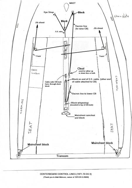

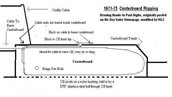

I'd check on the Day Sailer Association web site for good advice for fixing your CB. I'll post a couple of diagrams from the Manual/Rigging guide that I publish that show the rigging of your CB, might help? I also found that on my 1979 model, the forward upper corner (when raised) of the CB needs to be rounded over a bit side to side, since the CB was getting wedged in by the fact that the CB was squared off and the inside of the CB trunk is of course rounded.
I know some owners have attached a piece of stainless steel sailtrack to the top (when down) of the CB to stop the cables from cutting into the CB, this was also suggested by a former VP of O'DAY. This would run on the flat edge of the CB.
It sounds like your boat may be older than 1974, or else is an early 1974 model, since my data lists the CB rigging being changed for the 1974 models away from what you describe, a design used on the 1971-73 models.

The information you provided is dead on! The boat was manufactured August of '73, which I'm told, would make it a '74 model. The set up is the diagram you posted and I appreciate it very much. My only un-answered question is the pulley location where the cable exits the the top of the trunk. The diagram depicts a pulley extending much deeper than mine and even extends into the C/B cavity thereby holding the cable itself off of the fiberglass. Mine is cutting into the glass on the way to the pulley.

That diagram is more or less "reverse engineering", so it may or may not reflect absolute accuracy. I based it on pictures of DS IIs of that vintage, and a discussion with Rudy Nickerson of D&R Marine. Perhaps a fellow 1971-74 DS II owner can chime in, here or on the DSA web site discussion pages. I did find a picture of the fitting that leads the cable through the top of the CB trunk, but I still don't have an exact image of how the cable should lead through the fitting.....is there one sheave or two? I'll have to research it more.
