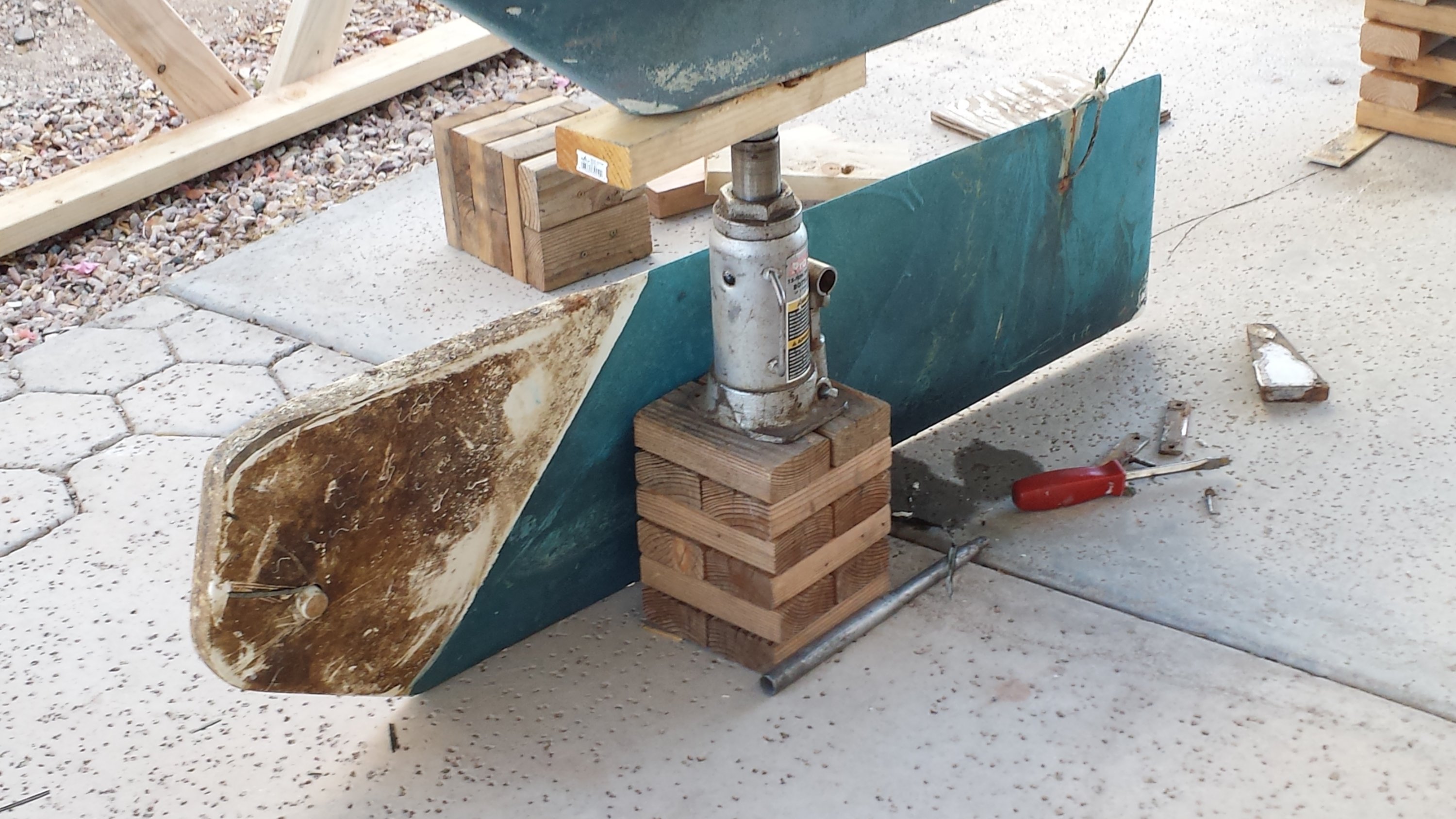

But we could not find the lift line, really not having any idea where the line may be is not helping, does anyone have a picture of a 23 or 25 with it's board down? would be very handy to know where I should be "fishing" with the boat hook.

Here is a picture of the 23 CB out. The lift line is going to be deep about 5" from the bottom of the board. You can tell from the old paint the angle of the CB.

thanks Leeandrick, I was fishing for it way too high
