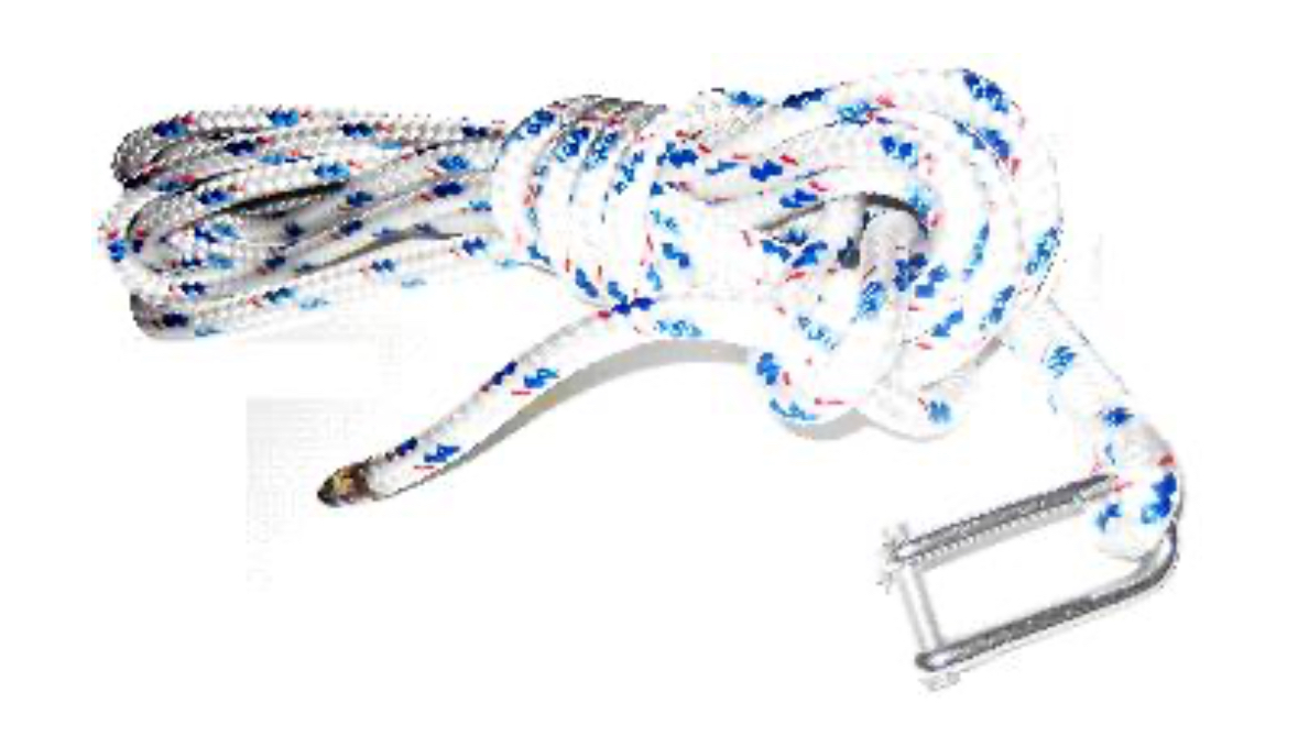

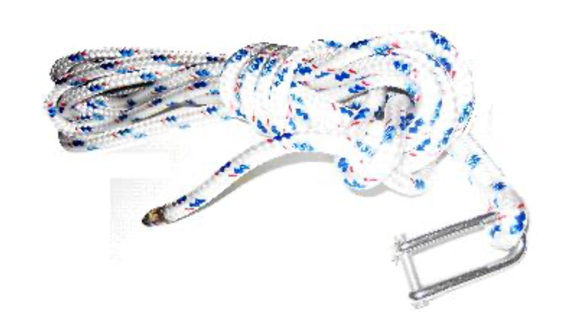

I installed a new center board line & pendent, connected the center board line shackle to the center board (it had a shackle), I know dumb to connect two shackles together. Did I say the boat is in the water , yes it’s in the water on a lift. I pulled up the center board everything worked great, but the two shackles got stuck in the top of the keel. I have tried everything to free them to no avail.
Has anyone had a shackle get stuck in the keel or to you have a though in freeing up theses shackles??
My current plan is order a new pendent line and cut off and vacate the stuck one

The center board is free. the problem is the metal pendent connected to the sheet line that runs up to the cockpit. The pendent broke away from the center board and got pulled up inside the keel. To narrow of an area to reach a hand up there about 18” to unlodge it.

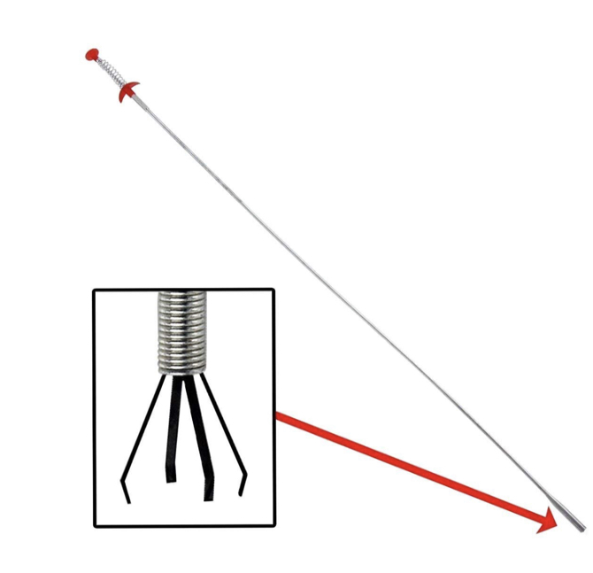

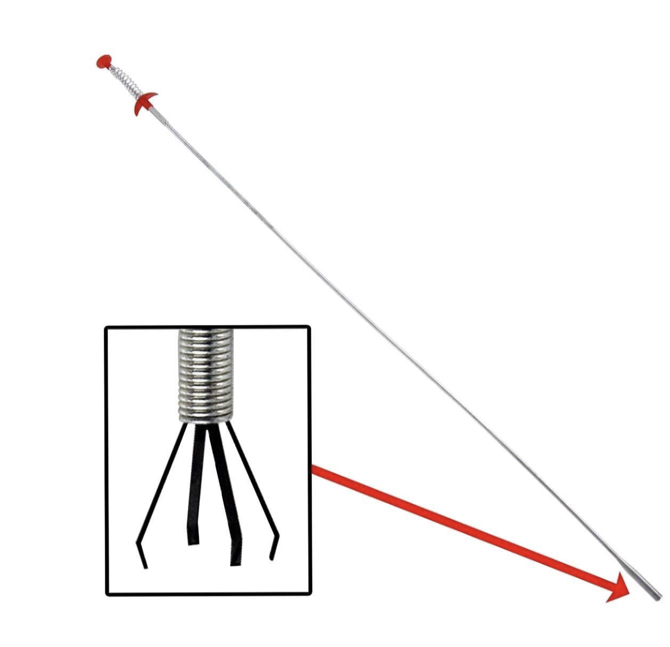

Thanks O’Day 25! I have been in the water a few times and had the shackle on a flexible grabber tool (see attached) today, but the shackle is lodged and will not move. I tried to move it with a crowbar to the forward in the keel housing, and it does not move front/back or up/ down. I think there is only the one shackle on the line after working on it today. Photo/s would be impossible with the bottom of the keel at water line and the shackle up in the keel hosing 18” (dark). Also, the area where the pendent line runs up In the keel housing is to narrow to get your hand up there to feel around :huh:.

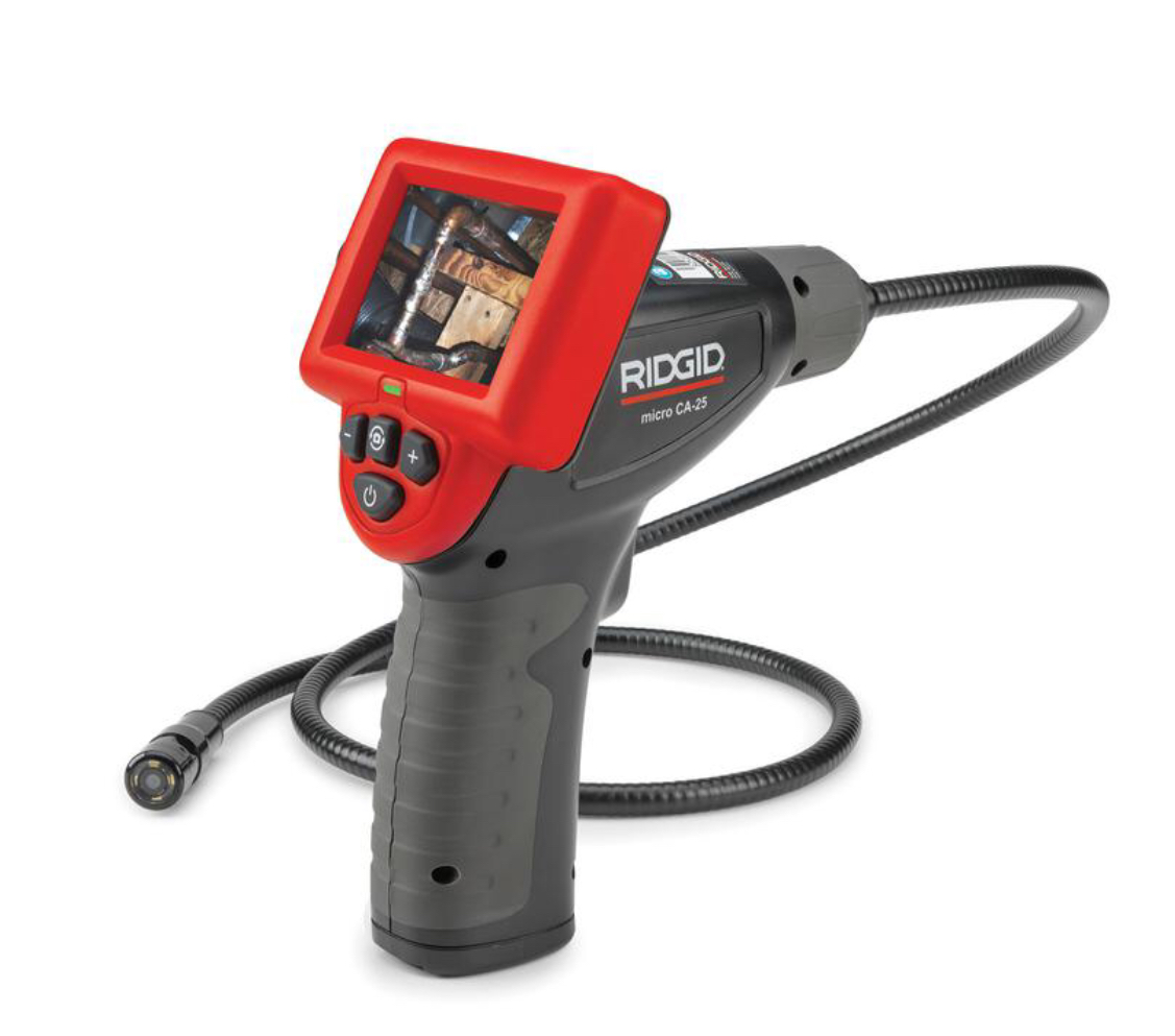

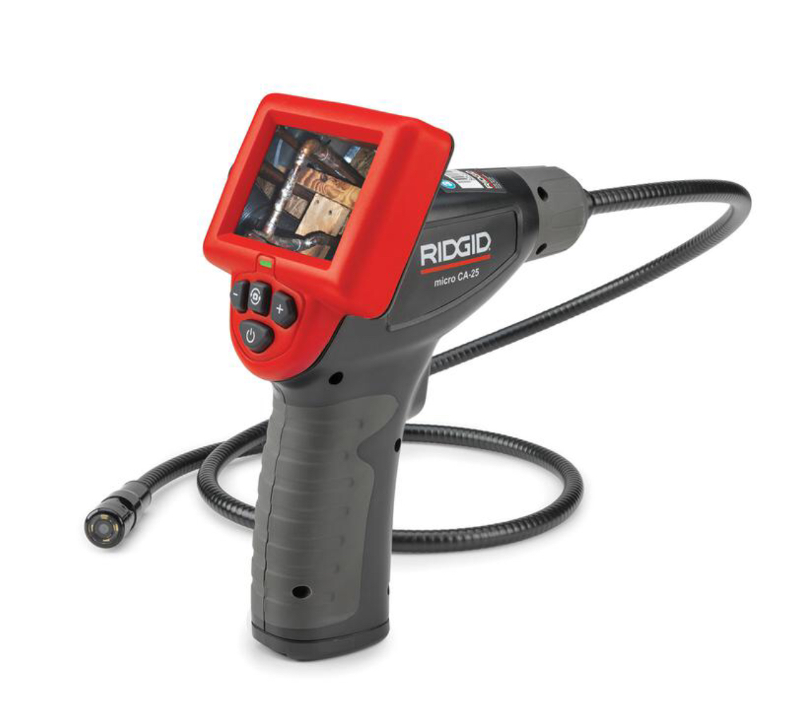

I know on the 25 there's no pulley. I'm guessing the 222 has the same, if not smaller cb. A snake camera might be a good way to go. You can get them pretty cheap online or possibly rent them from a tool supply place. I think I paid $25 for my USB cam. they're usually waterproof

Thanks O’day 25, I picked up a scope camera from Home Depot for $95 & it worked great. With the camera and a 2’ grabber it was like doing arthroscopic surgery. Shackle out and reinstalled on the centerboard.. thank you again for the scope camera thought!
