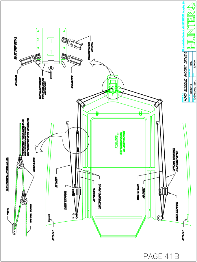

All the blocks are as in the drawing. The rollers and rope look to be in good shape (in the slot as well). The slot is very clean (no growth). The top roller has some silicone gumming up the lower part. I guess someone did that to stop a leak under the mast step plate. Can anyone tell me how to remove and clean that roller. The heads of two of the screws holding down the step plate are stripped.

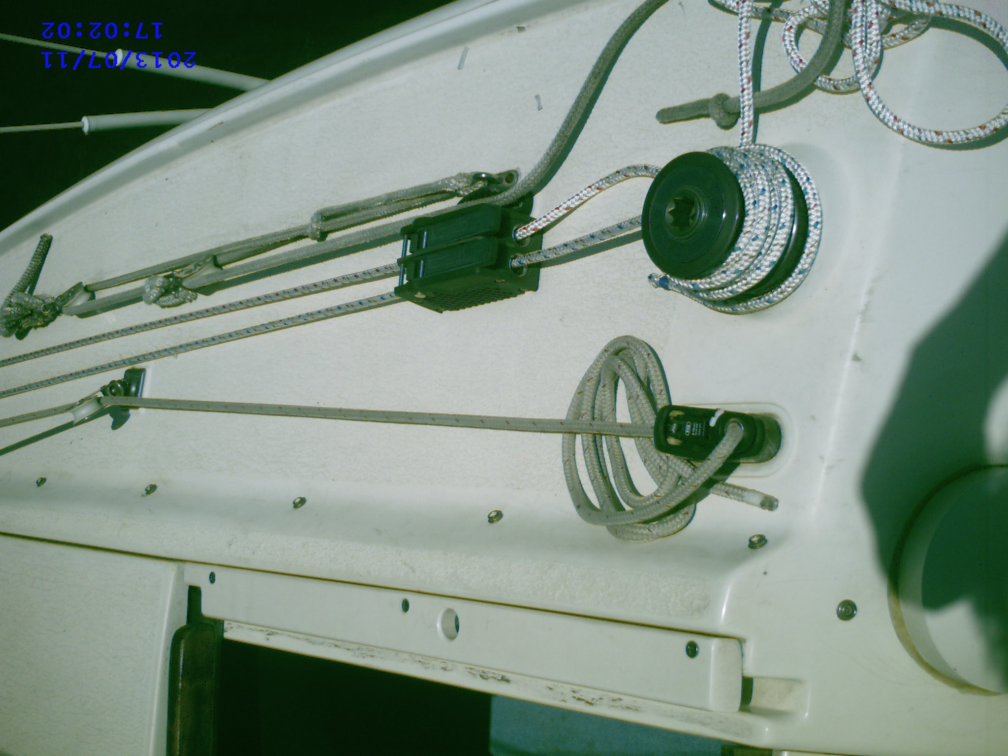

Hunter 23.5 East Chicago In
This is how rigged on my 23.5.never had problem raising buy hand,never used winch.Hope this helps
