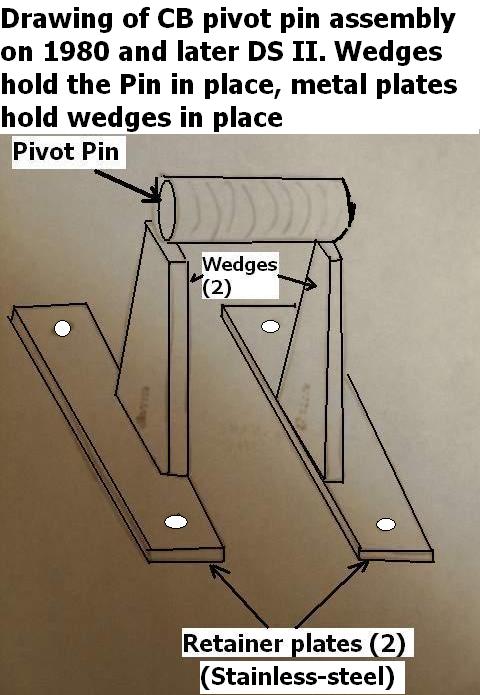

The CB pivot pin is plastic (Nylon?) and sits in a wedge-shaped recess in the fiberglass CB trunk. Below is a basic drawing of the typical O'DAY CB hanger as used on the 19, the 1980-85 DS II, the DS III, and most of the K/CB models (exceptions: 1971-74 O'DAY 23, and very early O'DAY 20)

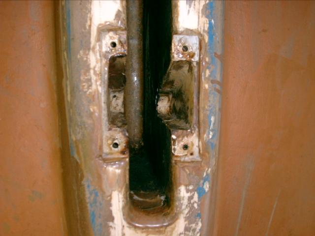

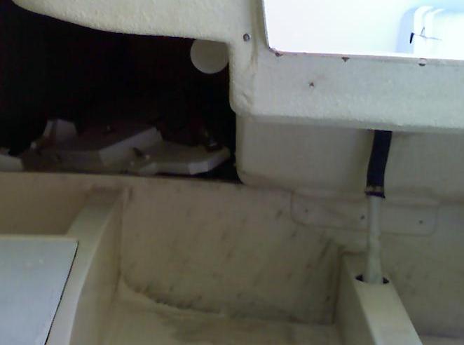

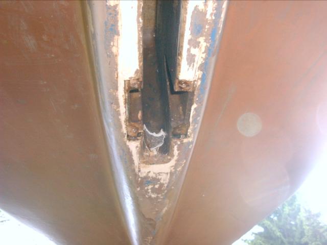

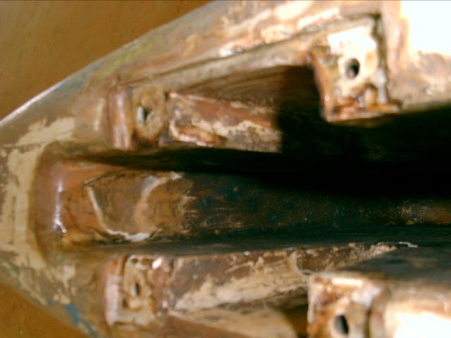

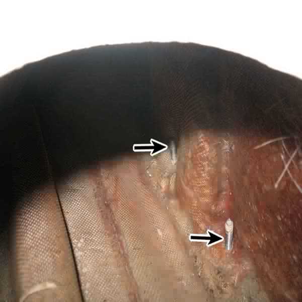

O'Day 19 centerboard pivot construction
I found some nice photos in some old posts of the O'Day 19 centerboard pivot construction. It is probably very similar for most of the smaller O'Days.
