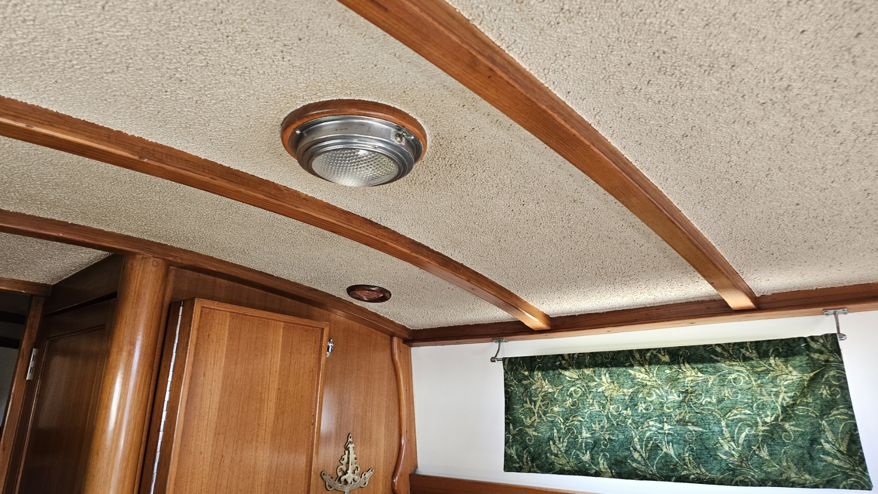

The ceiling on our boat was installed in 1975 when popcorn ceiling still seemed like a good idea. There are no glitter flecks, but they would not seem out of place.
Even if it did look good, once, it has 50 years of funk and gunk. This photo actually makes it look decent. But it is some weird PVC-like film glued to a thin plywood panel tacked to the roof between the teak beams. There is virtually no cleaning it, as the plastic is degrading such that we are afraid to touch it. What is not pictured is a small section where a previous leak caused a bit of that plywood to rot away and the plastic popcorn film to start to peel off.

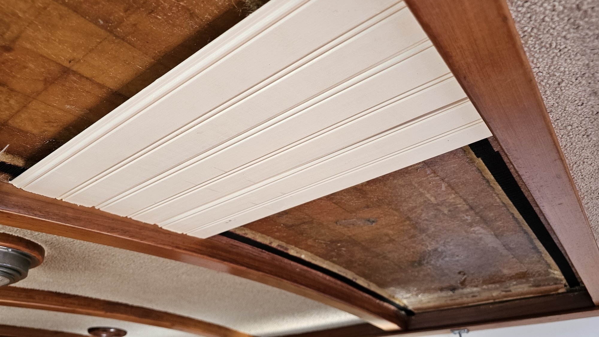

After much procrastination, we started the project of replacement, yesterday. We are installing tongue-and-groove in place of the popcorn.
So, we rough-cut a bunch of that tongue-and-groove and sealed/painted it, then headed out to pull off the first panel, not sure what we would find. I had two assumptions, though:
  1. The plywood panel would be glued to the cabin roof and we would have a bunch of scraping to do before installing anything.
  2. The cored upper deck (cabin roof) would exhibit some core damage that would have to be repaired above that spot where the panel was water-damaged.
In a series of events that rarely occurs (i.e. everything went smoothly), we had some pleasant surprises.

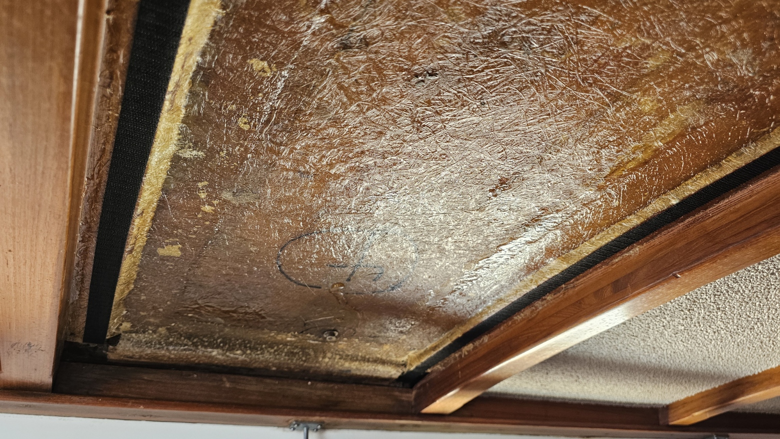

First, those panels are just tacked on with short nails and they popped right off. No glue - no cleanup - just clean, exposed fiberglass, which brings me to ...
... the discovery that the upper deck is not cored at all. There are, apparently, wooden ribs above the exposed teak beams. These are encased in a generous amount of fiberglass. But, between these ribs, it is solid glass. I can see where the leak was. A loose bolt holding on the teak rail on the upper deck had apparently been leaking. But, that bolt just goes through solid fiberglass, so no chance of core rot. The whole roof (what we've exposed so far) appears in great shape. I honestly was not expecting that.

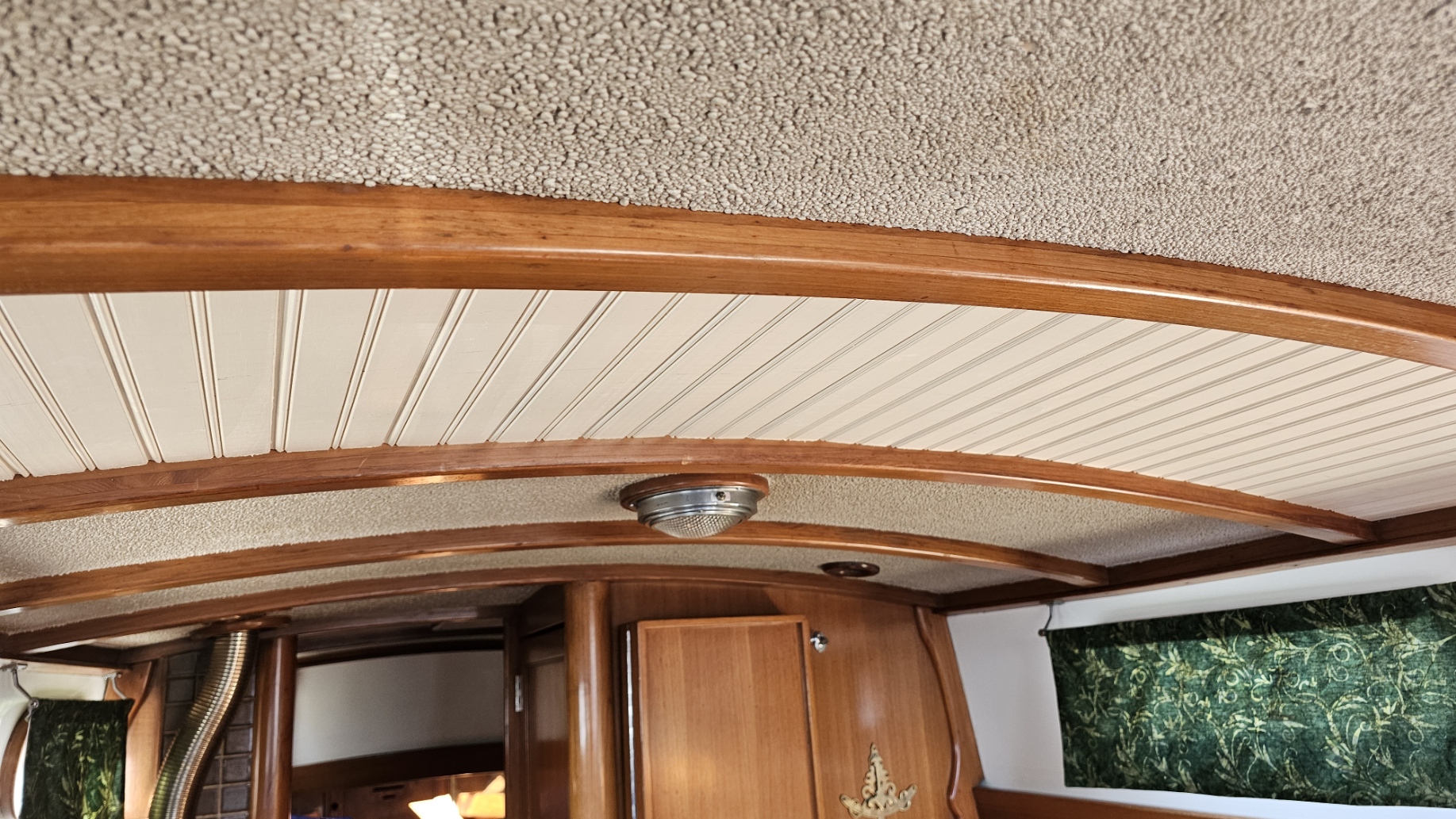

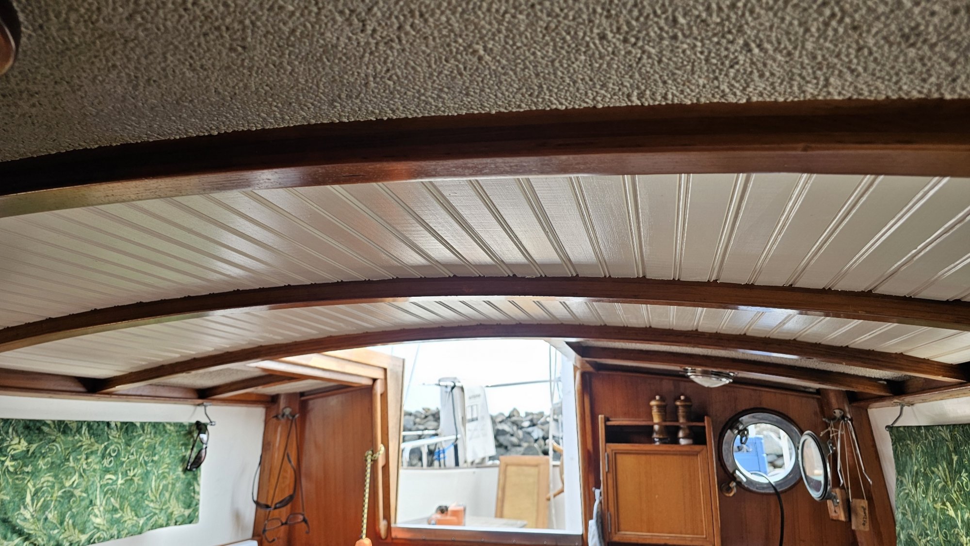

We finished the first of about 10 rows and I'm pretty pleased with the results, so far.
This is what was under the old panel:

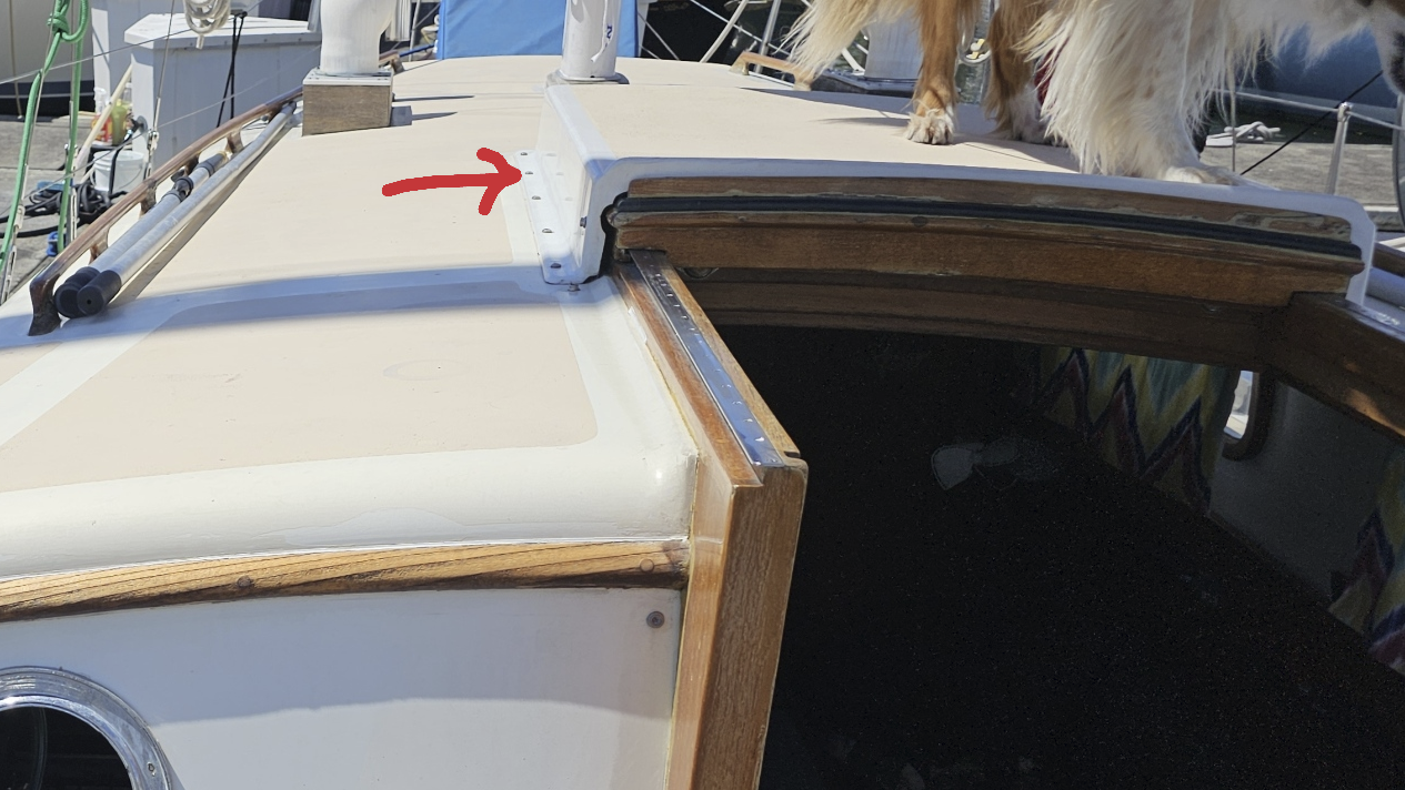

The black strips on either side are 3/4" industrial Velcro we put in place. The tongue-and-groove boards will be mounted using Velcro so that I can easily remove to inspect or repair. When we removed this panel, we came across a couple of bolts with loose nuts. They appeared to be the bolts that hold the companionway cover to the cabintop. But, upon further inspection we discovered they had been cut off from above and new screws were installed instead.
My deduction is that the cover was originally held on with bolts that were secured by nuts on the underside of the cabintop (the underbutt). For some reason, a previous owner had to remove the cover but could not access the nuts, which were covered by the ceiling panels. So, they just cut them off and replaced them with big beefy screws (which are what are currently used).

We laid a few boards to test. They are cut to more-or-less stay in place with just friction, but the Velcro just helps.
The Velcro holds almost too well, but we were really happy with the result. So, we finished the row:
You can see what a difference this is going to make.
This row took us about 3 hours and I think cost about $40-$50 - almost half that cost was just the Velcro. I did not trust my cuts to be as precise as they needed to be, so I cut everything about a millimeter too long, then used a belt sander to shave off the last tiny bit and get each angle just right. The teak beams are remarkably parallel for a boat, but not perfect. So, I had to tweak the ends just a tiny bit here and there to get a perfect fit.

We will be replacing the bolts too, I think. I need to pull that hood off to see. Maybe there is a good reason they did what they did, but I expect it is simply that they couldn't easily get to the underside. My assumption is that there is, therefore, some sort of hole on the deck surface where the bolt used to be, but which is covered by the hood. So, at very least, those holes need to be filled, if there is some good reason not to use them.
I'm a bit confused as to how it is currently screwed on. I removed one of the screws (when I discovered it was not attached to the bolt stub on the underside). It was about 1 1/4". The hood lip is maybe 1/4" thick. And, the screw does not protrude on the underside. So, that seems really thick, considering it is solid fiberglass. Of course, it was built in 1975 ... but still.
I don't know, I'll see when I get the hood off - something I'll probably do in a few weeks.

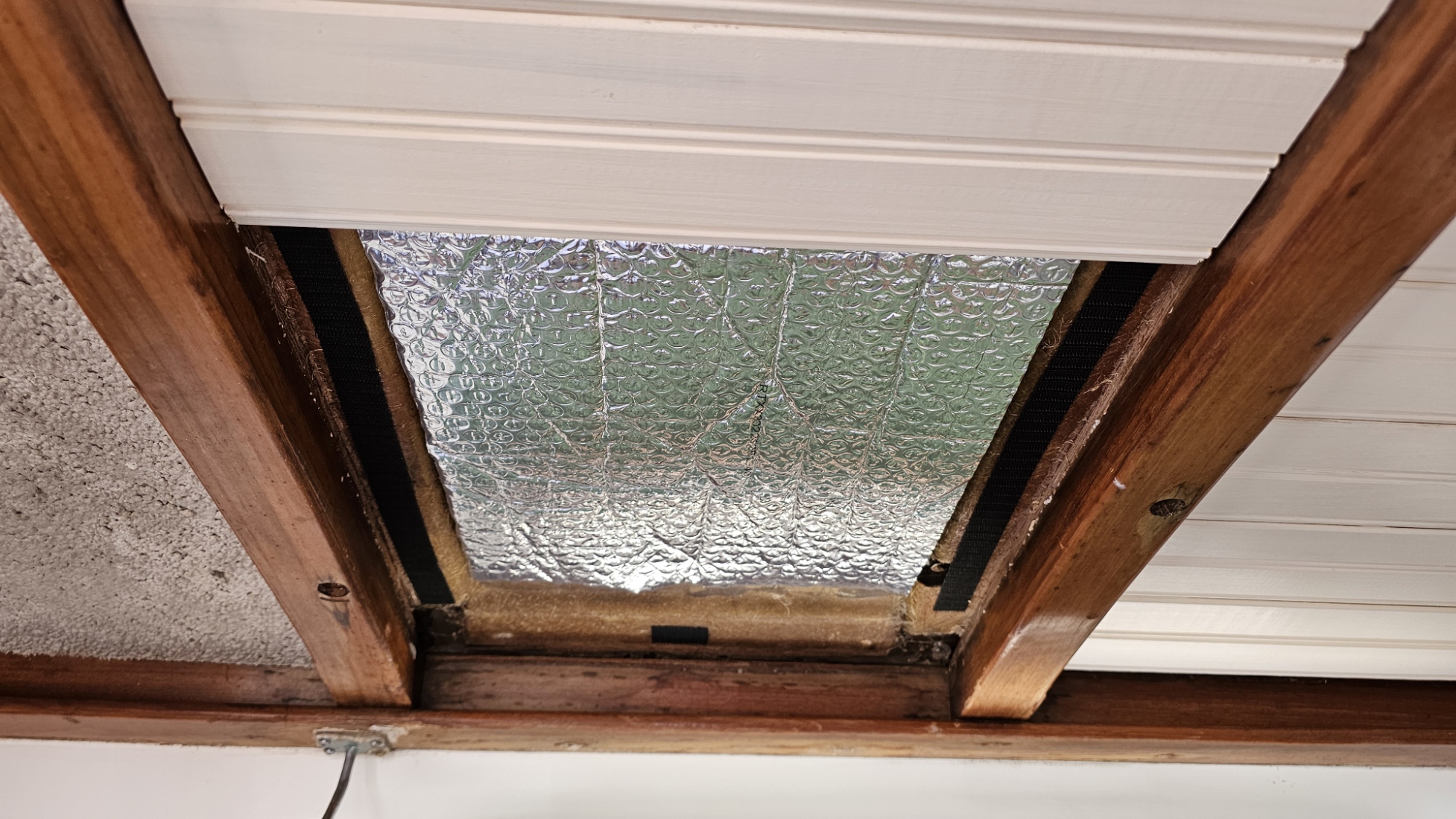

Since the panels are so easy to remove and reinstall, we pulled that first row off yesterday, laid down some insulation (thanks to @jssailem) and replaced it. This also let us tweak our placement because we found we were about 1/4" off-center, resulting in unequal pieces on the ends.

Wanted to thank @jssailem for the insulation suggestion:
We've been adding it in. (This is kind of a "before", "during" and "after" upgrade picture, from left to right.)
When we were out last week, we were getting baked by the sun. So, I went below and held the back of my hand near the ceiling. There was a palpable difference of radiant heat under the panels we had completed compared to the original plywood-only panels. I don't know how much difference, but I could feel it.

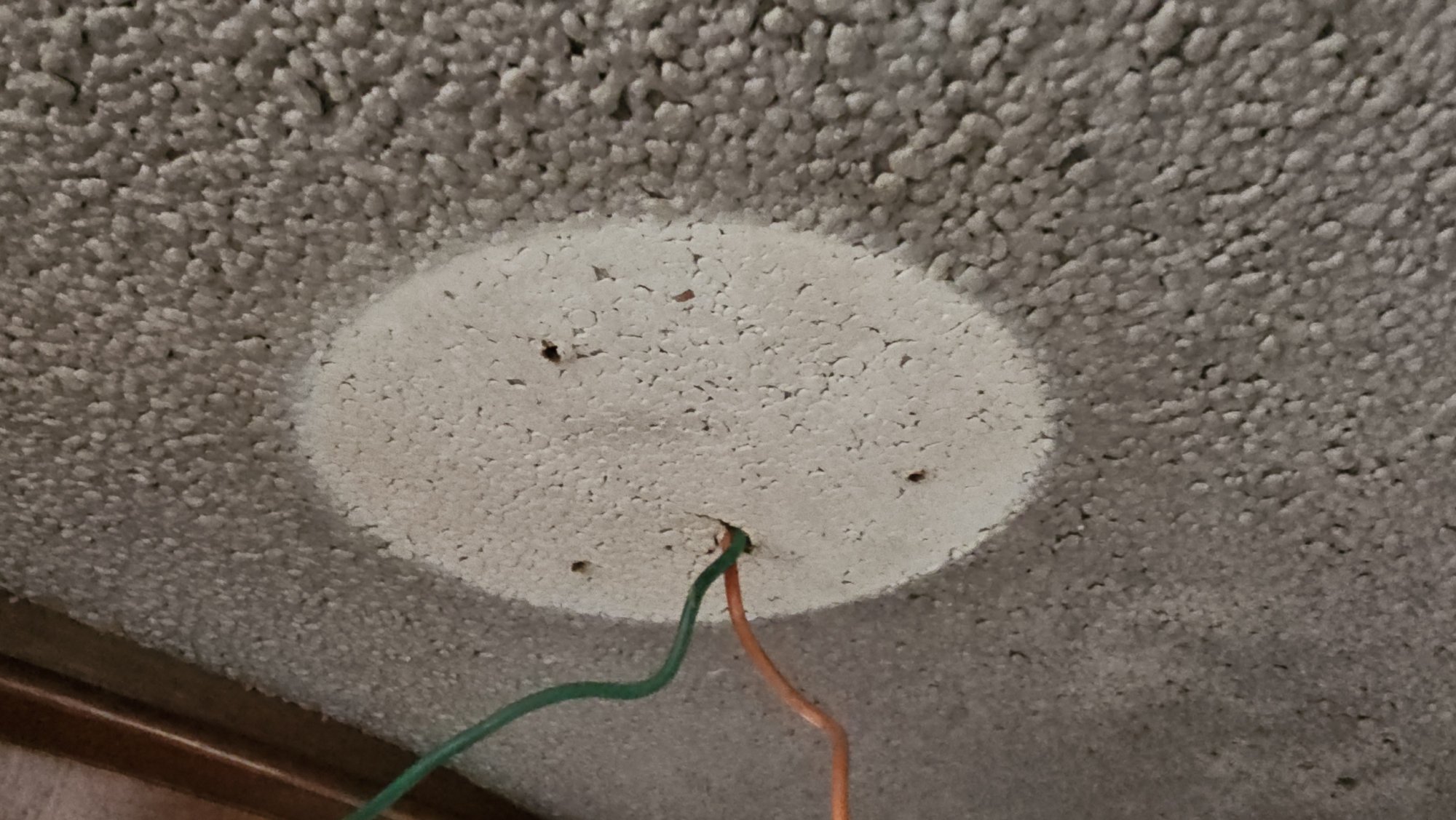

We are getting down to the last few panels that involve more custom cuts and such. We pulled off a light fixture and saw just how nasty the old panels were:

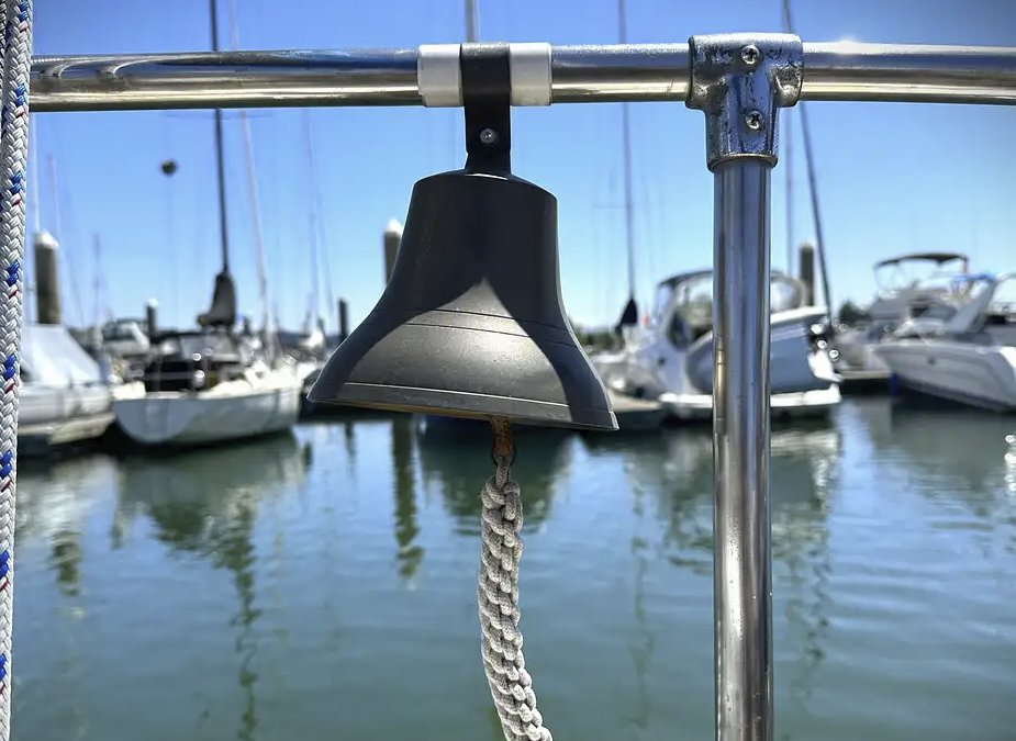

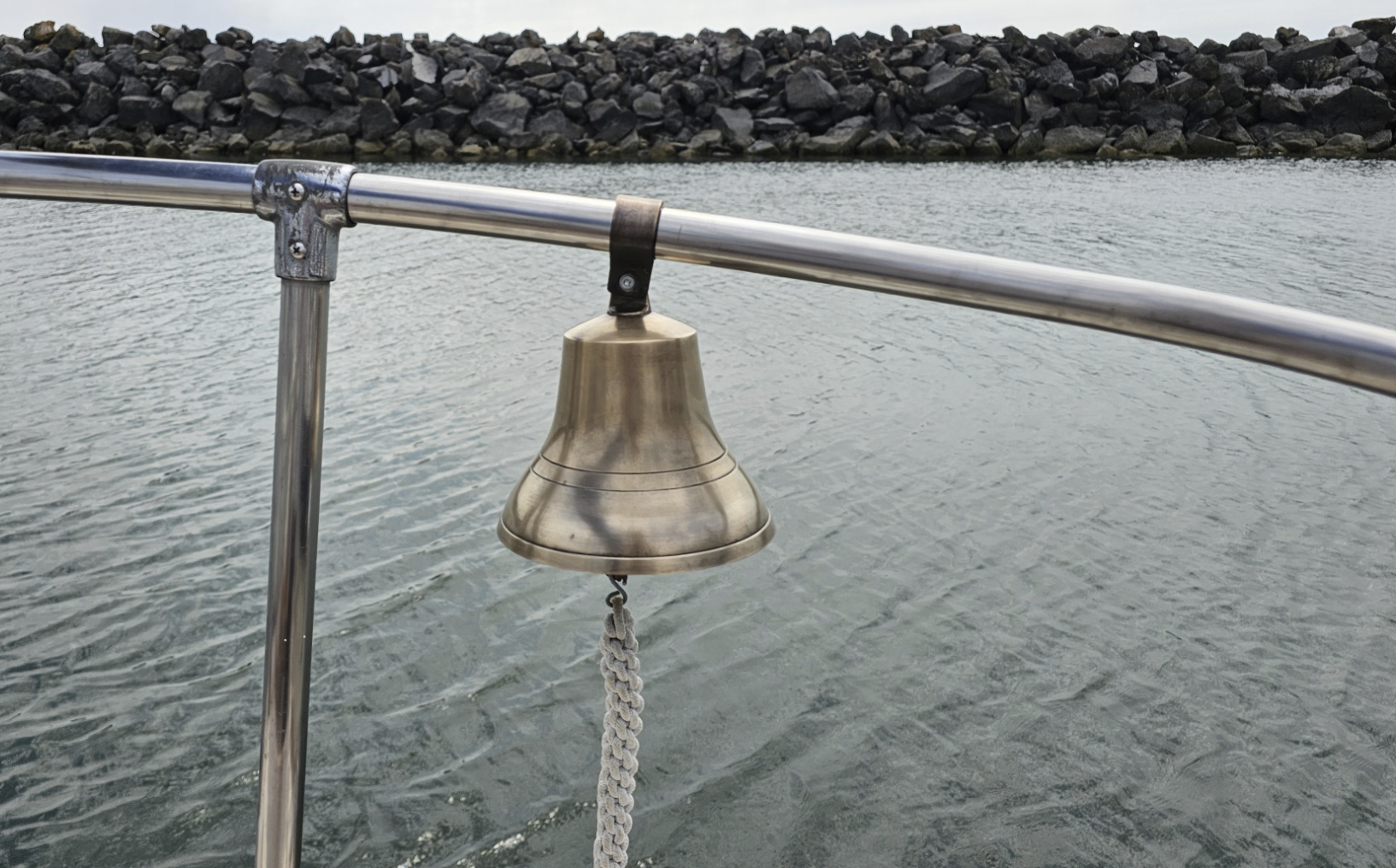

As a bonus, I did a little polishing:
Before:
After:
HAHA! Mission creep. I started working on my rigging last weekend and when I was finished, I had scraped the last of my varnish off the exterior teak. It looks fantastic. Next week maybe i'll work on the rigging.
