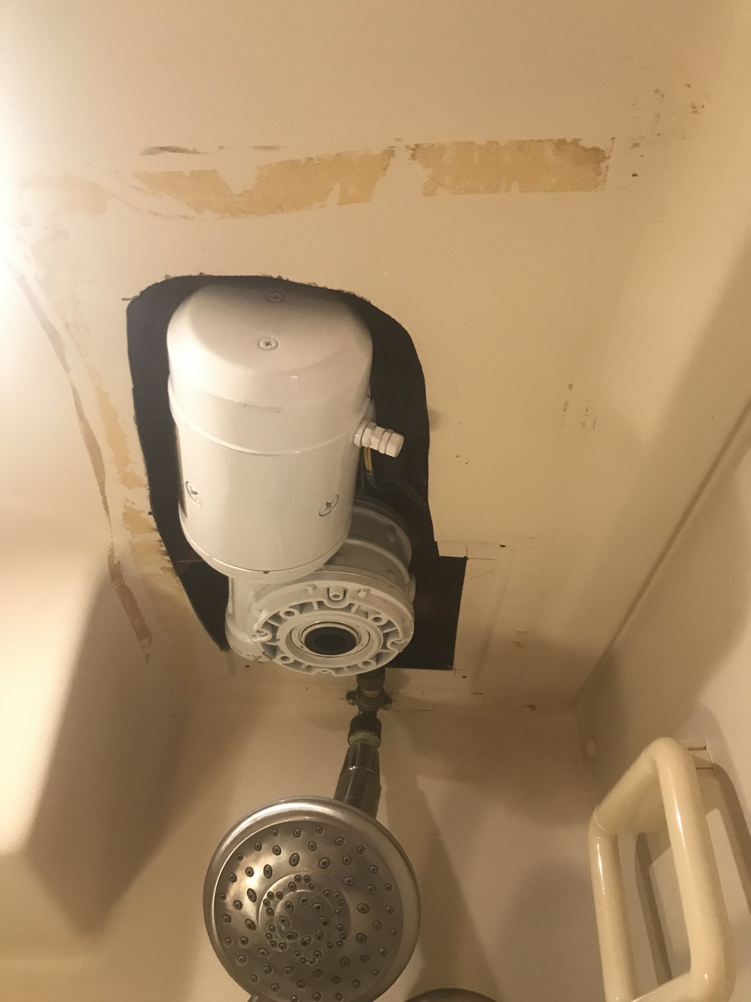

Hi all,
Looking for suggestions for something to cover wench motor that comes through head ceiling (done by previous owner). Plastic covering was there before but got old and gross. Any suggestions greatly appreciated!! Thanks in advance!

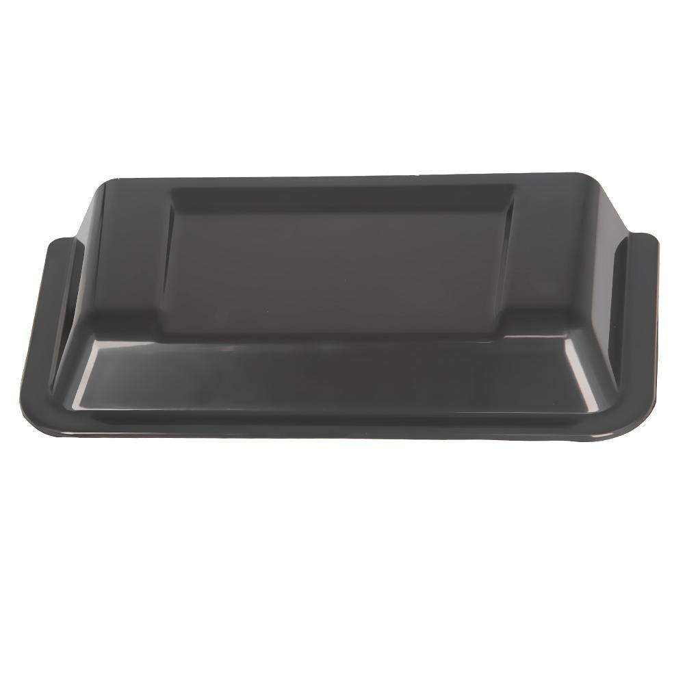

If you do an image search for plastic cowl you will find a lot of things that look like this
They come in many colors , shapes and sizes

A winch often is a source of moisture. This one looks like the motor to a windlass. (That is a system to manage the rode and anchor not a “Lass with wind in her hair”) Covering it is one thing, but caution is advised. You need to be able to get at it for regular cleaning, plan for a way to route the water and mud coming up with the rode/chain, and a way to clean up the splatter that will be disassociated with the sea bottom.

First you will need a way to transfer that shape to a working surface. I would hate to do this over my head. You need a dead soft material that will hold its shape. Some types of wire might do it. Maybe some annealed Copper wire. .That's all I've got.
