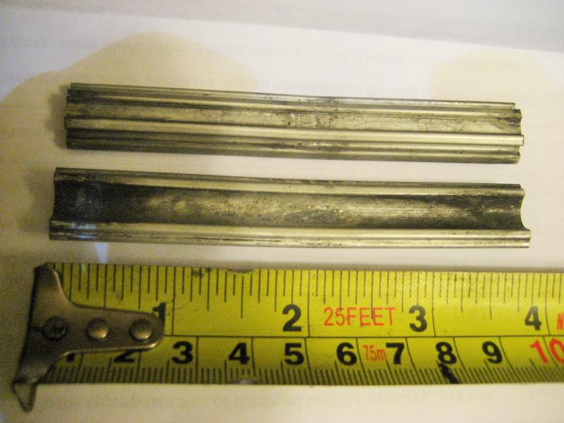

I have the Reefer II on my C-27. Someone broke the sections when the decided it was easier then taking them apart. They no longer have parts for mine. The technician suggest that I do what they do and that is to use the half lengths of the torque links instead of the full lengths, as they were broken in half. I repinged the channel to keep them in place and inserted the short sections of torque links. I duck taped the sections together for a little more stability. They have held for the past three years and still work just fine.

You can see the factory ping that prevents the torque insert from sliding down. If you use half an insert re-ping half way between the factory ping and the end of the foil.
As mentioned before I used duct tape (the plastic kind) to stabilize the joints, so they don't pull apart while assembling. I have heard of others who have used a low temp aluminum braise to weld the joints.

Holds the links together. The torque links and teflon bearings go in the joints to keep the sections aligned.
caguy
Sep 22, 2006
4,004
It does but with only 2" inserts its a lot less stable.

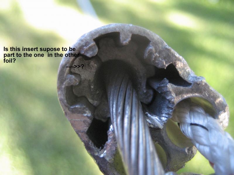

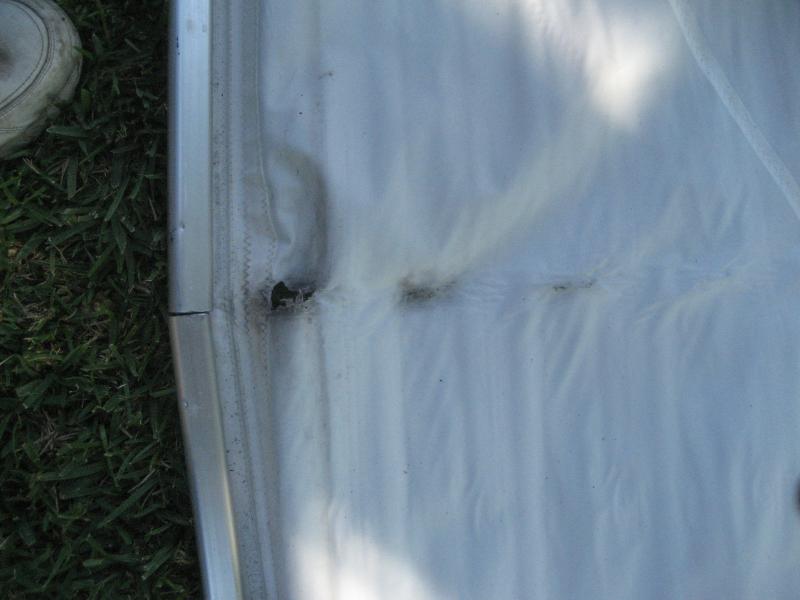

Thanks for all the information. I guess we will have to wait until Spring to go up on a chair to see what is happened up on the furler, and then see what we really need to do about it. Again, thanks for the photos especially, they say a thousand words. Ted

It was held together by what were called torque links..that had small fins that fit into a like mated
extrusion above or below...the alum extrusion has more longevity than the drum..I don't believe
Cruising Design has more of the torque links but I have maybe 3 or 4 of hem....extras they sent me a long time ago...some one should manufacture them....need an aluminum foundry...
