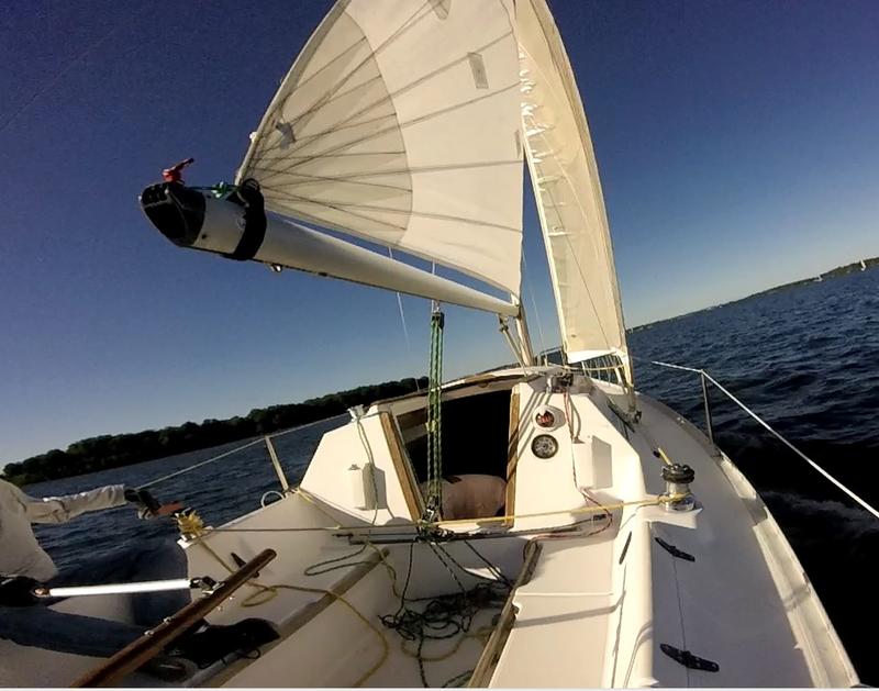

For you all that own a CDI furler, you know that the halyard situation is not the best. I find mine doing a little stretch and slip resulting in not the best tension on the genoa's luff. (See pic below).
So what have you done to remedy this situation?

hoist it up hard as you can then tighten the downhaul line at the bottom of the grommet as tight as you can or the lasing ...what ever you have......the lines do stretch ...maybe some dyneema line.....

Replace with a Schaefer Snap-Furl that uses the original jib halyard to tension the luff?
Most people I know with CDI get the jib up in spring, and that's where it stays until haul out. And most people I know with CDI do not race at all. I know you and Jackdaw will be squeezing for all the performance you can...
In my very limited experience with a CDI on a Com-Pac 19, it seemed if I hauled on the halyard too much, it made the foil go more bendy and wavy. On that boat, the foil wasn't especially straight to begin with. Also, was an older version of the furler that had only 1 shackle to tie off the tack and the halyard.
I suppose an argument could be made that the flat foil of a CDI creates less turbulence than the round shaped Snap-Furl, but I bet the ability to control luff tension a bit can make up for that.

The CDI internal halyard is a clever way to keep product costs down as it eliminates the top swivel and greatly simplifies the bottom one. But it for sure introduces performance issues, halyard tension being the big one.
First make sure the jib slides OK in the groove; pull it down and hit the luff tape with McLube. Then play with it. The cheap line they use stretches. So pre-tension it so the luff will look OK in 10 knots. Sadly that will be over-tight for light airs unless you adjust it. Use a GOOD KNOT that will not slip. Mark the line with one or more positions you can pre-set based on conditions. As you know we adjust halyard tension continually, before and during the race.
Its why CDIs are not common on really racy boats. But the 235 can do just fine with it. Fix your traveler and vang first. Those two things are diabolical on your boat!
