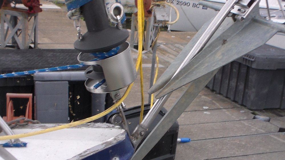

I got the genoa twisted somehow on the flex furler , such that the halyard is looped over the top of the luff piece at the masthead, I think. Consequently the furling drum assembly is lifted several inches out of the cup. The furling line got snagged around the turnbuckle and I thought I had to cut it away (which may have been a mistake). Anyway now there are a couple of pieces of 1/4" double braid furling line wrapped on the turnbuckle under the drum.

The angle of the furling line is too high. Hard pulling on the line at that angle will lift the drum on a CDI fuller. Lower the last fairlead to be closer to the deck.

Then you need to fix (at least) two things that I can see from the pictures:
1. Untie the integral halard. When you hoisted the sail last time, you wrapped it around the plastic extrusion. Make sure it's not wrapped around the extrusion and re-tie it. Then re hoist the sail, taking care to feed the sail into the feeder carefully so you don't damage the sail or the feeder.
2. As Jackdaw pointed out, you need to fix the way the furling line goes into the drum. It is hitting the drum too high up, and that's why the drum is lifting up. The line should enter the drum half way up the window when the drum is down, and be 90 degrees to the forestay.

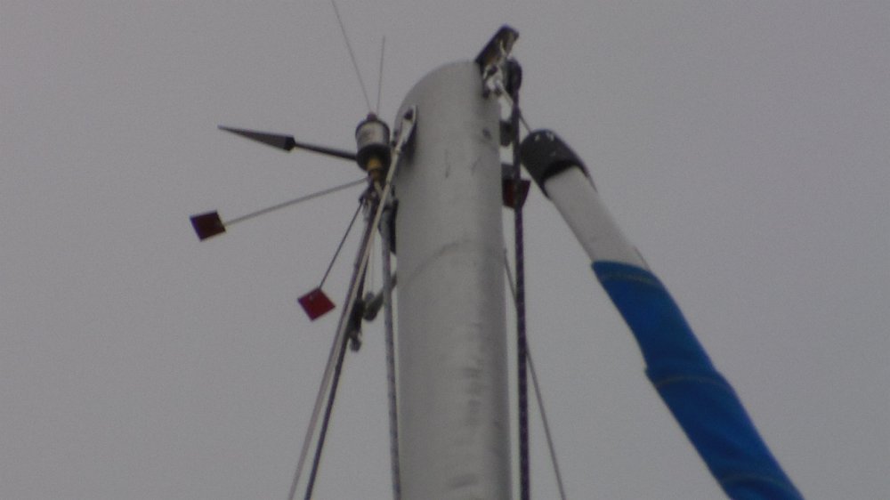

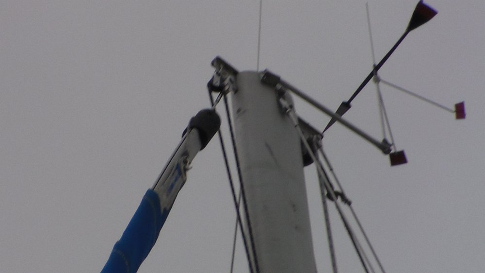

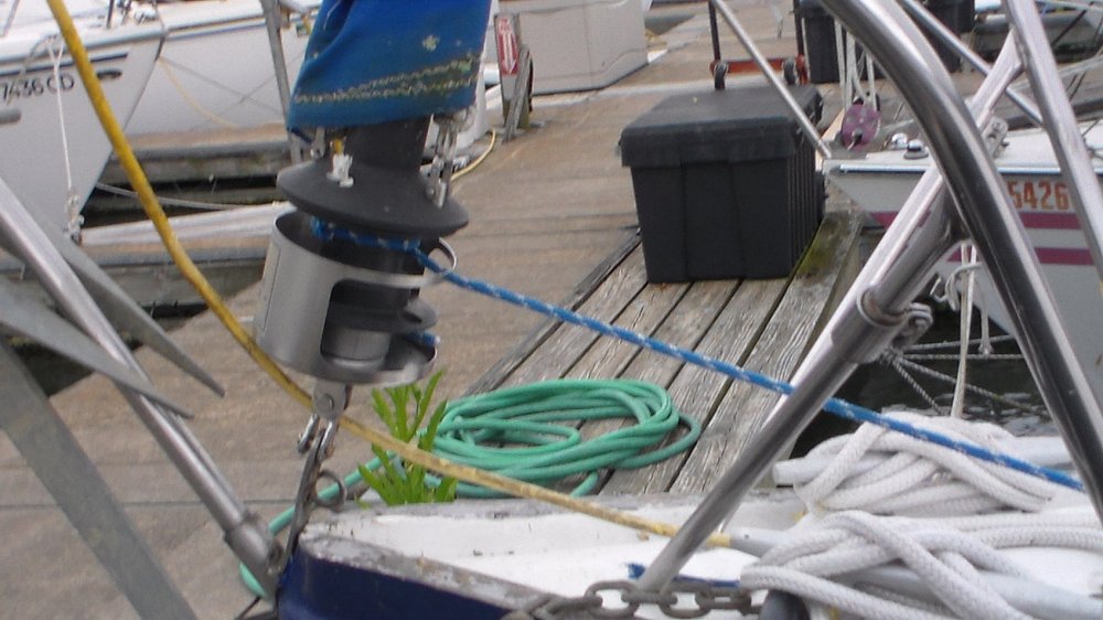

What happened was I was wing and wing with the genoa out to port. A hard gust from more on the port quarter than dead astern combined with yawing to port took the sail around the headstay clockwise. After a while I jibed over on a starboard tack and got the sail back right but was unable to roll it up because, apparently, the furling drum had ridden up and the line had got looped/jammed on the turnbackle under the drum. I furled it manually by going up on the foredeck and turning it by hand. Later I tried to sort it out at the dock but couldn't get the furling drum further up to expose the turnbuckle and clear the furling line or back down into the cup assembly where it should ride. I cut the line away from the tangle and re- wrapped it on the drum so that it is operable again but with the drum not seated down in the cup, the line chafes against the sharp bottom edge of the top of the window in the cup, which will chew through the line quickly.
I posted another picture of the bottom assembly from a different angle. In the pictures you can see the cut piece of line poking out below the drum.
Jackdaw, the angle you see in the picture is because the drum is lifted up out of the cup - if it was properly seated in there then the line wouldn't be up against the top of the window in the cup assembly.

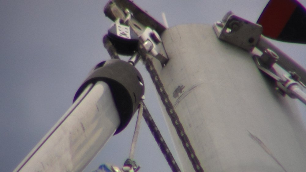

Something is applying upwards tension on the furling drum assembly. From the picture I shot of the masthead it appears to me that the furler's internal halyard top sheave assembly is messed up somehow. I've posted another shot of the masthead from the starboard bow, looks like the sheave is partly exposed.

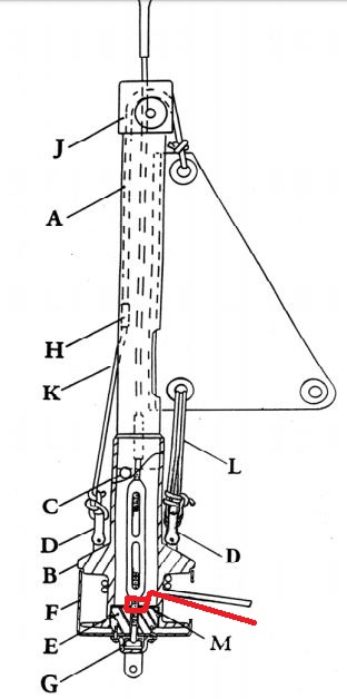

The upward force on the furling drum was due to it being held tight against the luff piece (a.k.a. the plastic extrusion) by the internal halyard. In other words the furling drum, luff piece, and top fitting were jammed tight together and snagged up near the masthead. I pulled out the luff support pin (hat tip to twalker #11) and immediately the luff piece dropped into the furling drum, releasing the tension, and the furling drum dropped back down into the cup where it belongs. Must've unsnagged at the masthead too because I was now able to slide the whole assembly several inches up and down the forestay. I lifted the assembly far enough to expose the headstay turnbuckle and get the snagged piece of furling line out (it was wrapped tightly around the bottom turnbuckle bolt, the red lines on the attached diagram). So now I could release the internal halyard and undo the tack fitting and pull the luff piece out of the furling drum, rotate the drum independently to rewind the furling line onto the drum, reinsert the luff support pin and reinsert the luff piece into the drum, then pull the furling line and voila, the sail rolled up nicely. Rolled it in and out several times and all seems to be working as it should.
Only problem is the internal halyard is still jammed. I took some more pictures and it appears to me that the halyard is off the sheave, and the sheave pin is possibly broken. I don't actually need to lower the sail and don't see why I can't sail it this way, but, I will have my son out Wednesday and hopefully we can undo the headstay and slide the furler off to get at and fix the halyard fitting at the top of the luff piece.Diagram.JPG SAM_0292.JPG
