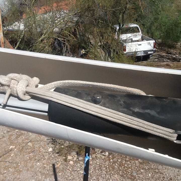

I cannot get that drum off far enough to see inside, because the fore-stay is "too short" to slide the aluminum profile up - if that makes sense. Please see the top:
Last spring it worked perfectly fine, but over the summer 2015 it got harder and harder to turn it.
Thank you guys for sharing ideas here!
There should be a clevis pin just a bit above the drum. Pull the ring ding keeper and then the pin, and you should be able to raise the drum enough to see the turnbuckle. Good luck.

There should be a clevis pin just a bit above the drum. Pull the ring ding keeper and then the pin, and you should be able to raise the drum ...
Thank you! I actually removed that pin, and I am able to slide the drum up and down by about 1 in. That way i can see, that the plastic piece inside seems to be good. Also i can see the turnbuckle's top bolt (with a reception for a 5mm wrench)
Maybe i need to use more WD40 to be able to unscrew that turnbuckle ;)

You're welcome. Get some photos of your stuff and post them here, eh?
Note how many threads are exposed on the turnbuckle for reassembly, then remove the turnbuckle completely. You should be able to pull the entire forestay out from the top.
Good luck.
