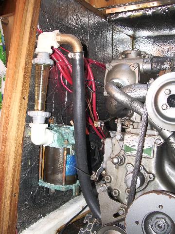

I had the same problem with never knowing if the sea water pump had lost its prime or the mixing elbow was blocked. Scrounging around a surplus store one day led me to this 10 gpm flow meter that I installed after the strainer. At 3200 rpm it indicates 7.5 gpm which is just what my service manual says is the capacity of the pump. At idle I see about 2.5 gpm. If it reads zero suddenly, that would indicate no water in the pump. If I see a general taper off of the expected flow it has been due to clogging in the strainer or intake through hull. I haven't experienced a blocked mixing elbow (yet). I try and ream that out every so often when I remember.
