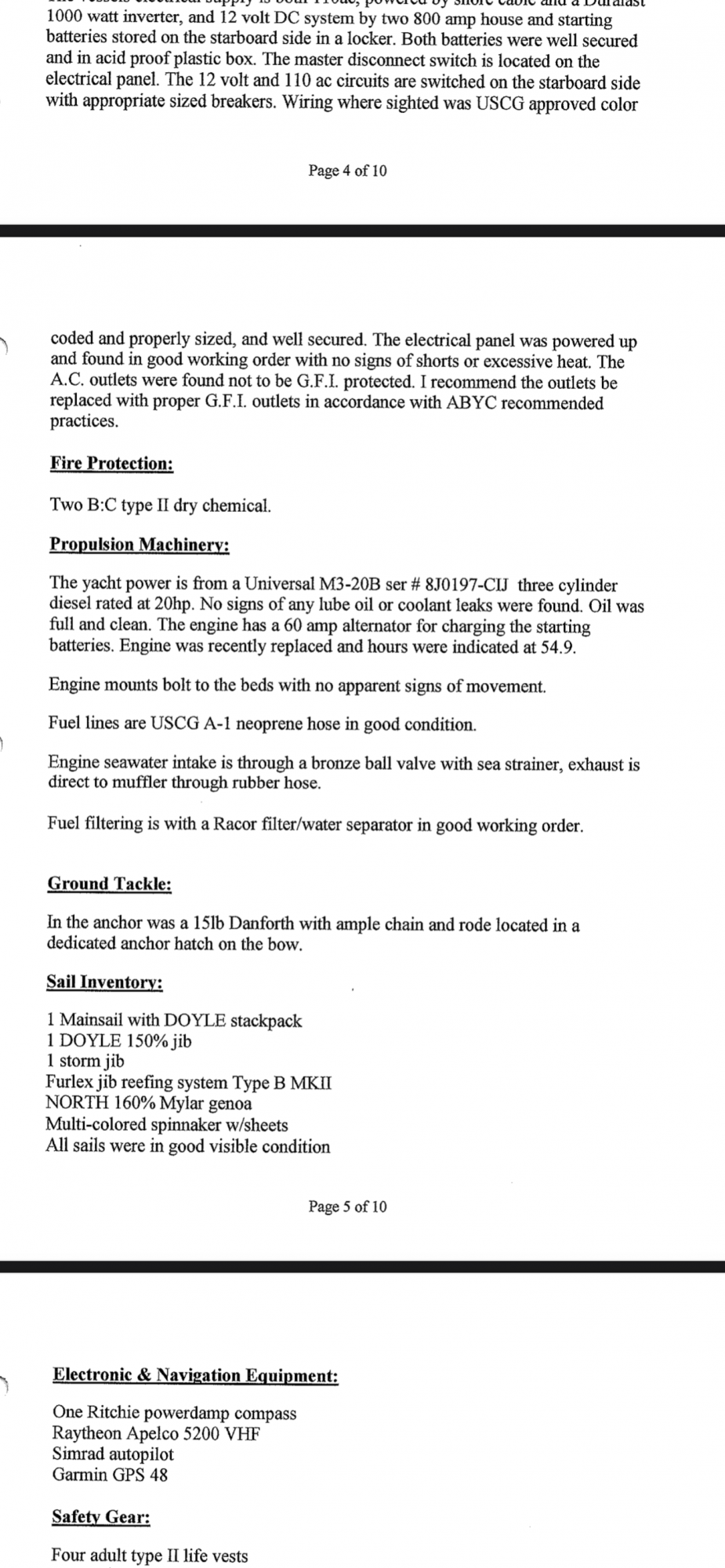

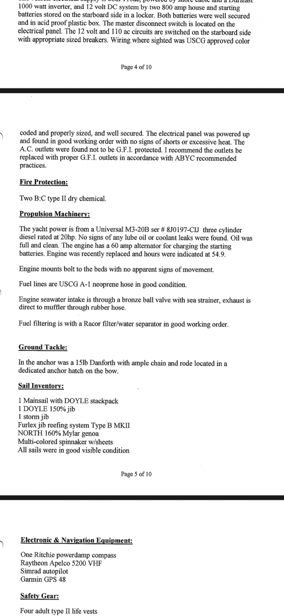

I’m told it’s a universal 20hp diesel, with low hours.
jb, Universal didn't make a 20 hp, Westerbeke may have. An M25 is 21 hp, an M25XP is 23 hp (but they didn't start installing them until 1987) in Catalinas.
