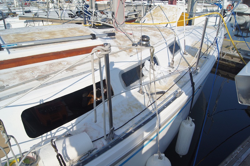

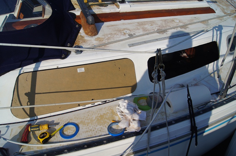

Ok now that the pictures are up, what was the point? ;)
Because I have a boat load of questions.
What did you use to seal and mount the windows?
How did you hold them in place while it cured?
Were your window openings indented or flush with the cabin surface?
How did you cut the acrylic?
Did you bevel the edges with a router or by hand tool?
How are you trimming the inside edge of the fiberglass?
BTW: The windows look great.
Jul 8, 2011
704
Catalina 30 Sidney B.C.
Yu have'nt seen nothing yet we have not taken the paper off this side and you only see open holes except for the one window
Dow corning 795 black
Held for 30 seconds even on a curved cabin
they had no indentations around windows ..surface mount
I purchased the windows from Cruising concepts and they are great , inside frames and all
Thanks we are impressed with the look

So the 795 cured in 30 seconds? Wow. I read some where that it was recommended to drill holes for screws to hold the windows in place waiting for the cure, then remove screws and fill holes with silicone. I new there had to be a better way.
Better living through chemistry.
Congratulations on a beautiful job.
