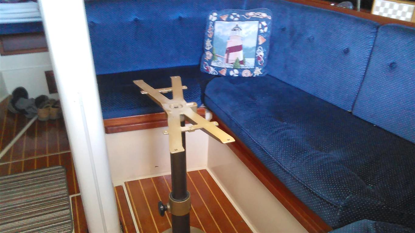

Does it look like this?
This is with the table off. To use it, I've found I have to push down EXACTLY in the middle. Never had any issue of it popping back up with a little persuasion, also in the middle.
I'm not sure these have blocks, but rather are spring loaded.

Dave the strut inside these columns is held in the center of the column by a thin plastic piece that breaks easily as they age. If this plastic is broken it will be almost impossible to collapse the table for making into a bed. As @Stu Jackson said you need to push in the center. Mine is broken this way, when I get a 3D printer I’m going to print a replacement.
