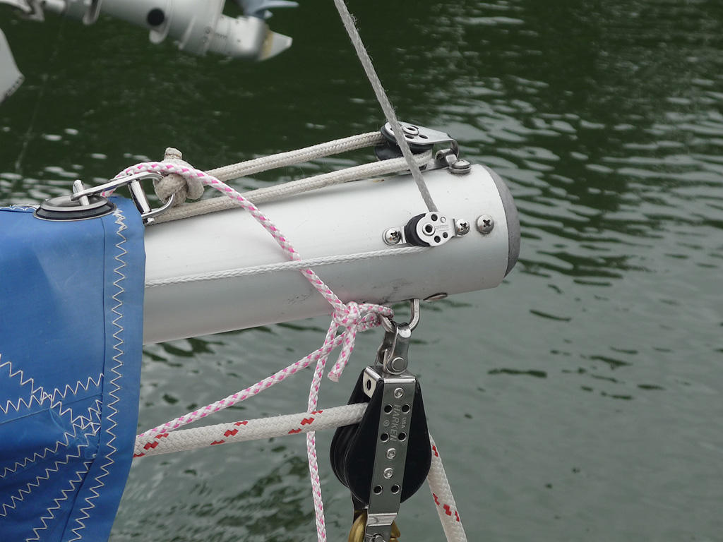

I had the same issue with my Capri 16.5. I put in a topping lift and used that to hold the boom up. Worked great.
Amsteel type line, runs through the cheek block and forward to a small cleat.
It worked good.

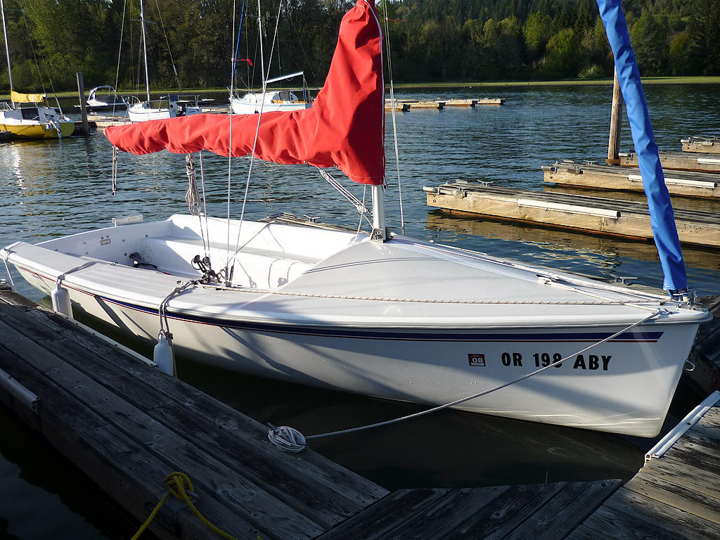

With the Capri 22 I've got a boomkicker instead, which is good because I've got an outhaul and 2 reefing lines on the boom already.
