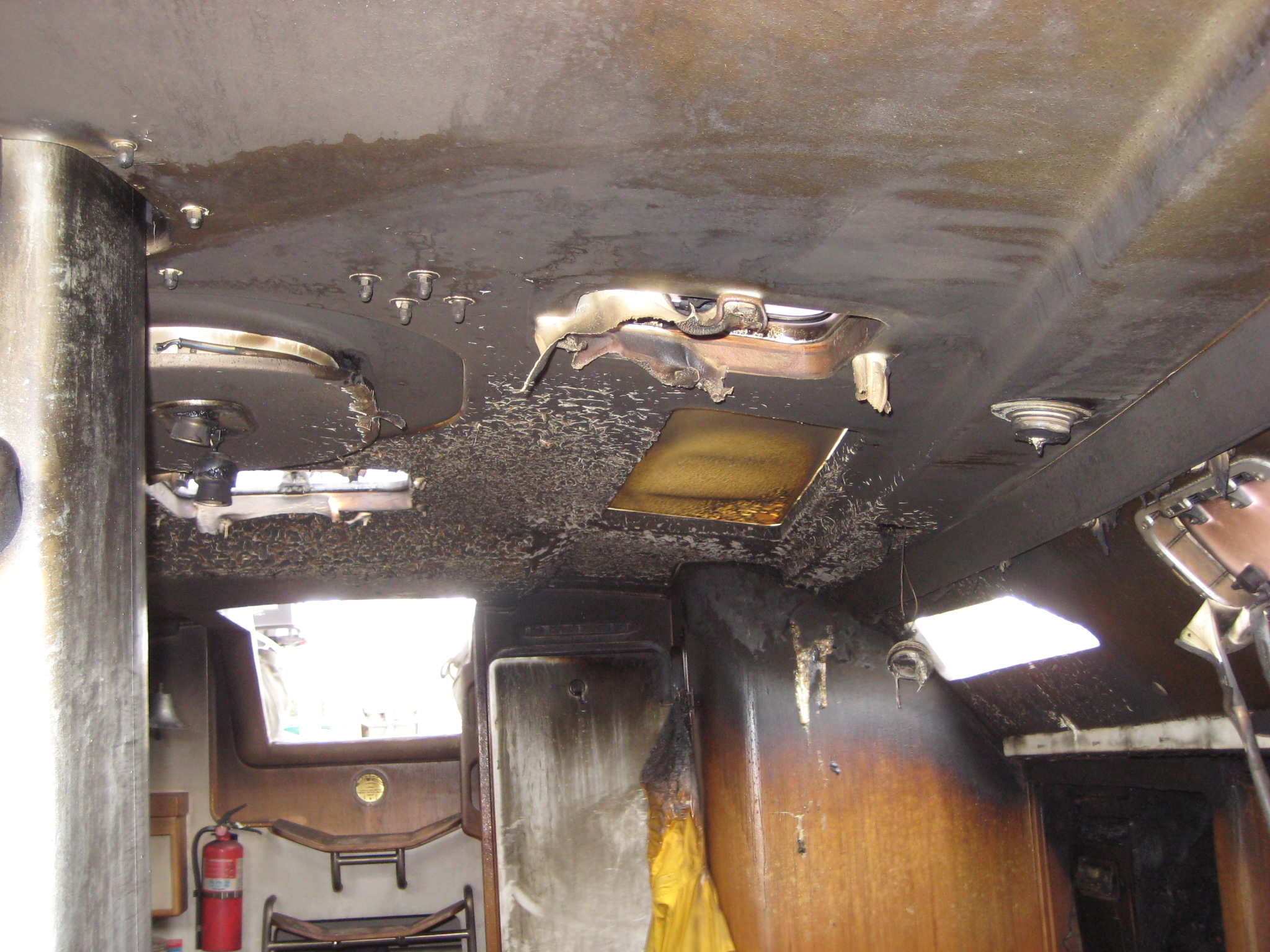

Took a look at the boat today. No odors to speak of but the cushions inside and out are done. Sails have been stored under a crappy tarp for two years so who knows. The mast was laid on it's side in such a way that the ends were unsupported and it seemed to have a pronounced bend at this point. Maybe flipping it over can fix that over time. The biggest problem was the way it was supported on a block forward of the prop strut but just aft of the stern tube exit. Checking from inside it has lifted the layers of fiberglass and separated them leaving an obvious delamination situation. The current owner simply layered some glass over where the propeller shaft tube exits and called it good. The electrical work that was done post factory was unsatisfactory. Lots of single wires with automotive/home depot type connections which explains the fire which got hot enough to delaminate the hull layers behind it. I already got an estimate to re rig (step the mast and hang the boom) of $1500 plus yard crane. That seems high to me. I'm not against doing some work to have a nice boat but the delamination and the 'quick' fix bothers me. Anyway, I'm going to get a copy of the insurance adjusters report and keep moving at least for now.

I know this is a older thread but I thought I could save some people who were intreasted in the boat some time and alot of head ache. We are looking for a catalina 400 and the boat mentioned above was on our vacation route so we stopped by to look at it. NOW here is the full story on this boat hull number 6. I talked to the pervious owner he said the boat had a nav station fire and was written off . Before he bought the boat second hand it was grounded hard and was taken back to catalina and keel was repaired by them. He bought it from catalina sailed it until the nav fire. Boat was then put on hard by I'm assuming the cheapest boat movers in town. They did not know how to block it and use a semi trailer that's half assed for boat moving. We looked at it on a rainy day and every hatch was leaking. But what concerned me more was the keel area has cracking and the prop tube that was cracked and fiber glassed over. Then there's a stringer on the port side under aft bed that is popped off from the hull due to improper supporting. We figured even if we bought the boat for 30,000 If we put in 50,000 it would maybe be on par with some of the others that are being sold for around 90,000.
