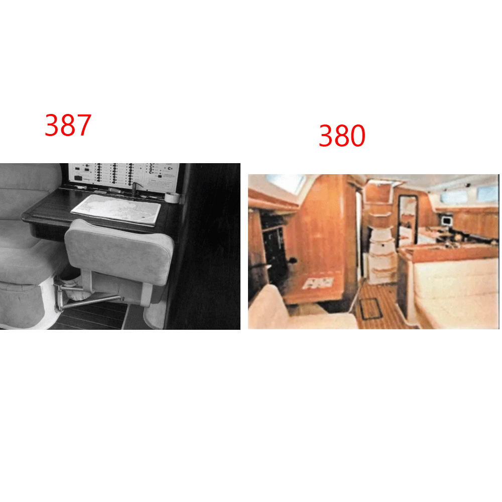

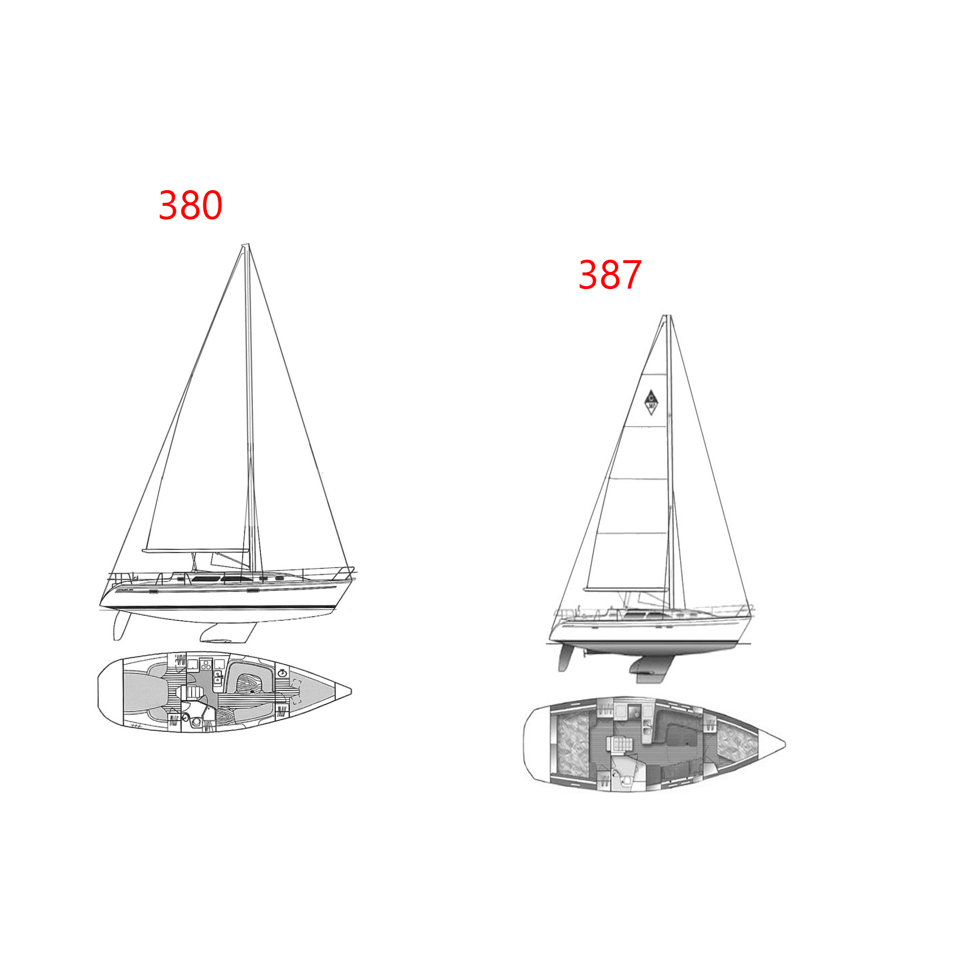

I copied both layout of 380 and 387 into Photoshop.
Like you said the 387 beam is larger. More space. The settees/matresses on 387 are more square, while the 380 curves towards the bow.
Also the navigation chair on the 380 wasn't replicated on the 387.
