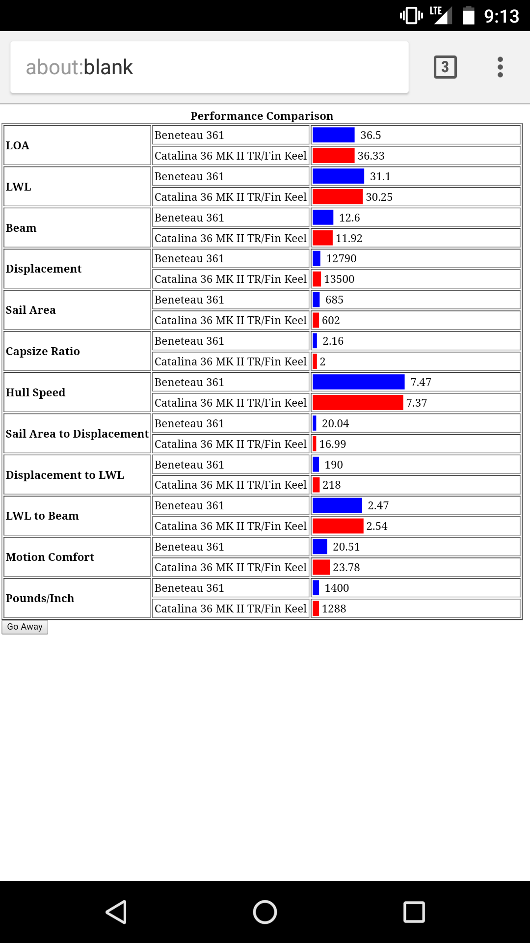

You can see on the comparison I attached there isn't much difference by the numbers.
Build quality is similar but I personally feel that Catalinas have the edge. I like lead keels better than cast iron. Benny's have adequate rigging and hardware but Catalinas are slightly oversized.
Get on both boats and see which one really does it for you.
